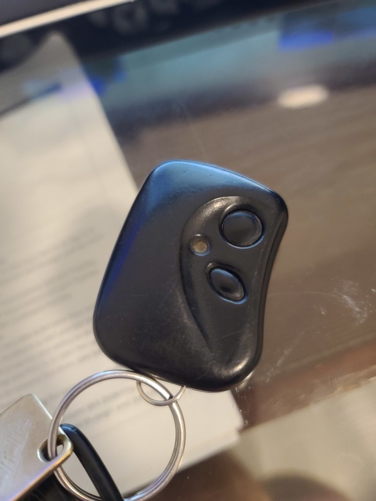

    Actually, I think it's just a remote start system. Though it does start honking like crazy if I open the door with just the key after locking it with the fob. But I guess all cars do that.20250426_192316.jpg

    Never heard of any RS3000/RS3200 systems doing that nor on my 04 DC LTD with a factory installed Theft Deterrent system.
    Google photo says it's a Chamberlain JLFTX3 remote start and keyless entry.
    Is FCC ID JLFTX3 stamped on the back at bottom ?
    Since you've only been here a short time and only few posts to find out, how long have you had this truck ?
    Do you know if your 01 even came with keyless entry ?

    Yes, it is the JLFTX3. I've had the truck for about a year. I'm not sure if it came with keyless entry. I figured it was after-market because it's not the Toyota brand fob that I've seen while trying to research replacements. (It doesn't work very well.)

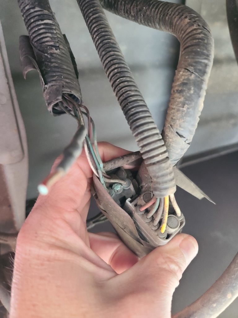

    Yeah so replacing the sockets with OEM ones didn't do anything, like I figured. Worth a try. But I just noticed someone. My truck has a towing wiring harness and one of the wires is corroded off. Could this effect the tail lights and fogs?

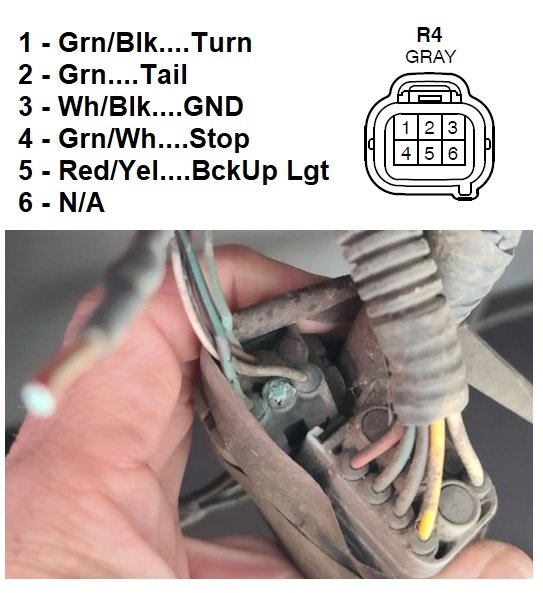

    Given it appears to be next to the T 6 trailer connector, I'm thinking that is your R 4 Rear Combo Light connector. If the bad terminal and other terminals listed below match color wise, that is terminal 2 that has seen better days and is indeed for Tail light. As for it affecting your Fog lights, off hand I don't see how.
    On the fog light subject, do you have DRL and have you made any checks on fog lights ?
