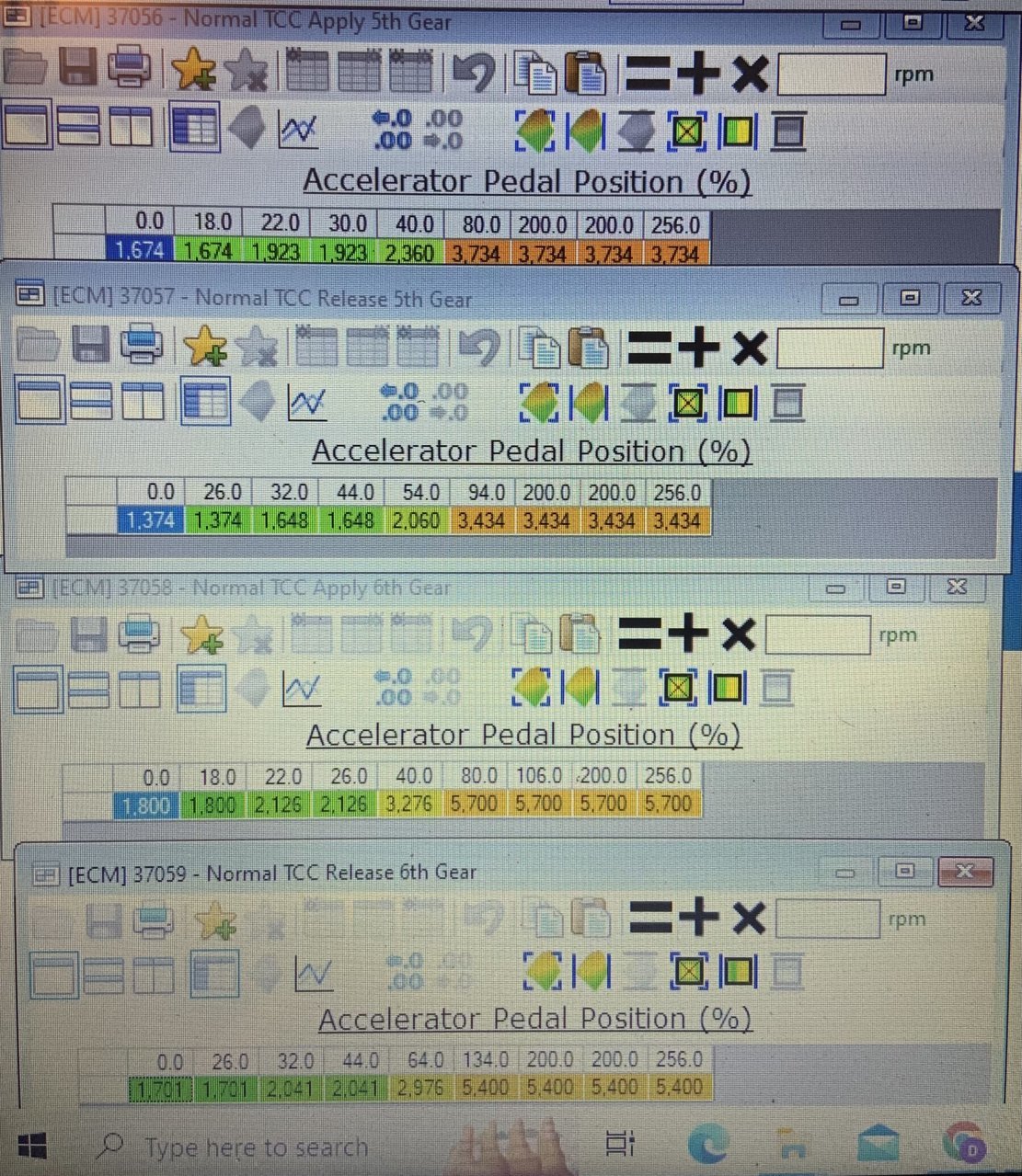

  7. Feb 25, 2023 at 12:06 PM
    #157
    Wynnded
    Wynnded What MPG...
    #379
    5,693
    Rockies
    Souped up truck
    My values have been set at 1500/1000 apply/release by Viktor. Did you change these afterward to fine tune for your preference, or may have there been a reason they were set differently due to your non-stock tire size and regear (speculating)? My tires/ratio are/is factory. I was considering tinkering with mine as in particular locations, mine feels like it's lugging and I'm inclined to want to manually downshift. It's either that or romp on it to prompt a downshift, and with all the off-camber round-a-bouts here, that could profoundly alter my trajectory in a very negative fashion. :eek::rofl:
  8. Feb 25, 2023 at 12:53 PM
    #158
    centex
    centex New Member
    Nov 27, 2022
    #87464
    2,183
    I run 4th gear lock up at like 1650-1700 (not looking at it at the moment) because 1500 was too sluggish. Maybe once I gear to 5.29 it won’t be so bad but with 4.30’s and 34’s it’s too low.

  10. Feb 25, 2023 at 3:08 PM
    #160
    centex
    centex New Member
    Nov 27, 2022
    #87464
    2,183
    Locking the converter at to low of an rpm can cause lugging and potentially damage the lock up clutch as the pump doesn’t have enough pressure built up to keep it from slipping. A lot of folks also don’t like the feeling of a lugging engine and these trucks have to be tuned for the 99% of people that buy them, not the 1% like us.
    Mine has no problem dropping to 3rd when I go full throttle on the highway as the downshift and lock up parameters aren’t affected by engaging the lock up clutch in different gears. You can make it change that if you want to though.
    snivilous and Silver17 like this.
  11. Feb 25, 2023 at 3:45 PM
    #161
    Wynnded
    Wynnded What MPG...
    #379
    5,693
    Rockies
    Souped up truck
    I meant to @snivilous but it appears that I forgot! After posting I figured that I'd just make the changes as I was going out for some logging anyway.
    I agree. 1800 is nice so far, specifically at that funny spot that I frequent by the local post office. Other terrain doesn't seem to be negatively affected. It's just this funny compression section where on the downhill, it was shifting into 5th at 35mph and locking up. After hitting the point of lowest elevation, you'd need to climb a decent grade that was just long enough that it lugs and drops speed. In order to prevent that before, you'd need to get into it quite a bit to prompt a downshift, then you'd have to stand on the brakes for the intersection. Set to 1800, it doesn't lock and allows just enough additional revs to keep it from feeling like it's struggling and maintains speed with less throttle input.
    Have you changed yours at all? Try 1800/1500 (lock/release), and if it's too slippery, split the difference from what it was before.
    After eons of driving manuals, I seem to be pretty sensitive to lugging. :angrygirl: Downshifting while in Drive was unchanged for me as well.

  15. Feb 25, 2023 at 8:58 PM
    #165
    centex
    centex New Member
    Nov 27, 2022
    #87464
    2,183
    Those numbers are transmission output shaft speed and not engine rpm. If you want it to engage converter lock up then drop it down to 1700 or so. Ignore the throttle percentage part. Just make it the same all the way through.
    Silver17 and Wynnded like this.
  16. Feb 26, 2023 at 5:53 AM
    #166
    Silver17
    Oct 3, 2021
    #68847
    3,737
    Eastern PA
    2017 TRD 4x4 Harrop SC
    Ooook, that makes sense. I may change them and see what happens. I may start with a less aggressive numbers, maybe set every number that is above 2300 lockup to 2300 and leave the lower ones alone and observe the differences. Sorry for the questions, I just hate changing things without understanding the concepts of how they work!
  17. Feb 26, 2023 at 6:08 AM
    #167
    centex
    centex New Member
    Nov 27, 2022
    #87464
    2,183
    Small changes at a time. I usually adjust things by 5% or so unless I know what I’m doing.
    Silver17 likes this.

  19. Feb 26, 2023 at 6:50 AM
    #169
    Wynnded
    Wynnded What MPG...
    #379
    5,693
    Rockies
    Souped up truck
    I started to look into this this morning and my software looks different from what you're showing. Mine doesn't indicate "Injector Duty Cycle" when I search for it.
    My VCM Scanner is version 5.0.4. Maybe you downloaded the Beta?

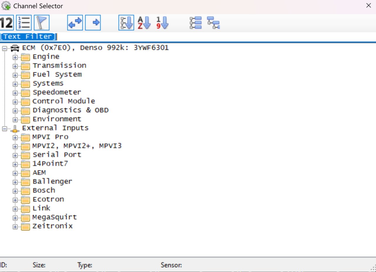

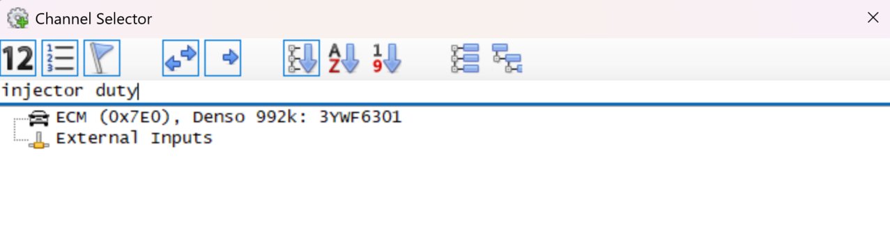

  21. Feb 26, 2023 at 7:47 AM
    #171
    snivilous
    snivilous snivspeedshop.com
    Apr 16, 2019
    #29192
    4,985
    SW UT
    300k+ Supercharged 2008
    It looks like you're searching for a channel. This only applies to the line graphs and the cell layout area. You don't monitor injector duty cycle with the different channels (sensors) since its a calculation, not a sensor.

  28. Feb 26, 2023 at 9:57 AM
    #178
    ryanallaire
    ryanallaire New Member
    May 15, 2021
    #63105
    66
    Ryan
    2010 CM 5.7
    3" RC leveling kit, S&B intake, custom DIY exhaust, tuned for 91 octane, morimoto headlights, all LED interior lighting.
    The output shaft speed are in the colored boxes, it looks like your app % has been changed from stock.
    snivilous and Silver17[QUOTED] like this.

  30. Feb 26, 2023 at 11:27 AM
    #180
    Silver17
    Oct 3, 2021
    #68847
    3,737
    Eastern PA
    I compared it to my stock file and everything is the same. I can make it highlight the changes between the files and literally nothing was done in the trans tuning.
