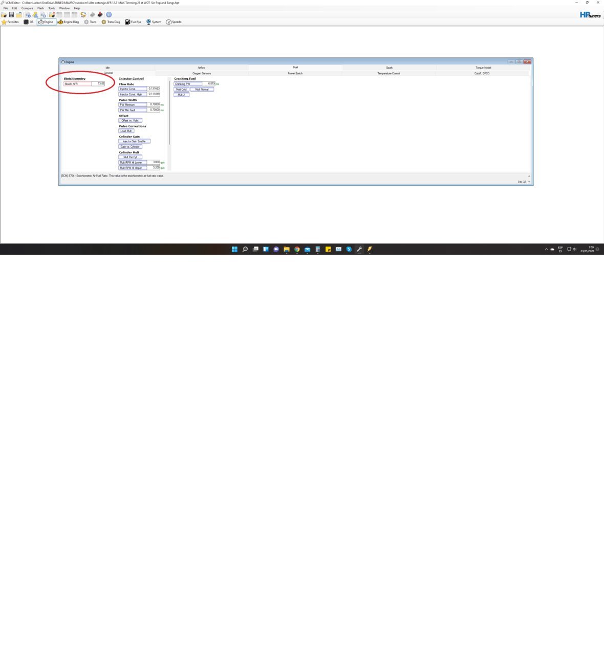

    Guys can anyone help me out. i see in my vcm scanner that my target afr is 12.2 but i want to go richer because im blending 10% methanol with my fuel. So i assume i must target a richer afr like 12.0. With 100% gasoline i like 12.5-12.7 so to compensate for the 10% of methanol i want to go a little richer at wot. Do you know where exactly is my target afr or lambda on the hptuner software with the tundra file? .. I have this tune that i paid for to a local tuner (and that is why my target afr at wot is 12.2). But i want to start learning how to adjust my tune myself. Any help will be much appretiated.

    Read this thread on the hptuners forum, I started the same process as earlier this year and the last page has some of my questions and answers which are similar to yours, I'd read the whole thread though: https://forum.hptuners.com/showthread.php?81934-Toyota-Repository/page7
    To answer your question directly though (and I'm no expert, so take what I say with a grain of salt) you want to modify your power enrichment (PE) EQ ratio. This is the multiplier (or divider if you will) that modifies the stoichiometric ratio after a certain throttle range. It's found under Engine -> Fuel -> Power Enrich -> EQ Ratio:
    The stoichiometric ratio is funder under Fuel -> General and the default value is 14.60 which is supposed to be what the truck targets during normal driving.
    If you do not have an external/stand alone AFR gauge though, you will need to get that. I forget how rich the stock ones can read, I think it might be 12.2 like you're seeing. The truck (and subsequently the tune) can only read within a certain range, so even though it says 12.2 if that is the floor the sensor can read to, the truck may actually be dumping more fuel and it just can't tell. When you're running richer values, the truck is effectively blindly dumping fuel and you need an external sensor to know what it's doing and adjust the tune to dial it in since the data that VCM or the OBD2 is putting out is limited.
    For instance, my original TRD tune would run in the 9:1 range at WOT but the truck as far as it was concerned was running at like 12:1 even though it was dumping WAY more fuel in than that. So if you don't have an AFR gauge, install one of those before tweaking with the tune otherwise you won't know what's really happening.

    Thank you for your response, in deed i see its the PE tables. I see now why my tune targets for 12.23 its because its 1,201 from 4k to 6k rpms. However, i was thinking, what if instead of changing power enrichment tables i just change my Stoich ratio from 14.7 to 13.88 . Will that make my target afr read richer right? or am i mistaken? im talking about adjusting this. But i certainly don't know if this value on the tune actually has an effect on things or it is just a marker. What do you think ? that way with my current PE and MAF table adjustments mixture will be richer by just changing the global stoichiometry of the mixture.

    Changing the general stoich should make it richer across the board, including at idle and cruise and everywhere. If you're blending methanol in so your fuel is always modified, seems logical to me to change that value.
    On the plus side since you're richening it out there's less chance to screw anything up. Try changing it to like 14.5 or lower and see what happens. The stock setting is 14.6 but all my gauges say 14.7 or that the truck is targeting 14.69 so I don't know if that's "close enough to 14.6" or if there's other modifiers happening. I would sneak up and see how much change in that setting is actually reflected in reality.

    I changed the general stoich but it "seems" like it affected nothing. i changed it to 13.88 and my mixture is still the same as before. I have to then add more fuel in the PE tables and maybe increase the values on the maf table to pull more fuel ?. BTw there is something bothering me is that i did some pulls today with 100% pump gas and i heard the truck pinging. So i added 5 liters of methanol to 95 liters of pump gas. However i would like to see in the log where exactly im detonating, but cant figure out where. Do you know where or how you can see exactly into which point im getting knock retard using my log file? I open the scanner and i have the channels and everything but i can't find where is the table where i see the exact point of detonation, so i can then pull 1 or 2 degress to prevent that.

    What’s the flex apply//release table?

    Wow! Great additional info! Thanks @snivilous I also have Viktor's tune and will eventually be installing headers I have and some day a SC.
    I don't know if I'm brave enough to mess with my tune myself though.

    Correct. The converter tables appear to be engine rpm, even though the description calls it output rpm (same verbiage used for the shift tables). The shift tables would make sense that it's based on actual transmission output speed (vehicle speed), and it'd make sense the converter is based on engine rpm since it's coupled to it. Plus the shift tables have values well over the engine rpm capability, and the converter tables at most are near redline.
    I have no idea what the flex apply/release does. Maybe it adjusts the lockup table depending on TPS? Considering it only has values in stock form for 20% throttle and below, maybe it's purely for initial acceleration. I've never messed with it though.

    That's what I thought. My plan is to play in the cruising and coast tables and at 0% throttle I want the converter to be released entirely below 2500 or something like that. Let the engine freewheel. Not for tow/haul, just regular. See if that does anything with mileage as some folks seem to think it might. I dunno. Lock up I'm probably going to mimic what you did and drop it lower in the RPM. I don't want it to low because it'll lug the engine and that's the opposite of what I'm trying to do.
    Been playing with throttle angle to be somewhere between tow/haul (to sensitive) and stock (to dead). I was really surprised to see the normal throttle having really different numbers between each gears where as tow/haul was the same values all the way across through all gears. I'm debating changing the scaling on the normal to match the tow/haul as the tow/haul comes in quicker on the top end than the regular.
    I've bumped spark up about 5% in the cruising range and added a degree from 4800-6000. Part throttle spark is where you can gain some mileage so I want to focus on that. Was going to try and do some logging but roads are wet so meh.
    Looking at this file compared to my durango and it's stupid simple comparatively.
    One thing I'm highly annoyed with and I don't know if it's this file or if my VCM updated on it's own but I can't write anything without being connected to the internet. Absolutely infuriating.

    That's how it's been for me too. Need to have internet and the mpvi plugged in to even open the software, and then usually have to hotspot on my phone just to go out and flash the truck. Super annoying.
