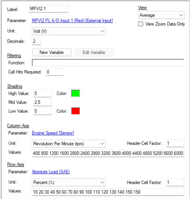

    I wired in the Prolink+ to send my PSB-1 AFRs to show in VCM Scanner Chart vs. Time display. Of course I seem to like graphs too. So I tried making up one of those, unsuccessfully. For C vs. T, there is the option for the data to be rendered in AFR Ratio which is of course what I've done. Trying to set up a graph, the only option is to have the data rendered in V, which is fine as color shading can be utilized to give a quick visual reference of rich vs. lean. But....nothing shows in the graph so obviously I have it wrong. So....has anyone else tried constructing a graph for AFRs?
    Here's what I have:

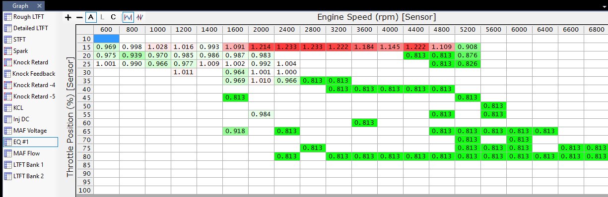

    I don't know what you're saying with all your letters, but this is what I do with the stock narrowbands just to get a quick lay of the land that it's richening out when I want.
    upload_2024-4-23_11-5-9.png'

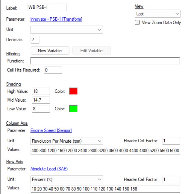

    Ya, I don't know what I'm saying when I don't know what I'm saying. Can become a word salad, and salad is worthless.
    HA! I got it this time! :dancingbacon:
