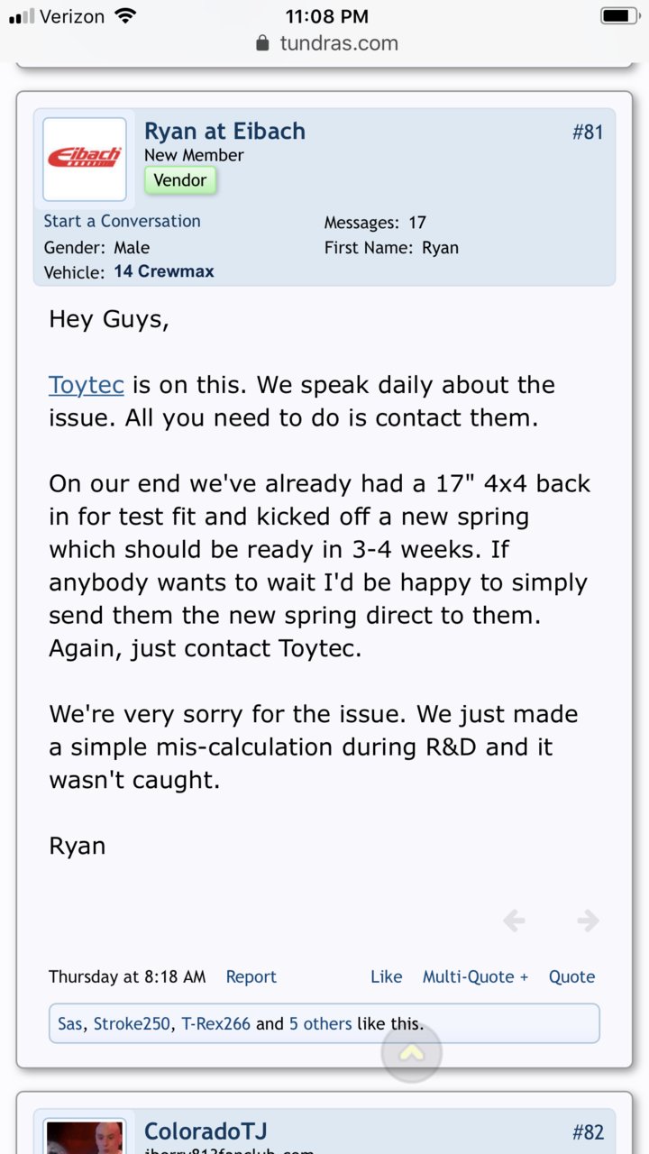

    Hey, welcome. So I’ve been doing a lot of research as I plan my first Tundra build. You most likely saw a drop in lift due to the coils on the those Icon 58650 shocks. They use a 600lb Eibach spring which people have been having problems getting advertised lift with. Same with the Toytec/Eibach Kit, which Toytec and Eibach have acknowledged on this forum quickly and openly. Refreshing to see. Links below outlining the same issue.
    Users are reporting much less than advertised lifts with those Icon shocks and without getting the 700lb spring upgrade.
    https://www.tundras.com/threads/icon-58650’s.38315/
    https://www.tundras.com/threads/icon-rxt-rear-suspension-system.44408/
    https://www.tundras.com/threads/toytec-customer-service-negative.45658/page-3#post-1192478
    https://www.tundras.com/threads/attention-recent-eibach-coil-over-purchasers.45664/#post-1174533
    I know user @jabula_za is currently working to try and have Icon remedy the issue. At this point your best option is to mostly likely get the 700lb springs and have them put on ($$$$) or contact Icon as well. At some point they will need to acknowledge the issue when their website advertises it as a 0-3.5” lift. Given all the research I have done this has steered me from the Icons when I eventually spend thousands of dollars. Sorry man, wish I had a better answer for you!

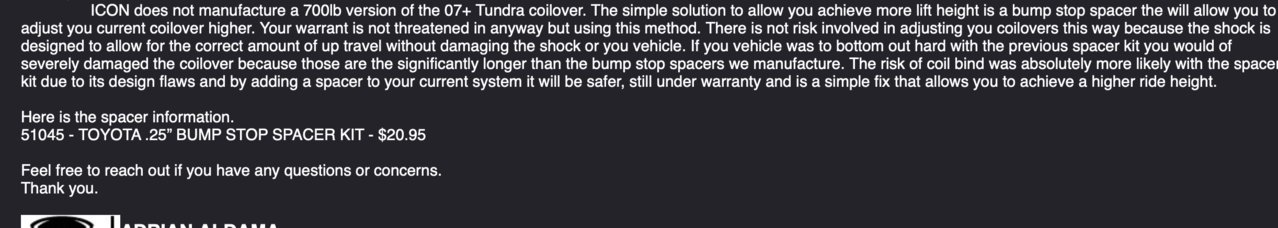

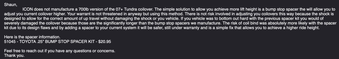

    I don't mind spending the $ to get the correct springs refitted, but so far the response from Icon has been to crank up the preload and use a bump stop spacer to prevent coil bind. Not satisfied with that suggestion as it does not resolve the problem. I love Icon's products but should i be thinking twice about ordering the Icon RXT for the rear setup? We shall see - I will give it some more time and hope that Icon is able to resolve the issue for me by replacing the springs as they have done for others on here it seems.
    For interest, here is the response from Icon:
    I have referred Icon representative to these threads to check the issues being reported as they are obviously indicative of a problem with the coils from the supplier.
    DM me if you'd like me to include you on the thread directly with Icon in attempt to get some acknowledgement and traction on resolving this issue. Same goes for anyone else having this issue, or have had this issue.

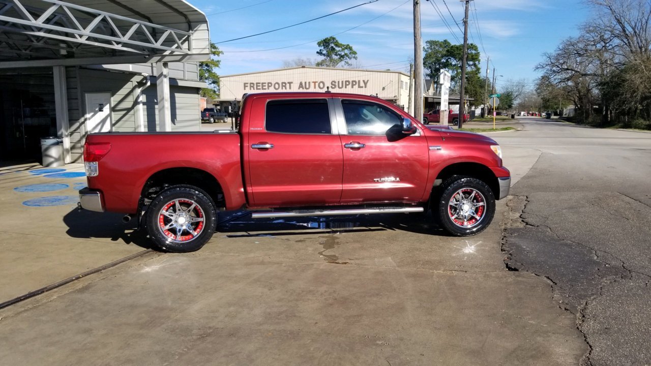

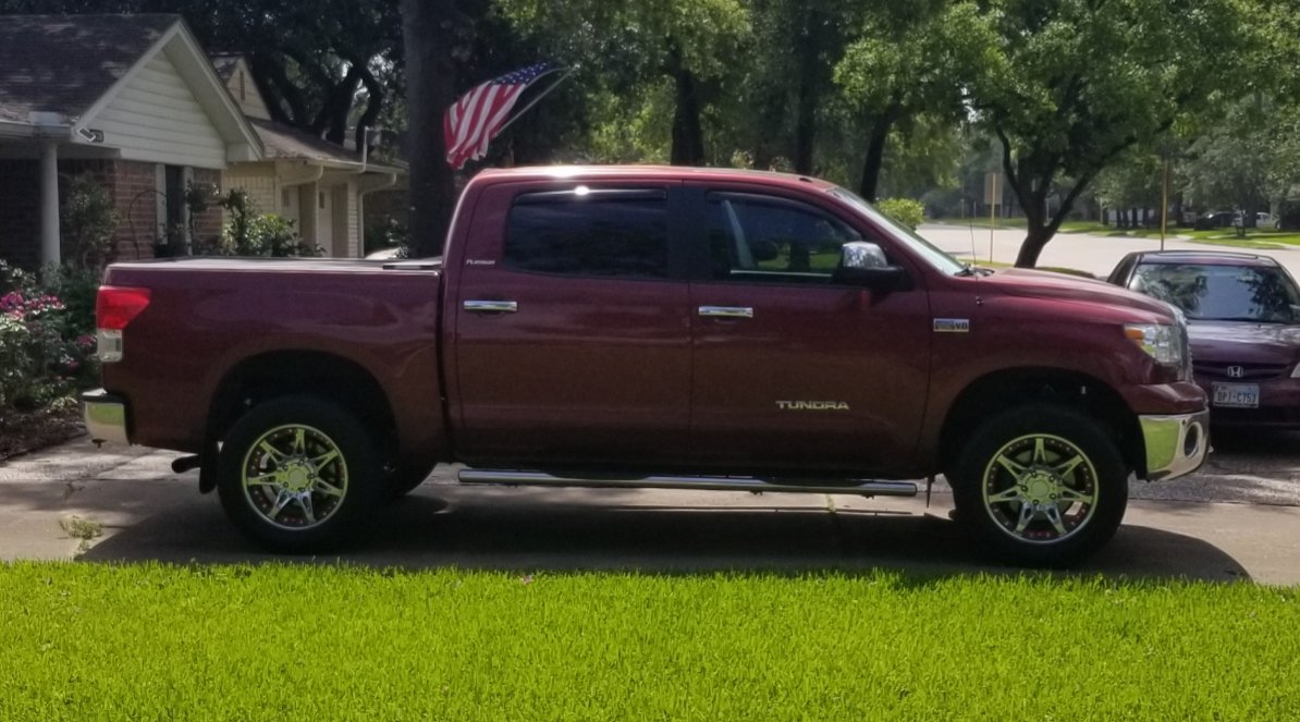

    With the icon stage 4 suspension
    With just the 3/1 leveling kit.
    The shop is offering to raise the front but says ride will be stiffer. Has anyone done this? What is the ride like? It is great right now.

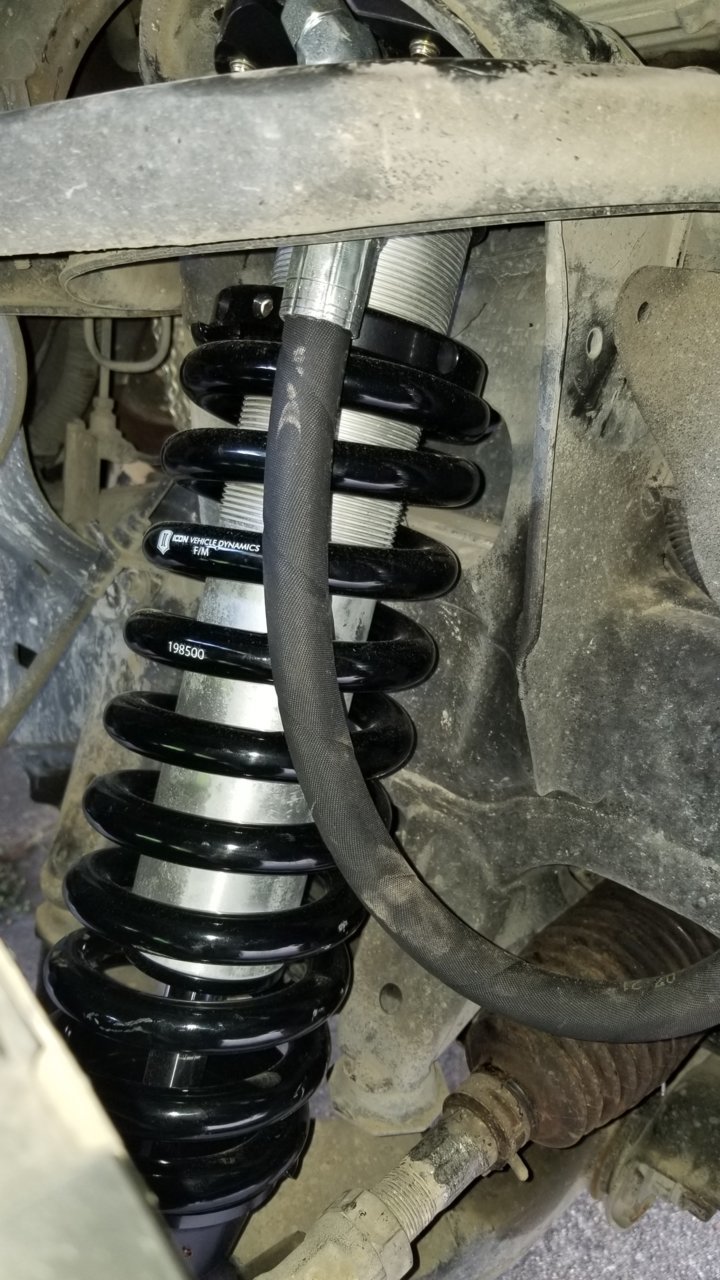

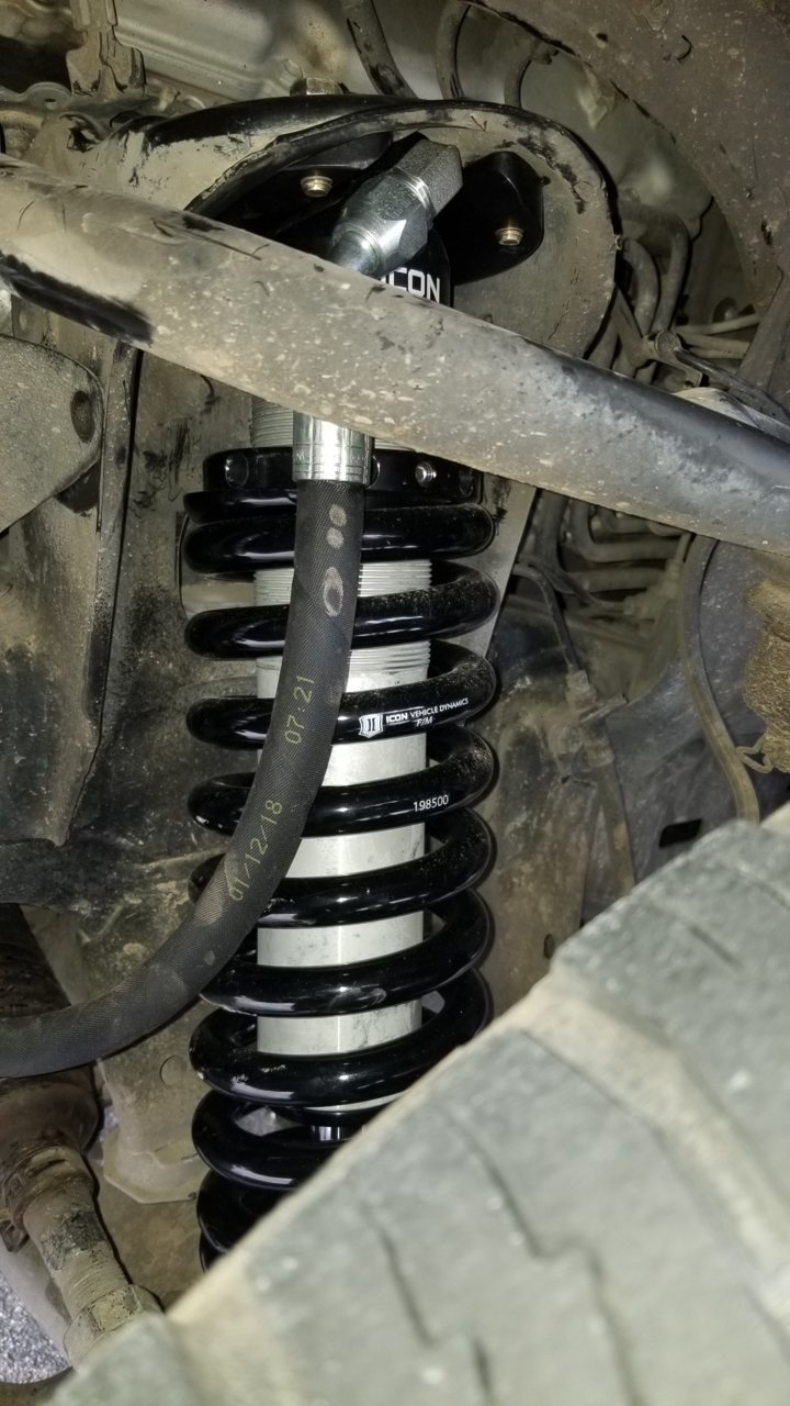

    I see a lot of thread on the icons, so everyone says they can be adjusted?
    20190522_123330.jpg 20190522_123330.jpg 20190522_123346.jpg 20190522_123330.jpg

    Yeah - don’t leave more than 2”exposed at the top because you’ll risk coil bind and void warranty. Let me know what center hub to fender measurement is after - interested.
  19. May 22, 2019 at 10:48 AM
    jabula_za
    jabula_za New Member
    Apr 30, 2019
    #29908
    59
    Shaun
    Sabre Springs, CA
    2017 Tundra SR DC 4x4
    Icon 2.5s with RR & CDCV, 17x8.5 Method MR316 with BFG AT K02 32.6x17x10.5. K&N Filter, Blacked out tailgate emblems.
    Oh, you will need the icon wrench and Allen key to adjust, and jack the truck up to relieve some preload. It gets tough when get close the the 2” mark
