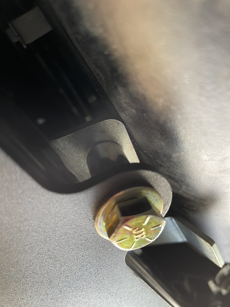

    Just got my sliders installed over the weekend. The only issue I’m having is on the passenger side, the clamp on around the middle of the gas tank (38 gal) is rubbing the tank. Curious for you guys that are running these, did you have any clearance issues around the gas tank?

    Is that the plastic skid plate or the tank itself, I did notch my plastic a little bit.

    On the actual side on the tank for mine (the silver top bracket that holds it onto the inner C channel)

    You should be fine, but you could loosen it and square it up a bit if it gives you piece of mind

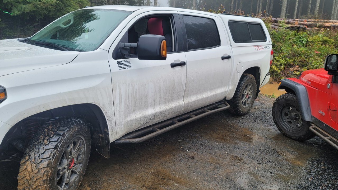

    I installed the step version on my Pro, I did have to notch the plastic tank shield, and that last bolt on the side of the tank was a bit of a pain to get in place, but should work fine with the larger tank.20210206_141341.jpg

    You'll definately have to drop the plastic tank shield to get the bolt in, then trim it in one or two places where the new hardware needs a little clearance, but it's just plastic so easy to do.
