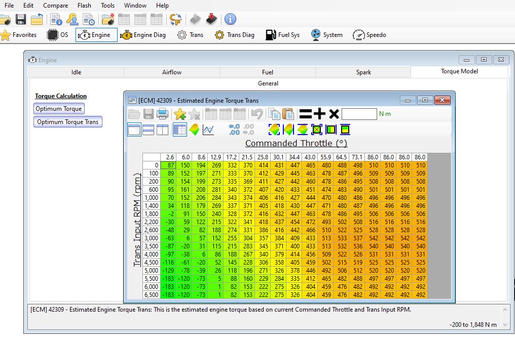

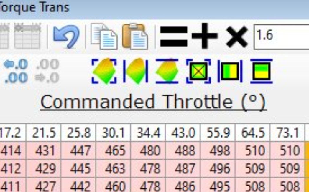

    Question for a side bar: why for are the torque values in the graph different from the stock file? I realize it is supercharged but looking at a few other tunes, these values remain unchanged from the stock values up to 400ish. Where did those numbers come from? Dyno'd? scaled up?

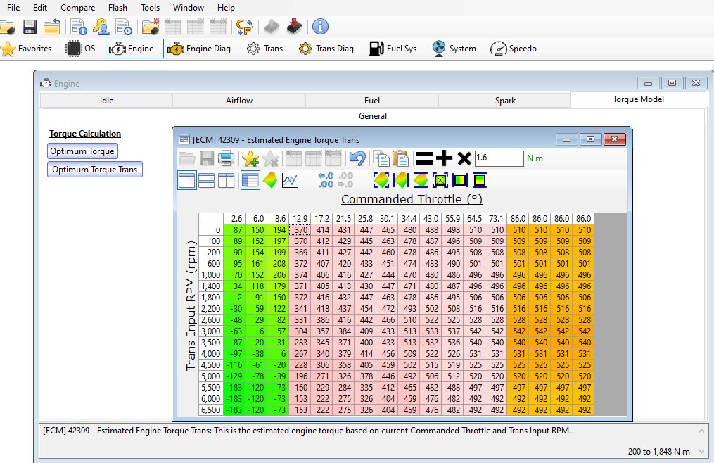

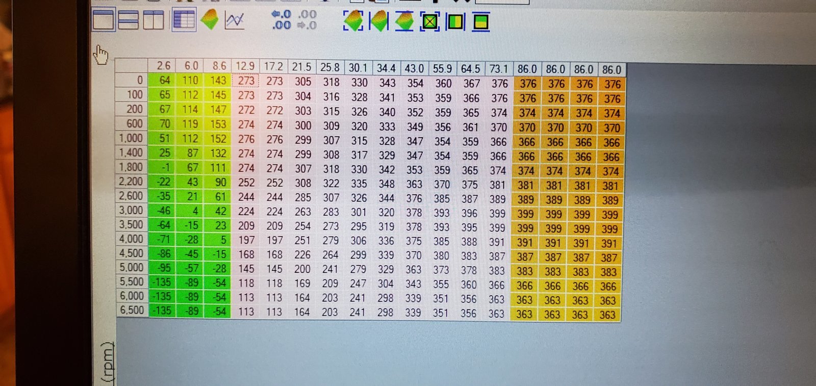

    I believe my stock trd tune had pretty high numbers. @snivilous changed changed them in my tune. But I sent my base tune in to TRP and Grant stated they were the same as @armyoffoo tune . I'm not sure if they were his base trdctune or his new one.
    My new values.
    blenton[QUOTED] likes this.

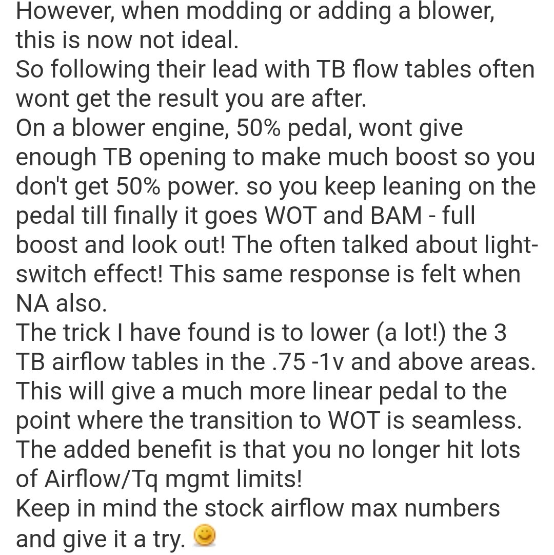

    It seems there are some tables that are scalable and others to play around with until you hit that right mojo...if I knew more I'd venture to give it a go.
    I emailed @snivilous when I had the 102mm installed and brought up the light switch or on/ off affect when giving it throttle to see where you can get part throttle drivability back.

    Edit: Those values aren't from my truck, must be scaled up...my tune file shows 399 as the highest value.

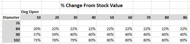

    Don't forget degrees is different than percent, so your calculation example is showing ~74deg throttle (maybe that was your intent, just seems like a random number). I think that's where @Wynnded confusion came from.

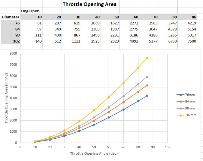

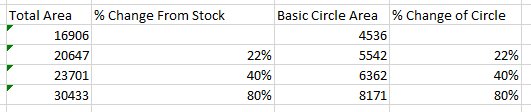

    Here is the CAD calculated values.
    Which all of that work to say it does appear to be a linear change which I didn't expect. If you sum the total areas calculated for each body size, they are the exact same difference as just multiplying the throttle body areas:
    All of that to say, in regards to opening at least, you can just straight multiply the area increase of whatever throttle body.

    Looks like it's not ENTIRELY linear, but extremely close. Extrapolating that data out one step further:
    ViktorG[OP], Mdl, armyoffoo and 2 others like this.

    The area will be linear but the flow isn't. I'll see if I dig up the holdener video explaining it.

    Oh no doubt, I would imagine airflow efficiency goes up with more throttle because you disturb the air less. Take it to the limit and your aerodynamics are horrible fully closed, and fully open it's effectively a tube with a plate in the middle so is extremely unhindered and I would imagine mostly laminar. Someone could model that in a CFD program. But I also would think the stock map would have similar efficiencies already baked into it, so scaling it based on area may not be too far off.

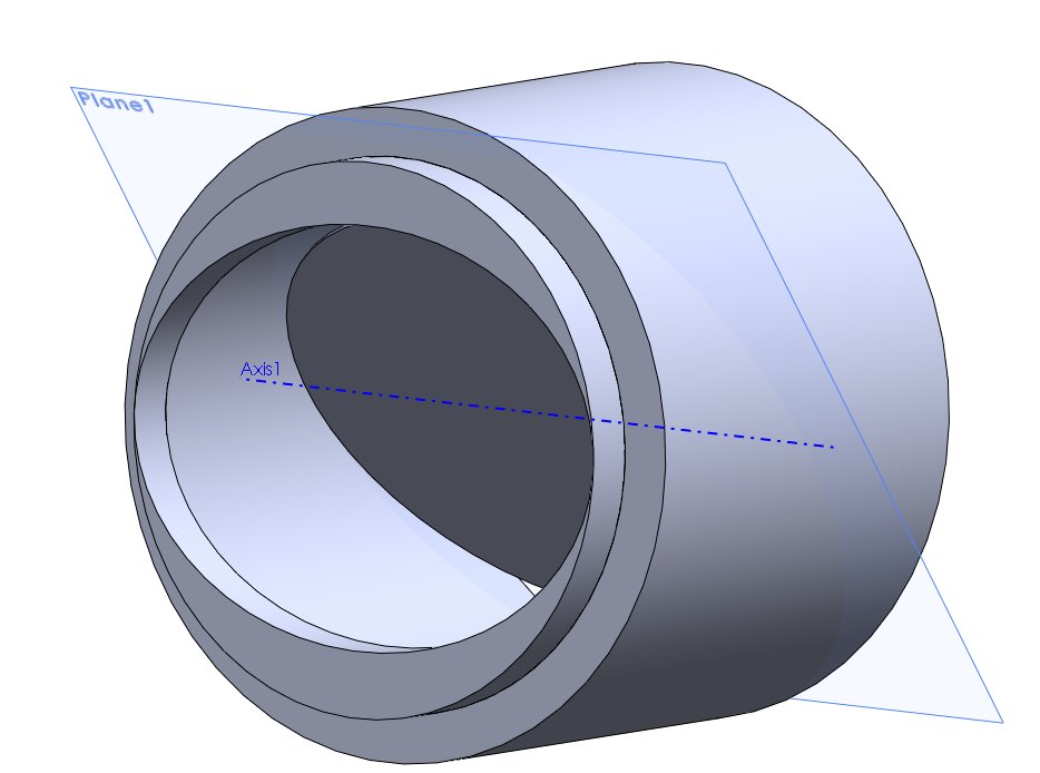

    Also here's my fleshlight looking model to calculate area. I used the throttle body ID, then drew a plate 1mm thick and 0.1mm smaller diameter, then varied the angle, then extruded the area you could "see through" the throttle body and measured that area:

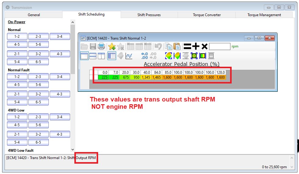

    I'm only looking to make sure shifts are on point and not hitting too hard, or hanging. I can control the hanging by letting off the throttle slightly and it'll shift. I did have one cold start P050a and hit a P0101 at part throttle, so just need some fine tuning as it were. Overall I'm very happy and wouldn't swap back to the RCF unless I had to.

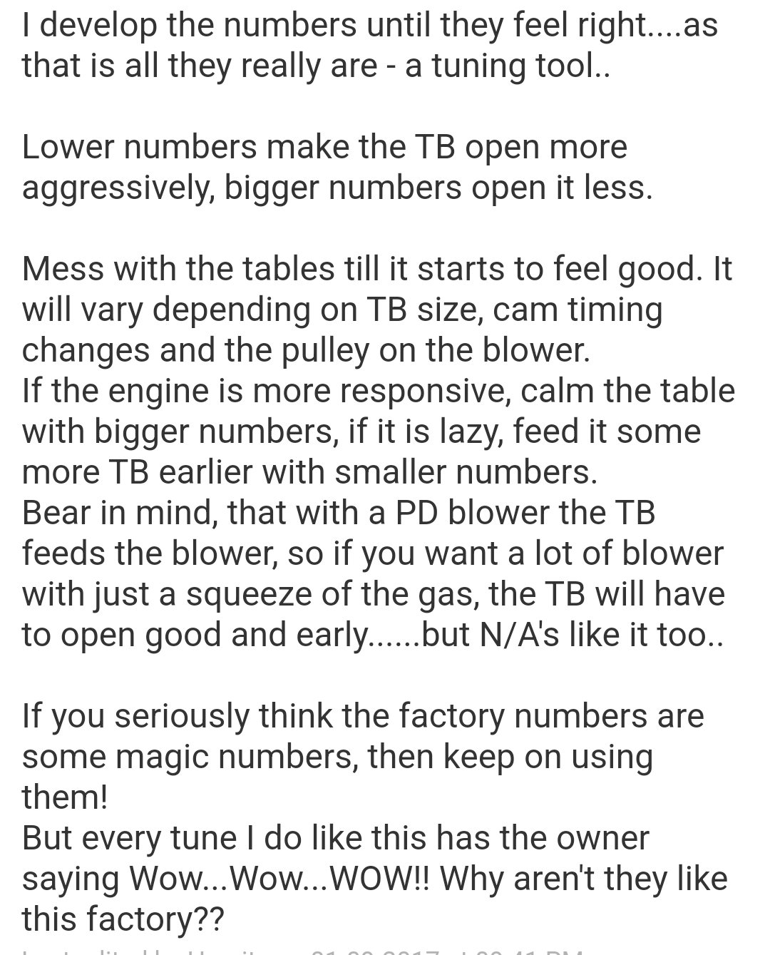

    What's interesting as I re-read @armyoffoo post concerning hellcat tuning for larger TB's. As @snivilous table shows it should be linear and be able to plug corresponding values to get part throttle response inline with Toyota parameters.
    They used the smaller TB tables, voltages, to get the larger TB's to respond for everyday driving. But that's for dodge ecu's.

    My understanding of calculating disk surface at an angle would use the equation (Pi*r^2)*cos(throttle angle).
    First part is area of a circle. Second part sets it up so TB surface is 100% at angle 0 indicating closed, 0% at angle 90 indicating open, and everything in-between as the blade sweeps it's arc.
    So at 45 degrees, or 50% throttle opening, it would be off by ~20% if you use 50% vs cos(45).
    Why? Cosine at 45 degrees is 1/sqrt(2) or 0.7071067812 (meaning ~70% surface) not .5 for 50%. A value of .5 x TB area would be the value of the blade surface at 60 degree of open throttle.
    If the above is correct, the more important question is what is the impact of a 20% error propagated through airflow calculations? :notsure: I'm still looking for a good explanation of airflow characteristics since it isn't linear and if it matters if it is boosted or not (I suspect it doesn't matter).
    You addressed TPS as a possibility of an error. If the vendor already says it is on the money the only way to test is to bench both TBs and log the inputs and output or via observation like in this test:
    https://youtu.be/LRdP9p8XEWg?si=CvW1y0nXGiX-xFmg
    I'll exit with my horse now :deadhorse: and am ready to be educated more on this subject.
    EDIT: I referenced this answer from Paul Grimshaw assuming it is correct:
    https://www.quora.com/How-can-you-c...30-degrees-off-of-facing-directly-towards-you

    No need to stop.as your on the money. And I didn't mean to come across that it's plug and play where its good to go. We were hoping it would be simple and it was suggested it is not linear and the other variables need to be addressed. I was testing the relatioship commanded throttle, throttle position, pedal position and rpm speed. There were other functions I wanted to log but hpt doesn't have them for Toyota or I picked the wrong ones.
    I haven't got into the nitty gritty the device. The main goal was just to get the Gm TB signal to respond to the Toyota signal without throwing codes.
    Our problem is in hpt we need to be able to make further adjustments for all the other vvariables. Thanks!

    I sent in my data log and will try some suggestions for shifting.
    Response: "Looks like your shift RPMs match what is in the tune that Army/Bryan sent me.
    For example, in first gear 1000 RPM output = 1000 x 3.333 = 3333 engine RPM. So at around 30% pedal it would be shifting at around 3300 engine RPM.
    If your shift tables are the same, you can reduce the values in the table if you want it to shift earlier.
    Desired Output RPM to shift = Desired Engine RPM / Gear Ratio
    If your shift times are too long/flared, you can bump up Base Line Pressure."
    I will attempt to make some changes and see where it's at.
