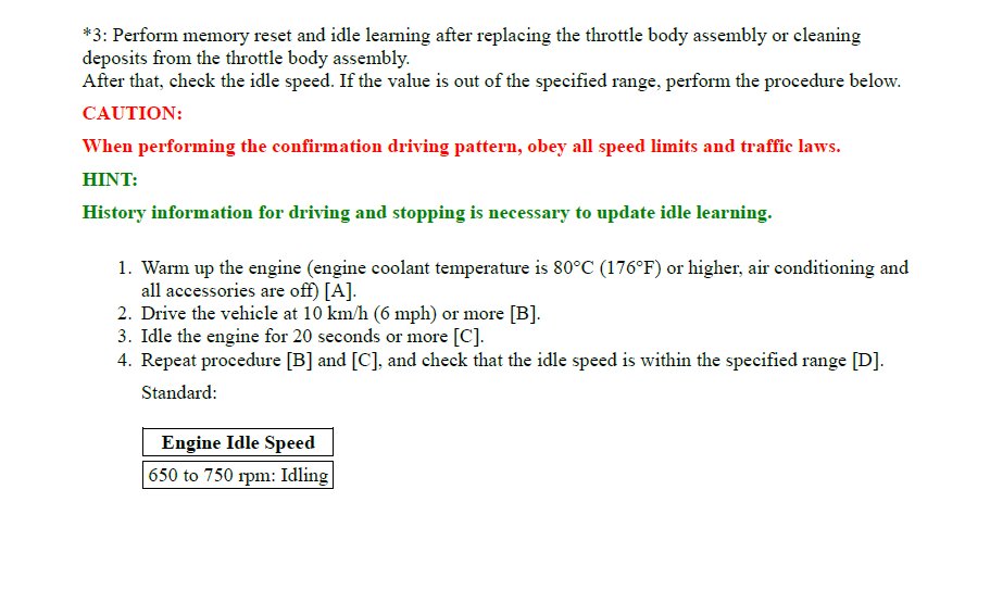

    Grant from TRP reached out asking what scanner I used to reset the learned values. I'm using the Foxwell NT510 Elite with the Toyota pack. He also suggested that anyone with HPT access to put in a request for them to include the "reset throttle body learned values" function...the more people requesting the better.
    Sucks that Techstream doesn't have a function for it...the wording in the Toyota documentation seemed to suggest it was part of the ilde learning procedure for cleaning/replacing the TB. I interpreted "Perform memory reset" as the "reset learned values" function that I found in the Foxwell.

    Snap On solus ultra or Pro. I just saw solus on the scanner. I told him most shops didn't have a decent scanner or no clue what I was talking about. He stated most of the shops around don't use the higher end scanners.
    I did the throttle reset key on pedal to floor and back 5x's key off then drove around varying throttle for 20 minutes. I was in heavy traffic but could feel it shifting better towards the end. Will keep on taking it out to smooth the 456 shifting.

    It just dawned on me you're looking for better shifting action. The Techstream option will reset learned shifting patterns at least.
