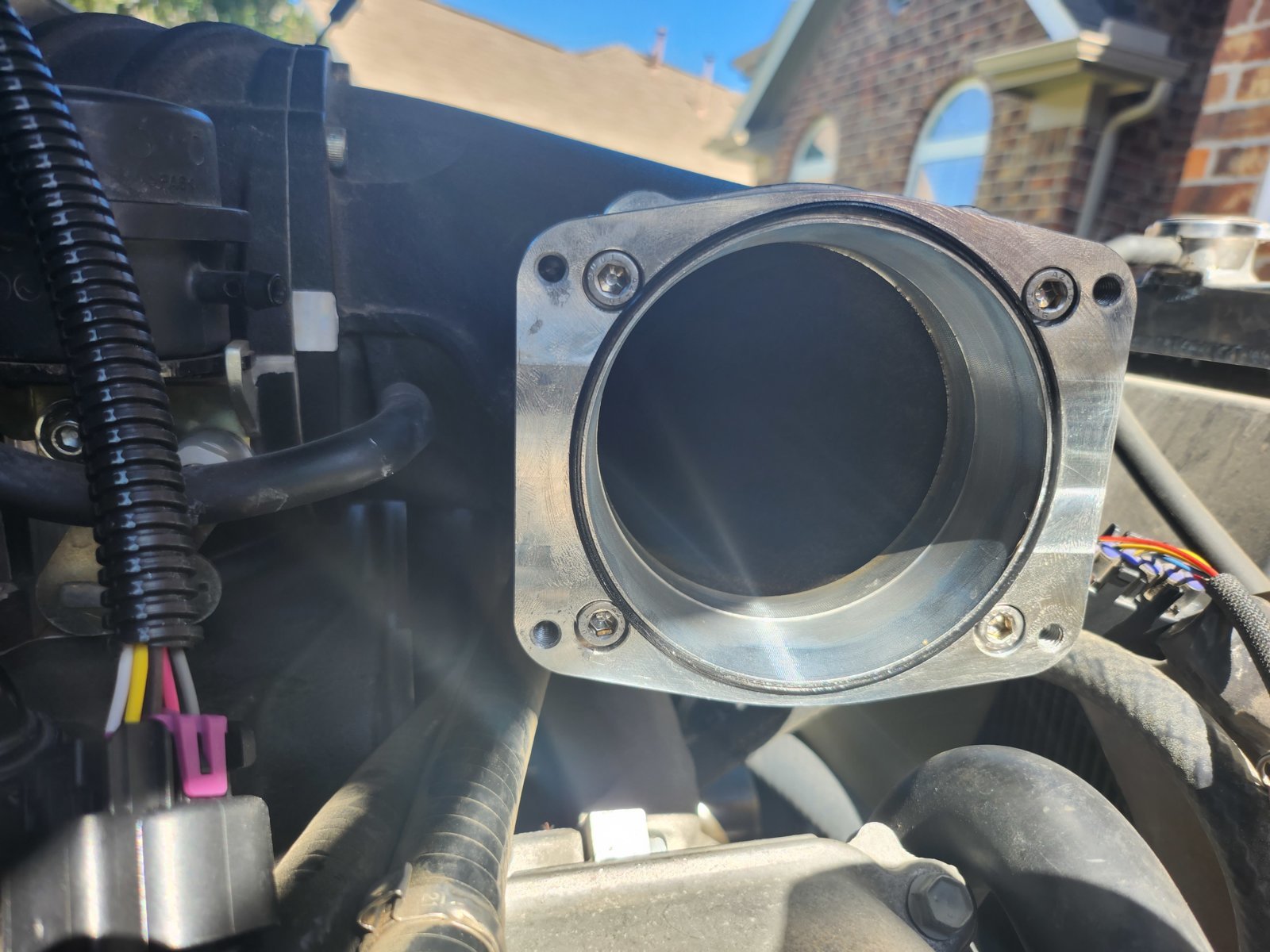

    Got @armyoffoo throttle body today, and spent a couple minutes taking it apart while I waited for the wife to come wrench on her new car.
    Was a bit of a destructive deconstruction. Had to drill out the throttle plate bolts and went ahead and ground off the cap that held the bushing for the shaft so I could press the shaft out the side. But I have all the parts here, and took pictures of the process so far. Need to look at pulling the gear off the shaft, otherwise next up is designing the new one!

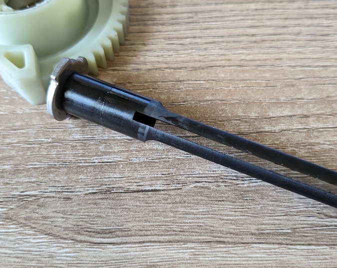

    Maybe I should make a separate thread since this thread is for GM throttle bodies.

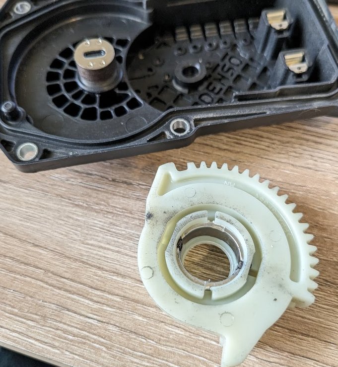

    I got the gear and shaft separated, turns out they're an integrated assembly but luckily it broke in a workable direction.
    The shaft has this toothed plate that is integrated into the gear, tapping the shaft out broke the lip of plastic that holds the plate in. Not sure how the shaft is actually retained into that plate, but doesn't really matter.
    I have two thoughts moving forward, I can either make the new shaft index into that same plate impression, or even lock into the larger cutouts in the plastic. But that would involve removing the shaft from the gear and hopefully not fracturing the gear. The other thought is to cut the shaft and use the slotted portion as a female groove that slides over a male stub that is the actual shaft.
    Kind of like a flat head screw driver and slot. The downside potentially is making the assembly wider because of this compound shaft arrangement, and the stock shaft has this fancy curve in the cut so the curved throttle plate would butt up against it which isn't really an issue but just complicates things a bit and makes it less elegant. There's also the issue if I go down that path that I'll probably need another throttle body to cut up to test the assembly without breaking the shaft free (I can glue it back together to make it a functional test unit, but you wouldn't want to run that permanently).
    And the third alternative is just design my own gear entirely. But that has complications due to how the sensor is setup.

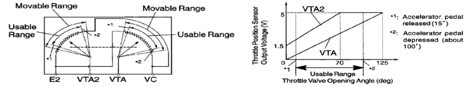

    The sensor is some magnetic based system, hall effects maybe? Regardless, there's two magnets integrated into the gear that the sensor picks up position from. There's no physical connection where a sensor gets spun to determine throttle position. This makes me lean towards cutting the shaft because that's the least intrusive method, the gear remains entirely intact and someone could do that at home with a cut off wheel, and then I'm not reverse engineering where the magnets go and how big they are etc etc.
    With all that said, I've moved onto the design process. And these are some insanely complicated little parts. The sensor body for example doesn't even have a consistent bolt pattern which makes it very time consuming measuring all the dimensions. I also haven't entirely figured out how (assuming it's needed) to space the motor away from the sensor without compromising the sensor body.
    Now to go work a job that actually pays and screw with this more tonight :D

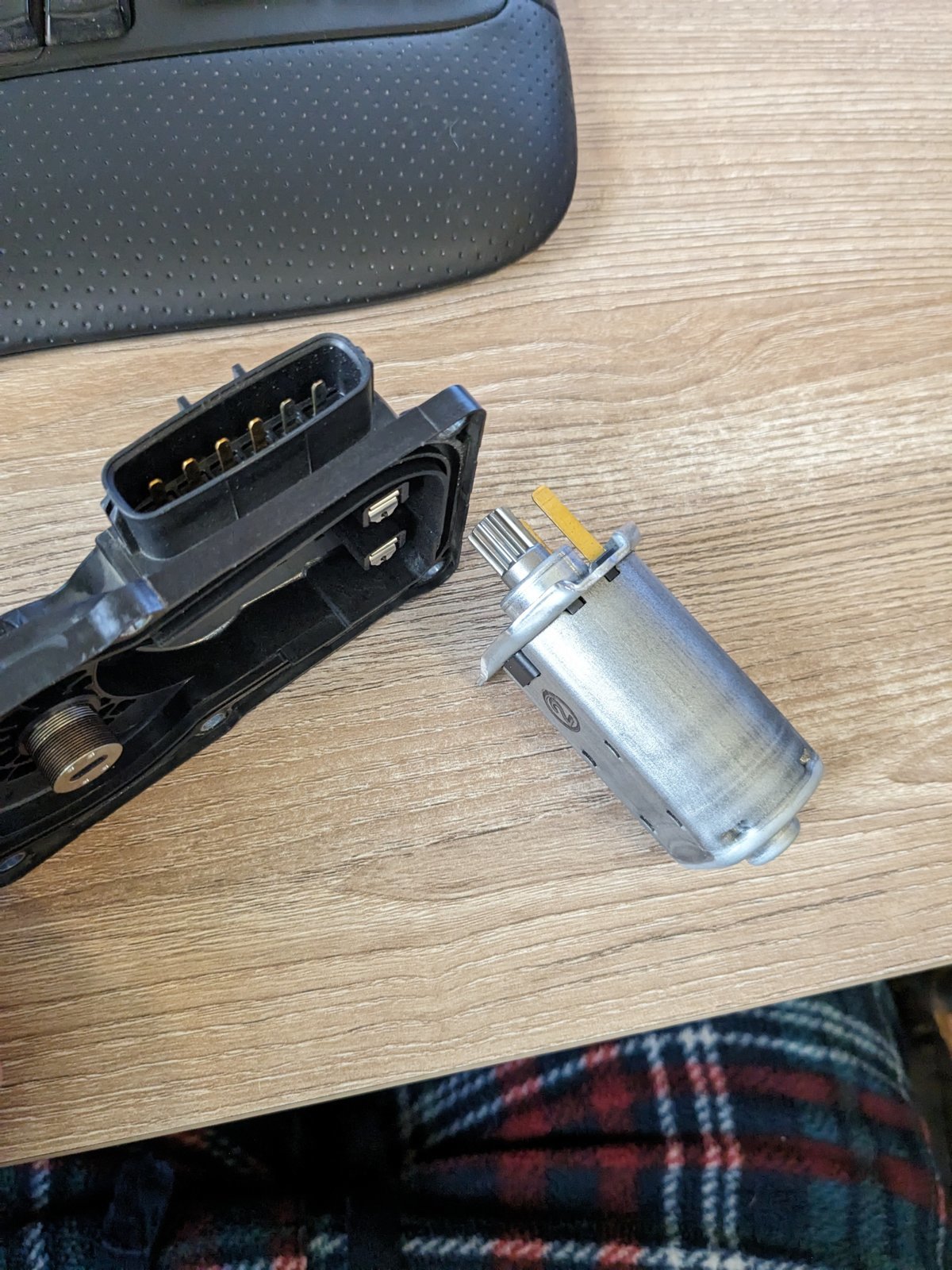

    Actually I may have just figured it out. The motor plugs directly into the sensor body, unless I moved the motor down and over, and then wire some leads between the two. This would push the sensor body away from the throttle body, but with the compound shaft setup I described that's happening anyway. If the motor is like this, and using the compound shaft, and then add another idler gear or replace the stock one, that results in the motor being spaced out and just trimming the stock shaft to length. That might work nicely....

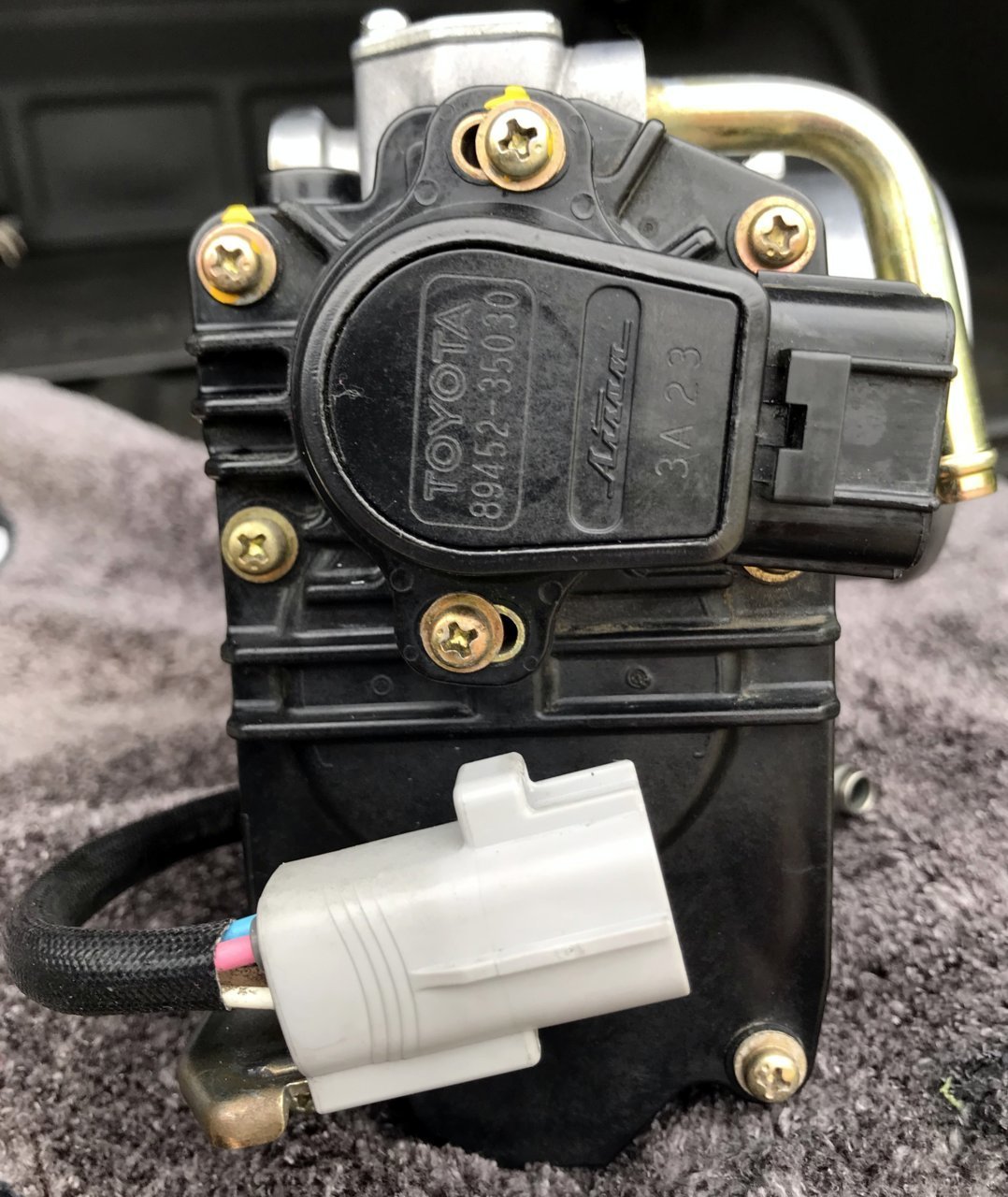

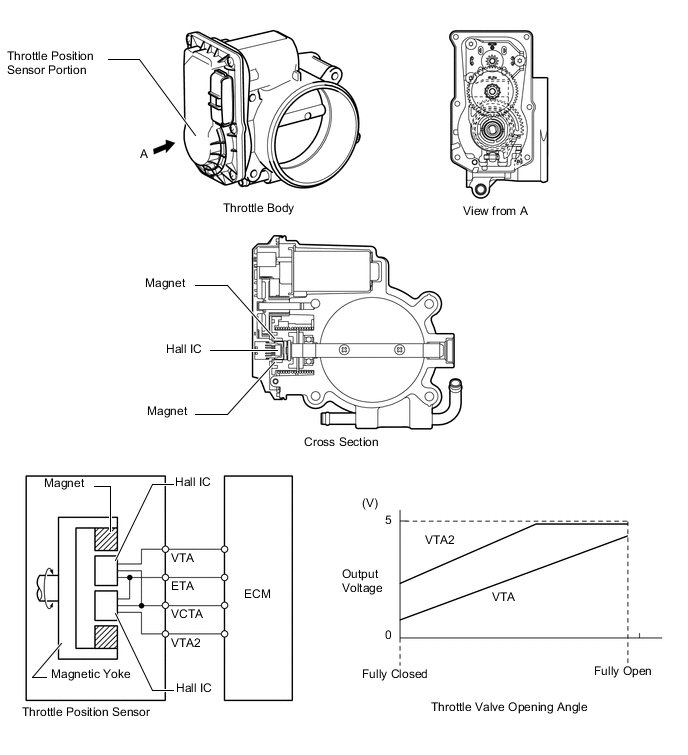

    Don’t forget part 89452-35030/TPS4-35030 is a stand alone 4 wire TPS that looks like it functions with the same twin hall outputs. This could allow the custom gear shaft idea to integrate nicely.

    The 4 pin TPS looks to have the proper rotation. Factory connector should be part number 90980-10711, available through dealer, OE aftermarket Tyco/AMP # SSC-4S-A , or china. Maybe we can track down a 6 pin to plug into the factory harness and make adapting plug and play.
    Edit. This should be the 6 pin mating part that will plug into our harness.
    https://www.bmotorsports.com/shop/product_info.php/products_id/5863
    We could also look at re-pining the factory pins into the 4 pin connector.

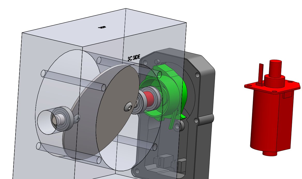

    Spent some time this morning flushing it out a bit more. Right now it's at 94mm, and there's no way (easily) push that higher. The Tundra bolt pattern with a .030" wall thickness around the bolt heads ends up there. The alternative is to make an adapter plate, which seems kind of dumb, but would allow the size to get pushed up since we wouldn't be stuck with the Tundra pattern. Maybe use the RCF bolt pattern so those spacers still work. But that's also drifting from the initial objectives of eliminating adapters.
    Thoughts?
    Also with the electronics pushed outboard, the spacing of the stock gear train actually ends up fitting with plenty of clearance. These pictures are with the stock idler gear, so theoretically there's three custom parts: the housing, throttle blade, and the shaft which is pretty cool!
    ViktorG[OP], Mdl, Wynnded and 3 others like this.

    This is amazing. Honestly 94mm seems pretty good especially learning the limitations of the trans shift and learning/control. That's a substantial increase in throttle area

    And the more I think about it, it doesn't make sense to do some adapter setup because you physically can't port the superchargers beyond the factory bolt pattern anyway. So best case you port your blower and match the TB size. Anything more and you have a custom bolt pattern tapped into the snout so need a spacer regardless.
    And this is ignoring the Whipple which needs a spacer to begin with.

    My only critique (hopefully constructive!) is how the two shafts connect. The keying is great for alignment, but screams stress riser. If that outer sleeve can take some of the rotational load… splines, press fit? There is some decent load and high cycling there…

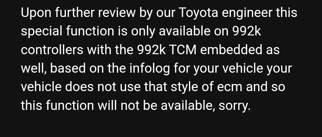

    @armyoffoo finally got a response from HPT.
    Guess we are out of luck. They did it but for a different model.

    Hmm so meaning we won't be able to dial the driving habits?

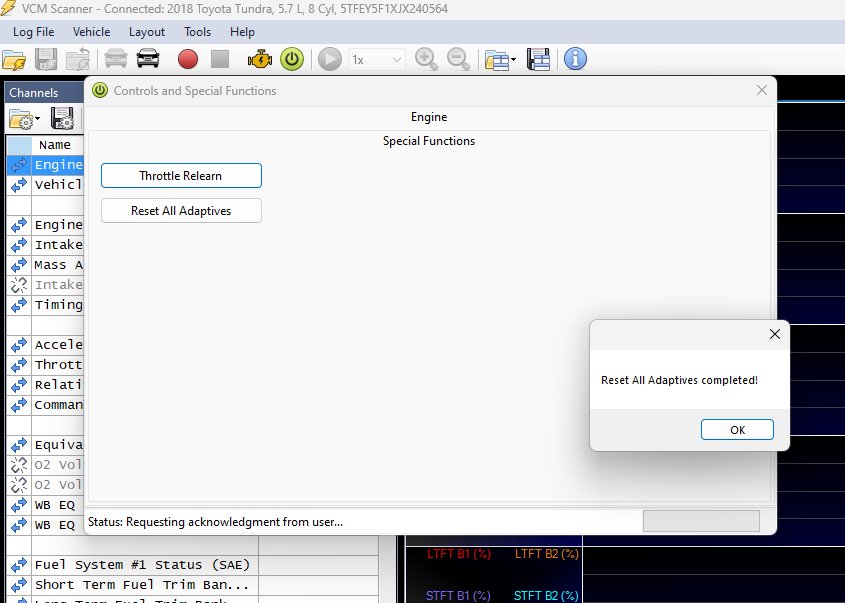

    That was for the shifting relearn reset. Just changing throttle position vs accelerator and dialing in shift rpm's has me about 90% there. I did disable flex lock apply and have the tcc set to @snivilous lock/unlock rpms give or take a 100rpm.

    Are you using the latest Beta version? When you run the beta and connect to the vehicle it performs a firmware update on the MPVI unit. After that, it's there for mine, I just performed the relearn, but haven't done a test drive...Reset All Adaptives doesn't run successfully, but Throttle Relearn completes.
  27. Apr 12, 2024 at 6:35 AM
    #417
    Mdl
    Mdl Hey there...
    Jun 14, 2023
    #98638
    3,240
    PNW, WA
    2007 TRD SC'd
    JBA Longtubes, Snivs 2.0 SC pulley, ASP crank overdrive pulley 6.71 in, DD Full 3inch dual exhaust, IPT valve body, Airbox mod, 4.5inch intake, Denso 750, 450 Walbro, W/M injection, GM 95mm TB, SABM, Camburg UCA, Icon shocks, Speedmaster LSD, Motive 5.29 Gears, Mickey Thompson Baja Legend EXP 35's, Solid Offroad engine and transmission mounts, DIY Traction Bars, Tuning by Snivspeedshop.com
    Hmmm. I downloaded it twice. It did a firmware update. I wonder if it's only on the 2.5 Gens on up. I thought the 992k ecu's were on a different model but at least you got it. I did have a shop do a shift relearn back with the 103mm TB.
    I'll give it a 3rd time to see...
    armyoffoo[QUOTED] likes this.
