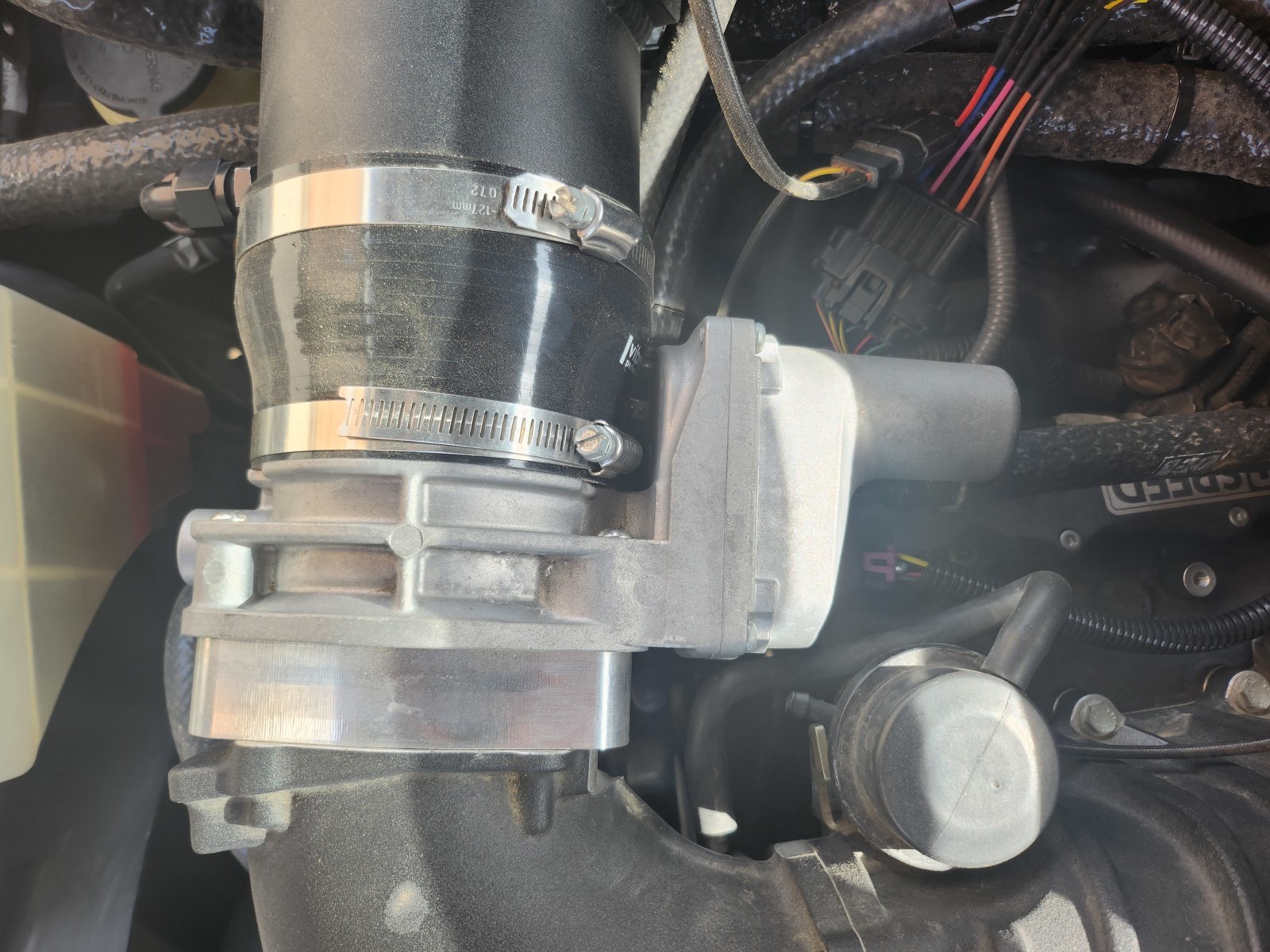

    Can you show a top down view so I can see where the motor sits relative to things?

    It's got maybe 4mm between the TB and the vacuum hose on the bypass valve

    Yea I’d rather have the motor facing towards the front at the rad more room there.

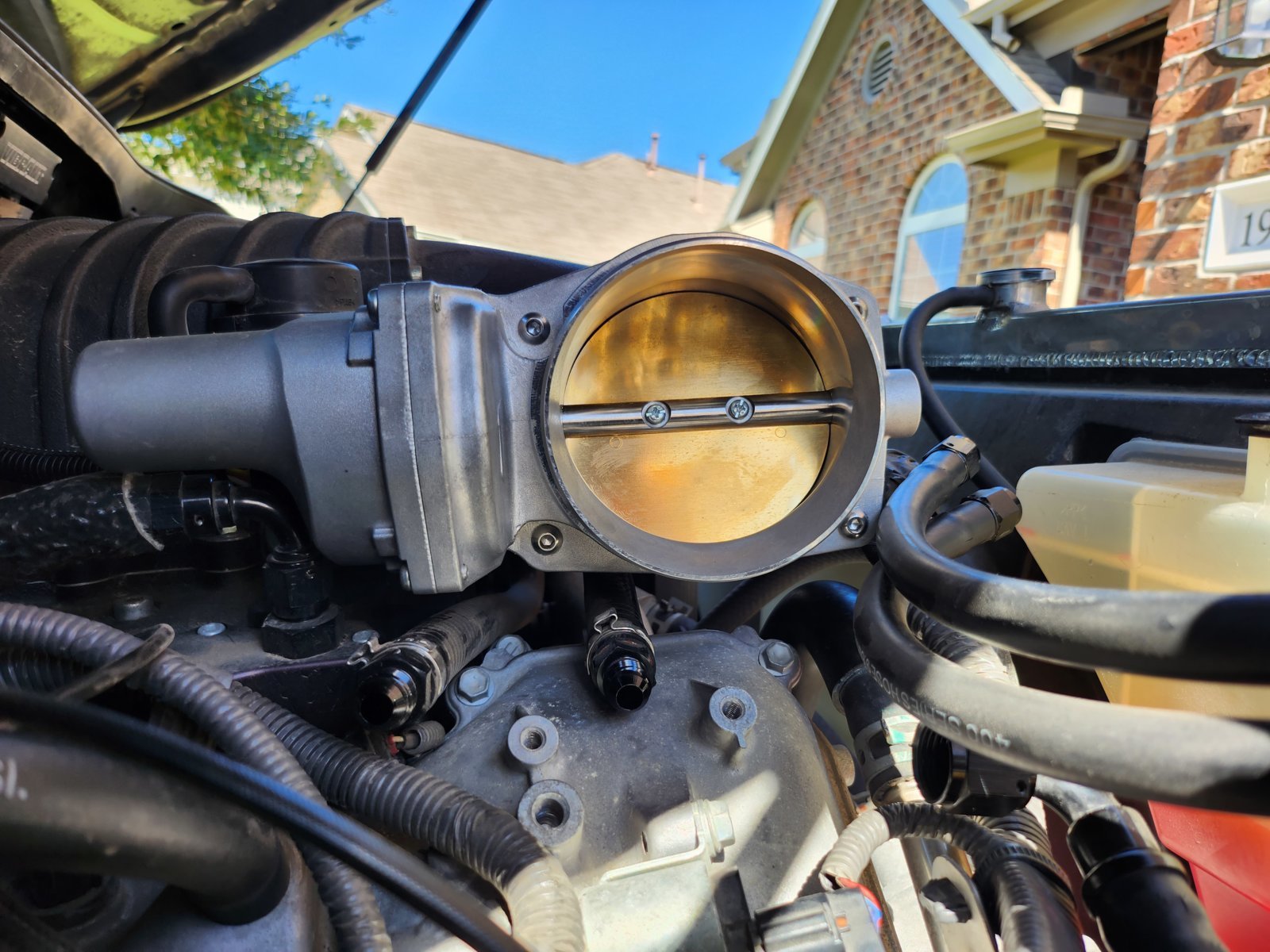

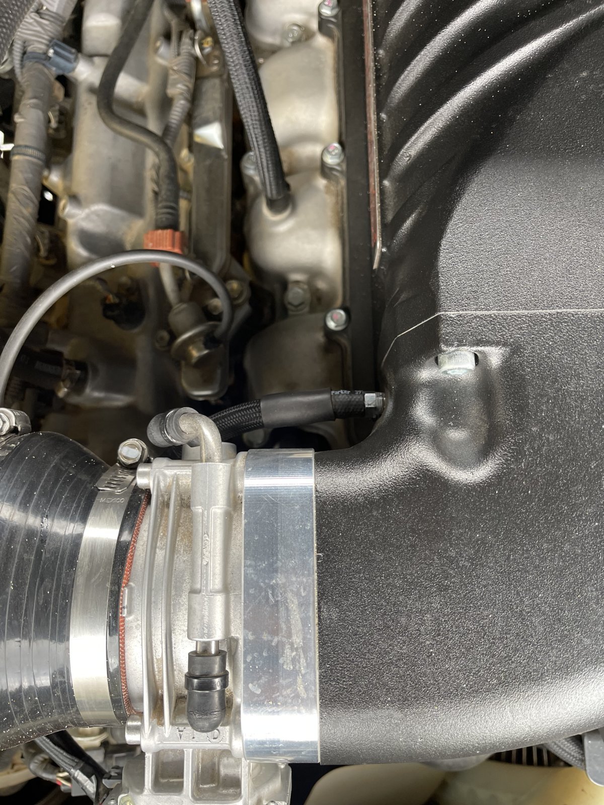

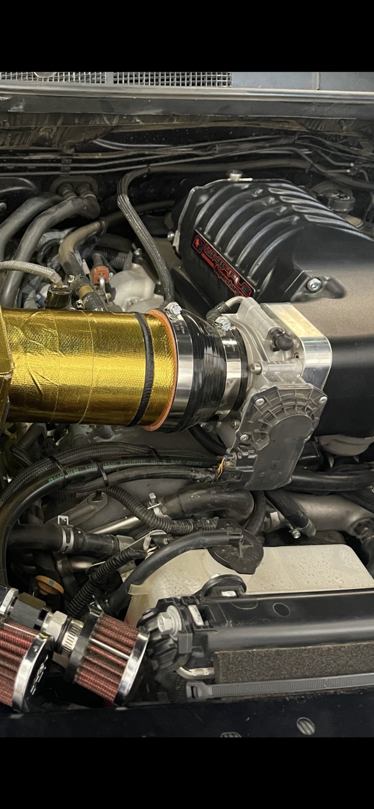

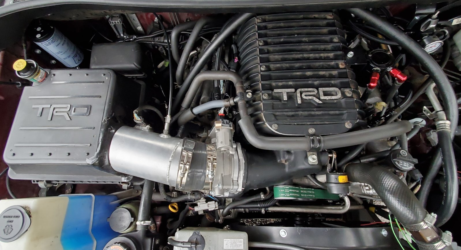

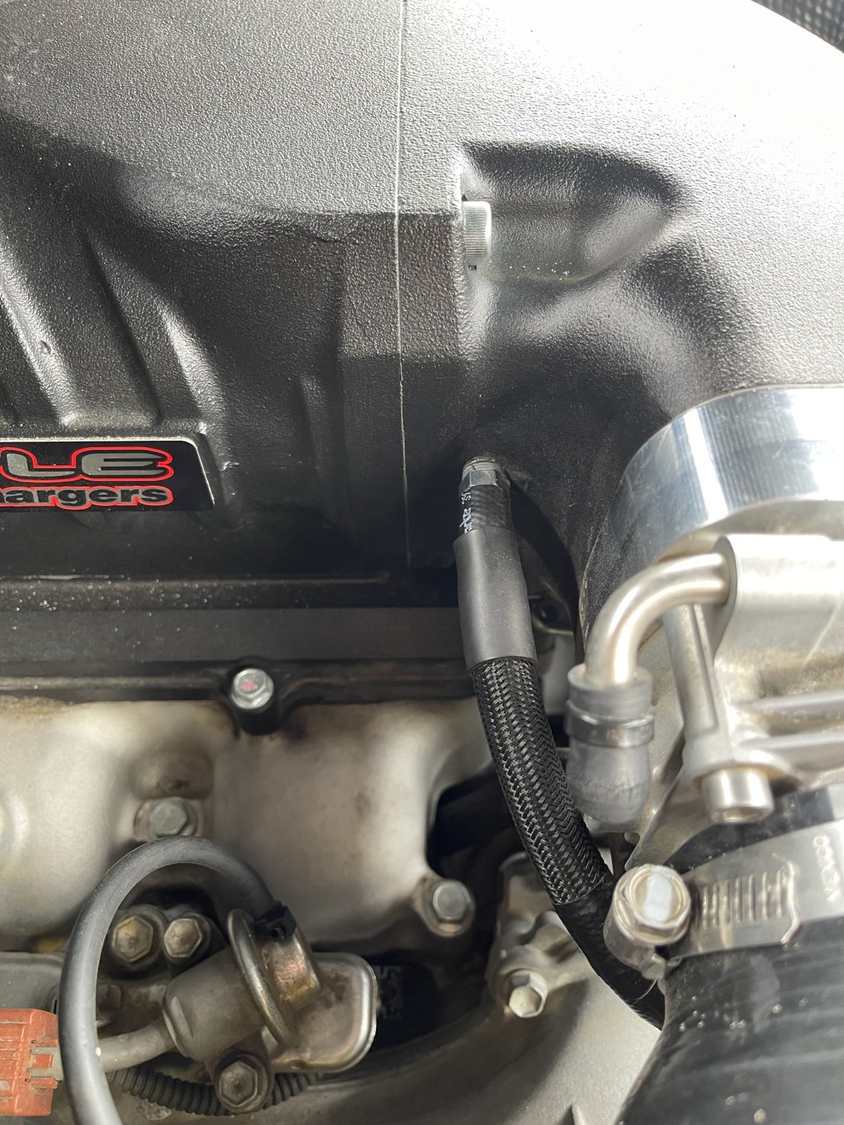

    This is on the tvs1900 with the 103mm TB with my bastardized mounting. On the 2650 it seems Iike it would hit the SC body.
    But wouldn't you be using the gm digital TB design motor like the Toyota as it wouldn't be extended out as much?
    **referring GM 95mm has similar design to Toyota TB.

    The one I have won't mount 180 out because of the radiator overflow, but could make it work with a different angle.

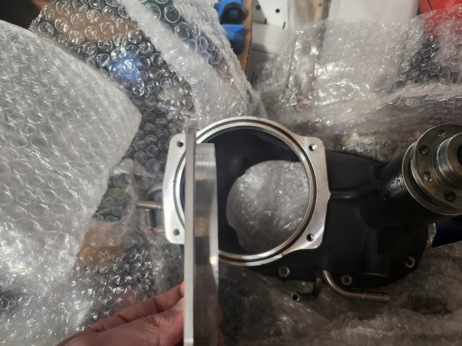

    That’s the idea, flopping the motor over 180 places it off to the side. The problem is the plastic cover contains the connector, sensors, and such.
    Modular would be nice.
    Here is how VW built the ramp…
    9CE9AF1B-2E2F-46CF-A9AB-629232F59C8B.jpg 4C405605-B982-4FCD-8E80-507185AA16E9.jpg

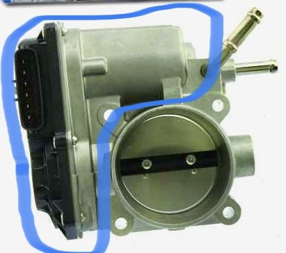

    I believe GM has it where they can be clocked 20deg left or right. So Toyota TB could be clocked left or right.

    It looks like if the motor was flipped so it went towards the cab and sat where the coolant line is there'd be plenty of room?

    Just referring to the different designs and how each one differs. Gm 95mm=Toyota 76mm and Rcf TB.

    Only thing I can tell could be a problem is the vacuum line by the TB.

    But not sure how low that motor would sit that’s on that TB

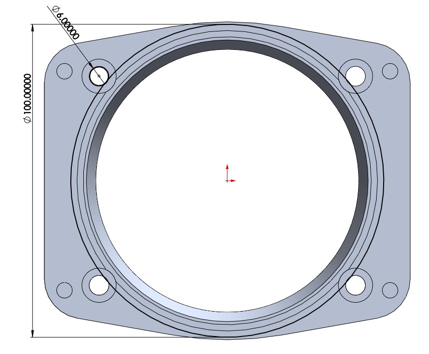

    We'll see if I can push 103mm. It looks like 100mm is the EASY limit based on the Tundra bolt pattern. Might have to see if I can get sexy and push it a bit. @reywcms I forget, does the Whipple use an adapter in stock form since the Whipple bolt pattern isn't for a Tundra.

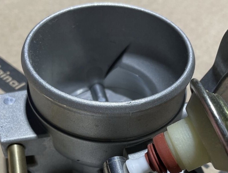

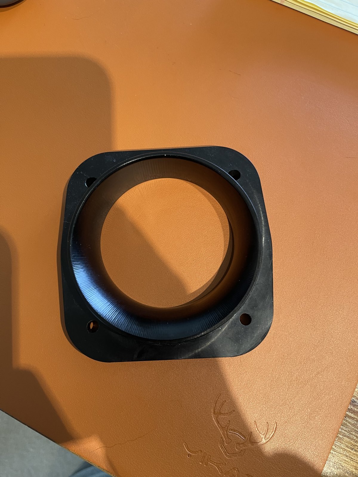

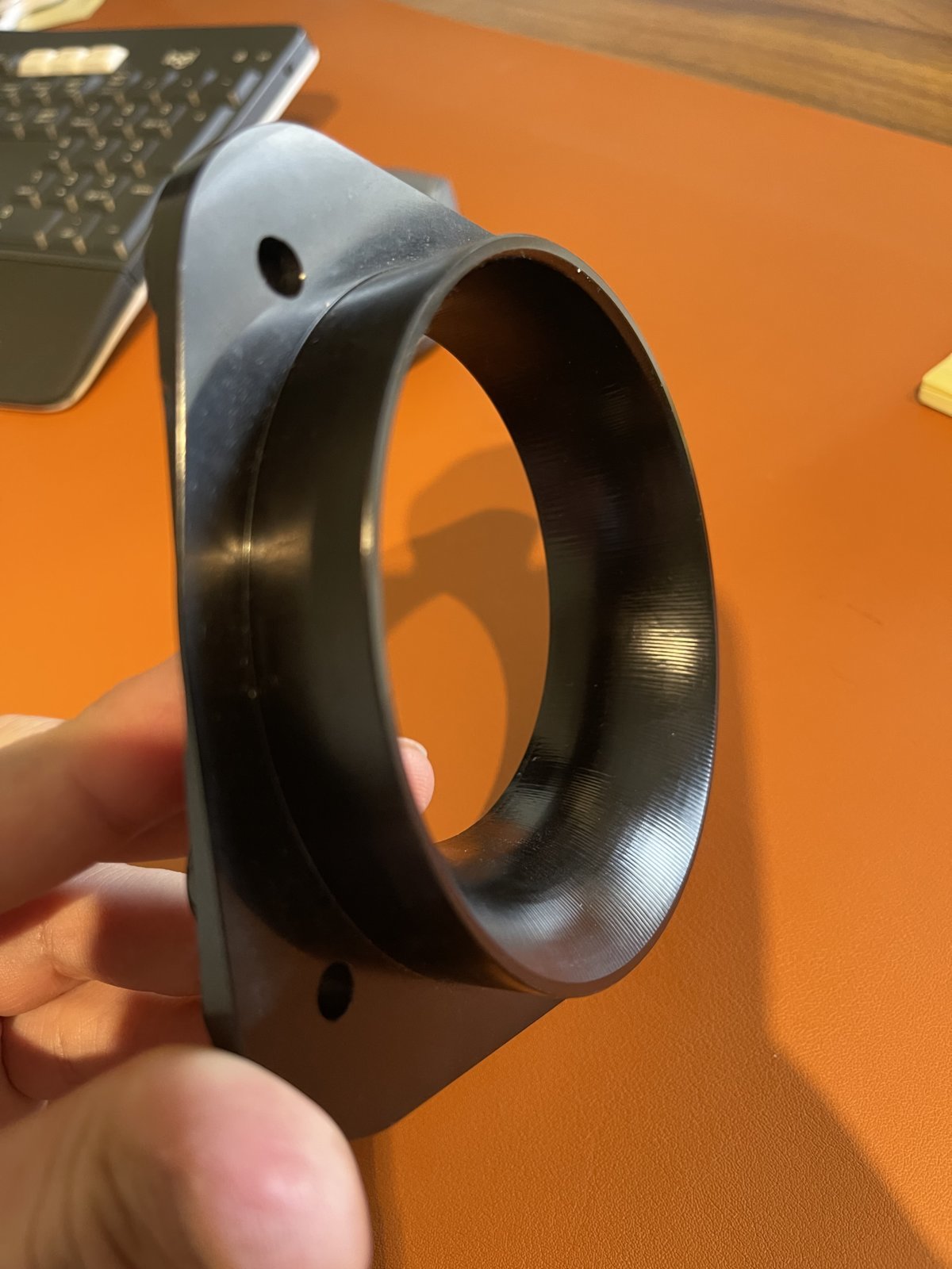

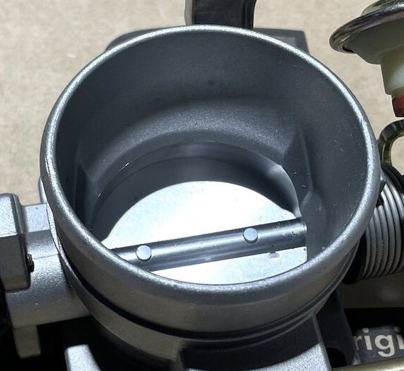

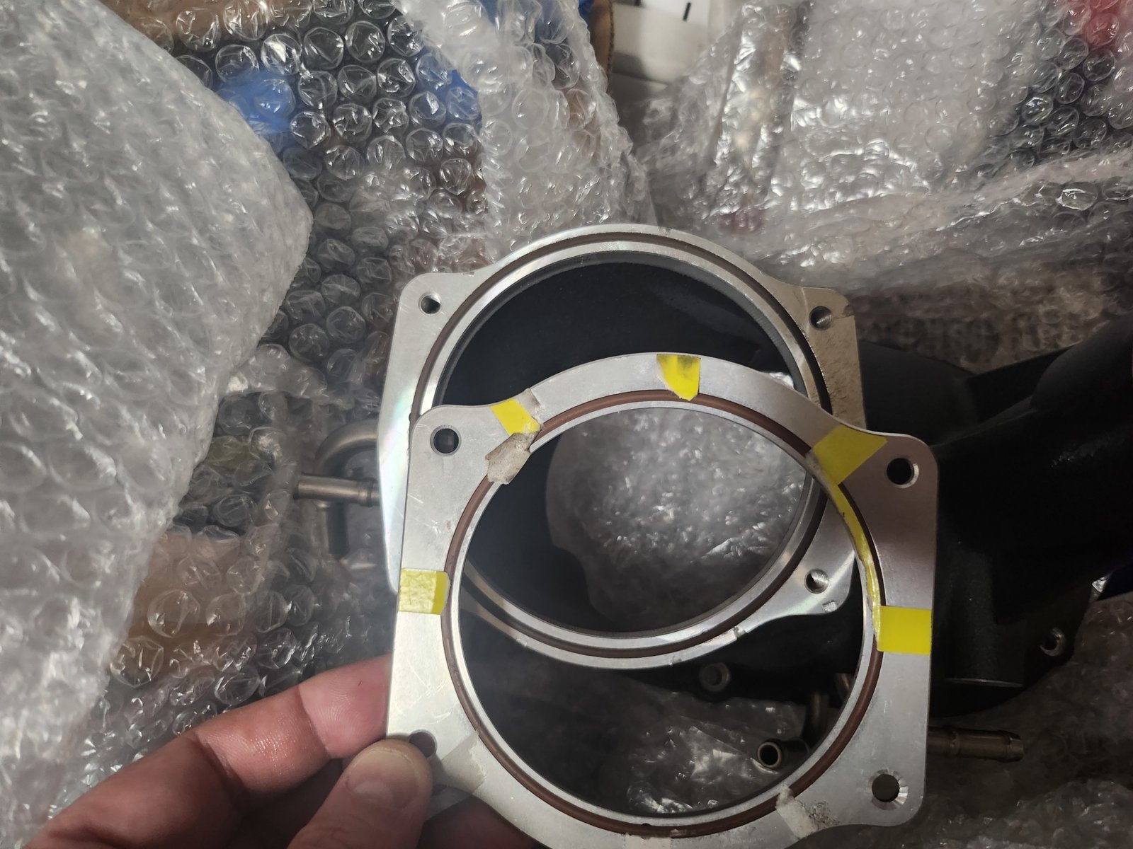

    Whipples inlet is 102mm and yes in stock form they include an adapter with a nice bell flow. Let me snag a pic uno momento
    ZPhilip and Mdl like this.

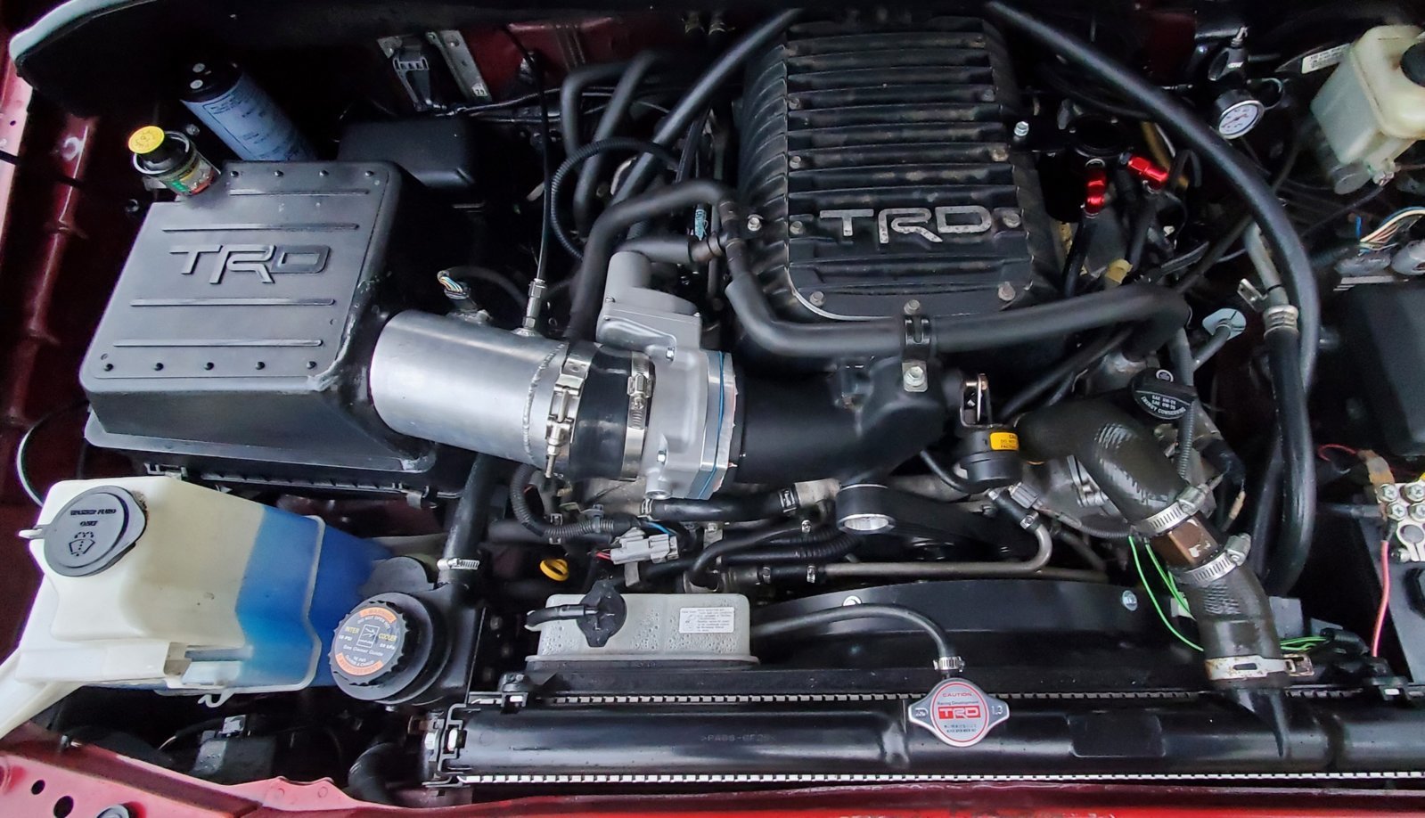

    Pics added

    Someone double check this since it seems wrong, but this is what the CAD from the throttle body spacers I've done says:
    Whipple: 99mm inlet
    Harrop: 84mm inlet
    Magnuson 1900/2650: 90mm inlet
    Mdl, reywcms and armyoffoo like this.

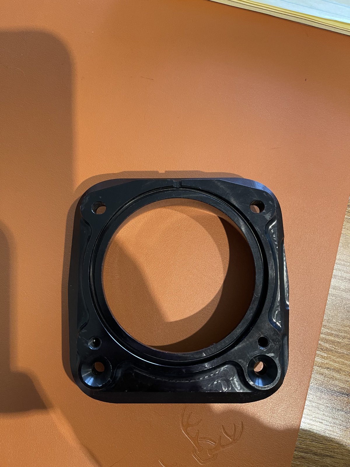

    Harrop Tundra inlet is 84mm
    Here is the adapter that comes with the Harrop GM front snout, it fits snug into the snout and narrows the inlet from 102mm to 90mm...could probably do something similar.
    Mdl, snivilous and reywcms like this.

    Tvs1900 I was able to port out to 94mm with 76mm bolt pattern.

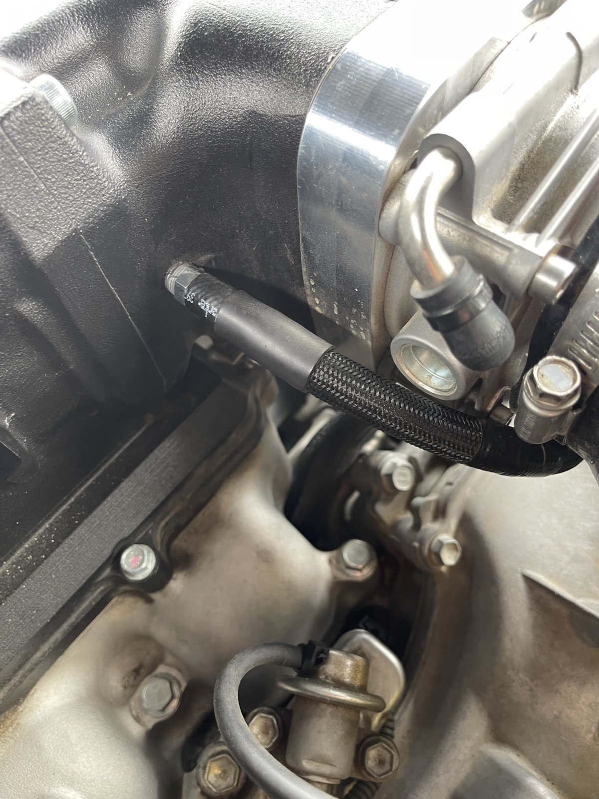

    One issue I ran into when having the meth injection nozzle past the TB - if a tiny piece of dirt or whatever was preventing the meth solenoid from seating fully when off, the vacuum in the intake would a suck the whole bottle of water/meth very quickly :)
    The first time it happened, I was at the track and was sure I blew the head gasket after a run, it was running like crap and blowing white smoke. Then it magically stopped after a while and I noticed the tank was empty, so I put two and two together. After it happened a couple more times afterwards, I relocated the nozzle to before the TB.
