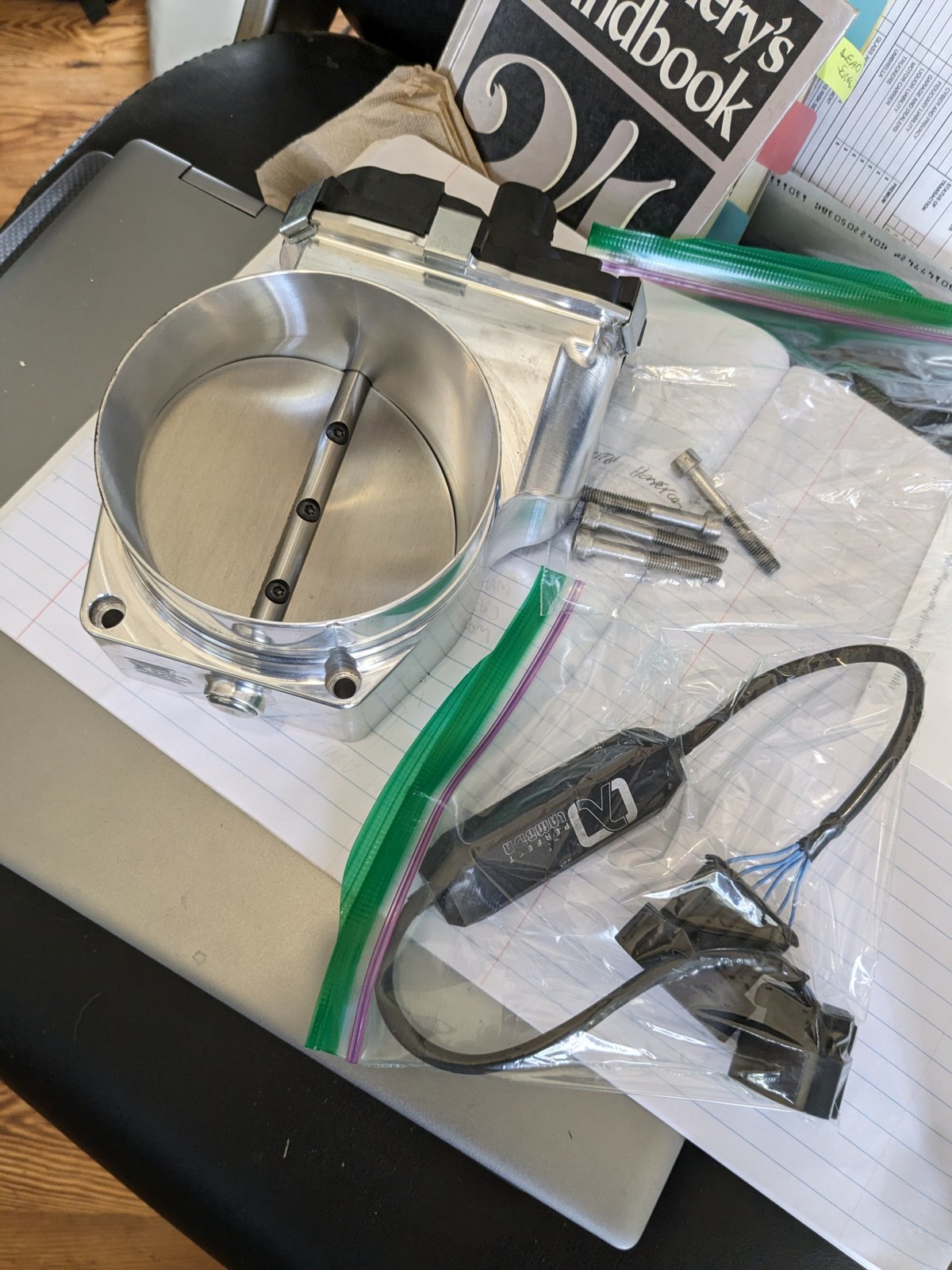

    I just got @reywcms new TB from @ViktorG and it's gorgeous!
    But this got me thinking (and coincidentally I had read about someone making their own TBs the other day but didn't put 2 and 2 together), why don't I just design us a TB that uses the Tundra electronics? Sell it as a kit where you get the billet TB and plate and shaft, and then take your stock TB and swap the electrics over and voila. Bolt up to the Tundra bolt pattern, no need for the signal converter, would effectively be a stock unit.
    Did we already talk about this and I forgot and that's why no one has looked into it? I would probably need to machine it overseas to keep the price in reason (like sub-$300?). Would anyone be interested in that?

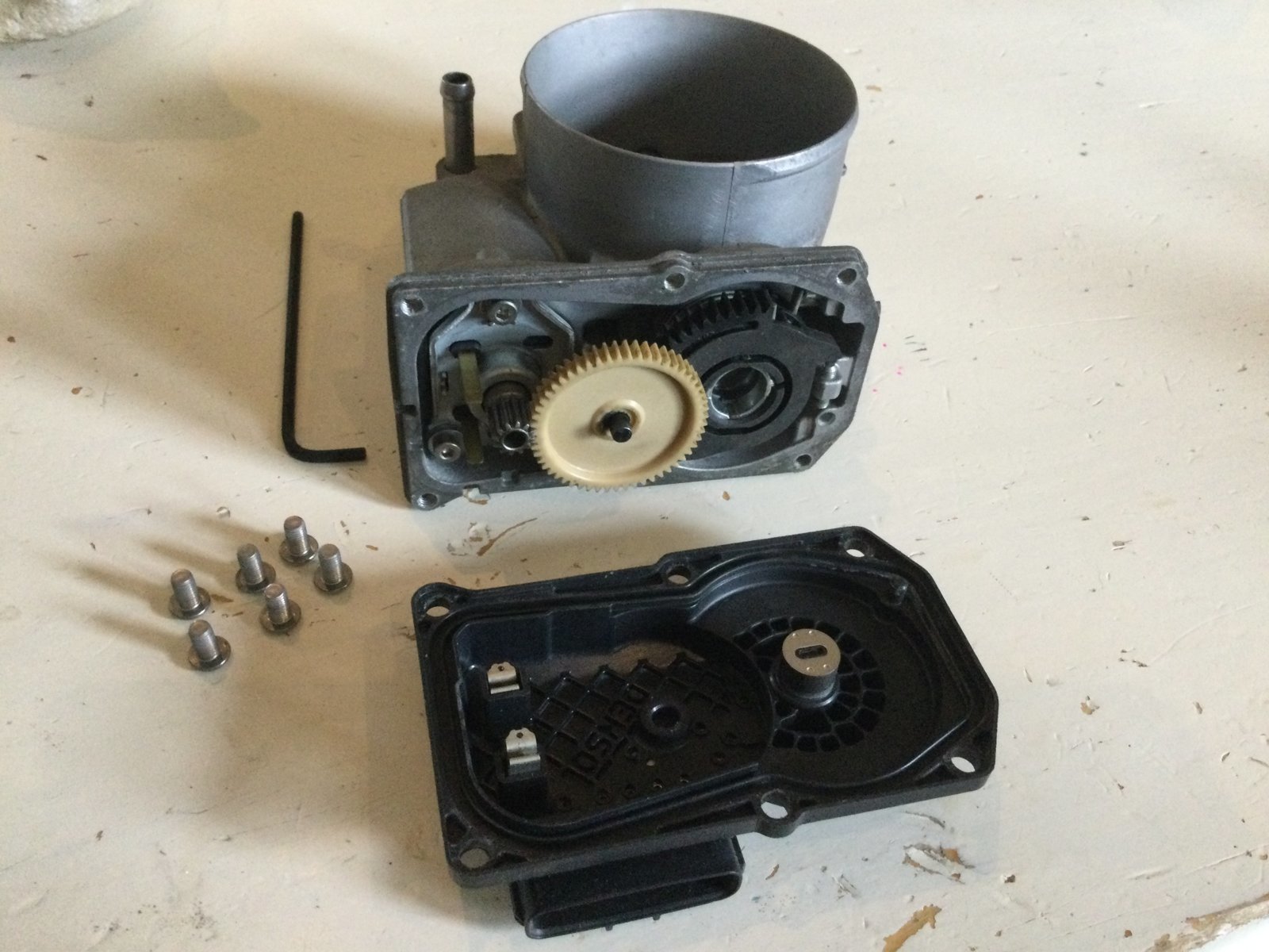

    I just looked at my stock TB, the electronics hold down plate is riveted, so I'm definitely not taking my apart that I need :D Rey is trying to get his hands on a stock one to send me.

    YES! A project I too have wondered about. One hurdle will be the motor, as it is directly in the way of expanding the throttle plate diameter too much, less so on the RC-F. If you find a work around, do post about it! Flopping the motor over 180 is a possible solution, but one of the sensors is in the plastic cover. The other 1/2 of the sensor is built into the end of the throttle shaft with a gear on it.
    They open up easily…

    Looks like an additional idler gear could be added to offset the motor more?
    EDIT: Or just upsize the idler gear in there actually
