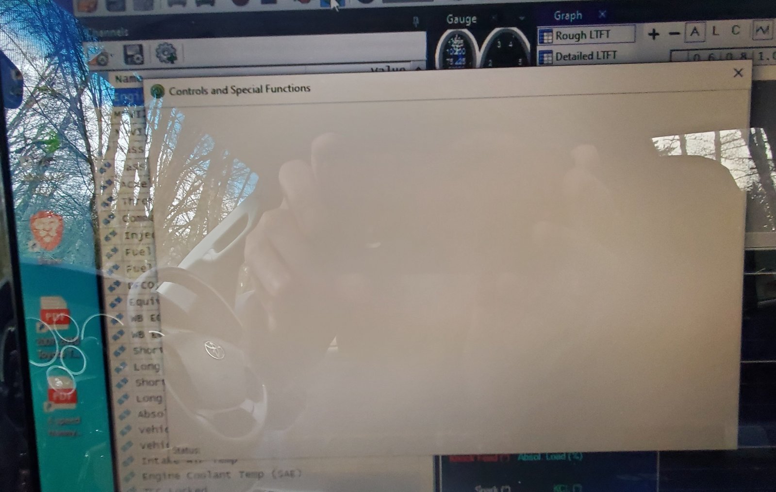

    I downloaded the beta version and didn't see the reset it in editor. I hooked the computer up to verify vehicle then took it inside to adjust pedal vs tb angle. Trying it 5% at a time. Will load later on.

    It should be in the scanner utility, not the editor, but I'm not sure where though. I'll admit, I didn't verify, I just posted what they emailed me. I should be able to try it in a couple of days though.

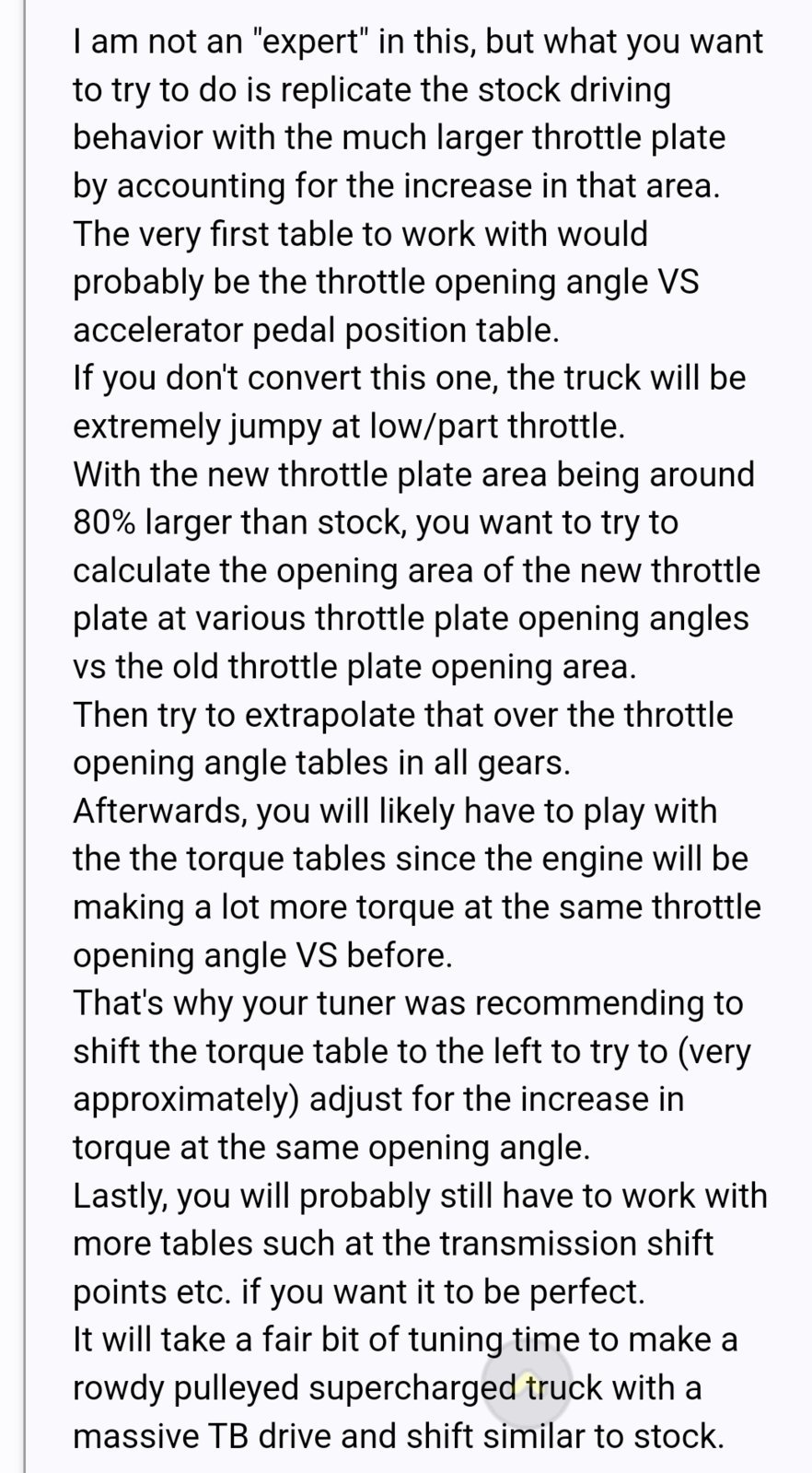

    A few pages back he stated he was dealing with the high/flared shifting rpm. He didn't mess with it as he was just driving to the track.
    Here is what he posted.

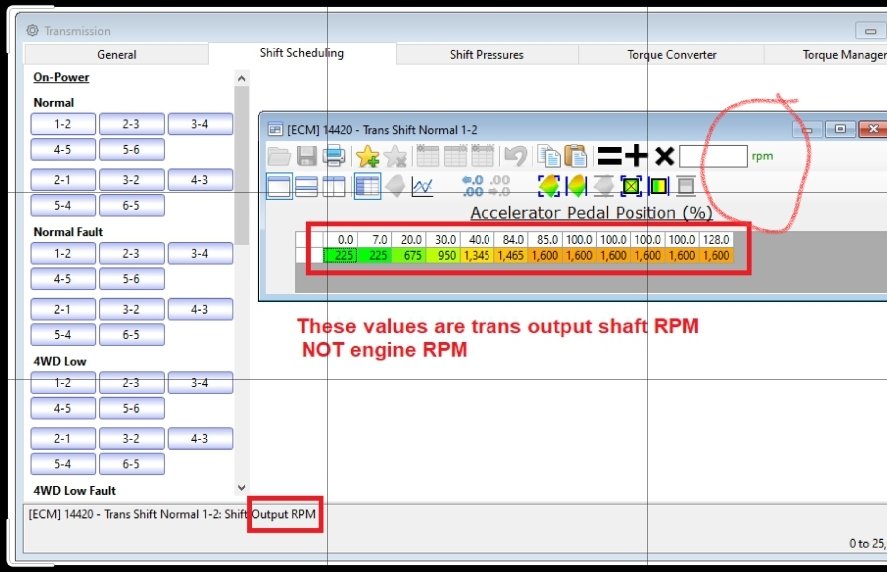

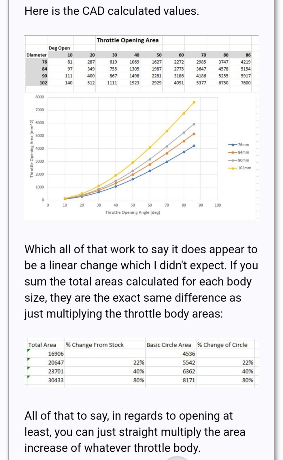

    Sniv correlated the change in plane for the TB's. 76mm,84mm, 90mm and 103mm.
    From what I've read they always don't follow an exact formula for increasing or decreasing throttle and TB. Gotta play to get it close. But I'm sure using a formula will get you in the ballpark. Plus from what I gather you can't change the throttle vs TB angle too much as it could brick the ecu.
    I've been playing with 5% at a time. Also shifting for trans output rpm... will put them all together and see what happens. Been testing individually to see if it messes with the ecu.

    Is there evidence of this? And does it mean to change a bit at a time but you can do it forever to get to the point you need, ie don't do a big jump from tune to tune? Or there's a hard cliff that if you set it too far it bricks?

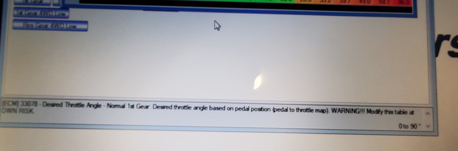

    I'm not 100% sure. Grant at TRP said that changing more than 10% "could" cause issues and brick the ecu. But he's never encountered it. Was just a warning. He ran dual 90mm TB's on his GM and changed the TB airflow planes without issue, more than 50%. He probably was just giving a heads up of what could happen.
    Crap picture but he warning from hpt too. I'll keep changing it and see what happens.

    I guess that I interpreted that warning differently. It made me think that if one were to have the throttle angle set too great at, oh say, zero pedal position, it might result in kind of a runaway situation where you wouldn't be able to "close the throttle" and the engine could be unintentionally run up to the rev limiter. Or, the ratio of pedal input to throttle angle could be too aggressive and during a test drive a small input could result in the TB opening WAY too much and put you through the back of the garage, or into a cement mixer or something. But I might just have an overactive imagination....:sorry:

    Yea I thought there were a handful of tables with that warning. If it was me I would just yeet to the value. But I'm also not doing it and no one warned me :D

    I added the shot about the warning. Wasn't sure what that was about. Grant has worked with people on different vehicles and just something he mentioned. So I was just proceeding cautiously.
    I'll try and find the email to re-read it. I tend to delete old stuff.

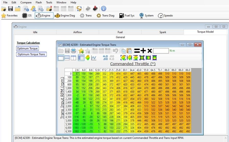

    Ok... I made 3 different tunes to test. Maybe test on Friday.
    I'm using the GM 95mm TB which is about 50% more air than 76mm.
    1. Moved optimum torque load 3 cells to the left.
    2. Reduced electronic throttle desired angle by 50% to 39 deg then smoothed to 100%.
    "Hopefully this one doesn't mess with my ecu!"
    3. Reduced shift scheduling by 200RPM in the 20-50% range. Did a little less at 60-85% and left 100% alone.
    Each one is an add on to the previous to see how they interact.
    shift point adjustment for tires/gears...

    So... I am happy to report that reducing throttle angle by 50% did not brick my ecu. Shifts from 1-2 at part throttle are under the previous 2800rpm and down to 1500. 2-3 shifts are a little higher but not in the 3000rpm range. Shift into 4th and 5th need a little tweaking but are way better. Will work on 5-6 as it stays in 5th longer but does shift into 6th. It will downshift 6-5 when encountering a increase in grade. I still have to adjust the torque converter lockup rpm as @snivilous reminded me. The tune for shifting is kinda rough but will keep fine tuning it. Just happy it's better and will keep at it. Grant at TRP was helpful in laying out a game.
