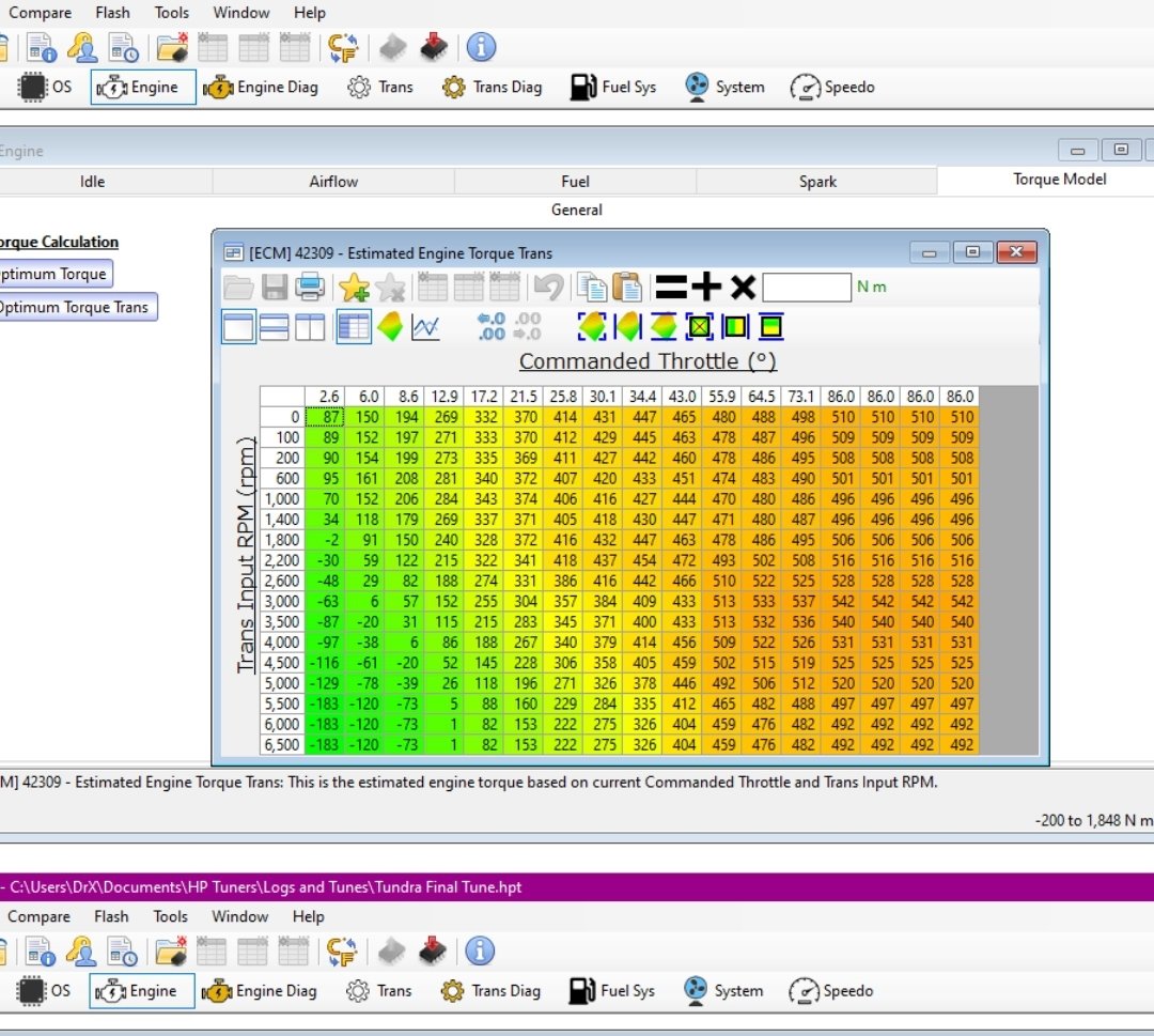

    @armyoffoo was this table from your stock file or tuned?
    I adjusted my pressures in each cell and lowered the output shaft rpm and it is shifting better. Still need to fine tune the 1-4 but not like it was.

    Those values aren't from my tune, my values only go up to 399...I think that may have been scaled by Grant. When I compare my older tune file to my stock file they are the same.
    Mdl[QUOTED] likes this.

    Thanks. Mine only go up to 403 and hw thought they were yours.
    **grant just pointed out that the graph is in Nm not ft lbs. Haha gotta pay attention.

    Ahh...yeah, that's mine then...switching units to Nm lines up, I missed that too.
