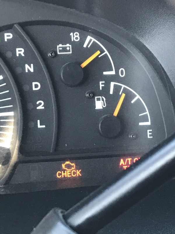

    Does this make any sense? Referencing my post earlier about what the torque I was displaying, I took my fluke and measured the volts 12.29v with the cables connected and 12.32v with the negative cable disconnected.
    I followed this guide HERE here and my readings were 0amps meaning no draw? If you don’t want to read the article, it’s stating to disconnect the negative battery terminal, take your multimeter and set it to amps, put one lead on the negative battery cable and one on the negative battery post to see how many amps passing through.

    Also, was your truck started in that Gauge picture earlier above? My awry comment was based on it looking low when running. Maybe I assumed wrongly.

    Engine was off, key on. I’m starting to think it’s a bad battery again. I don’t have faith in the NAPA batteries like I used to. Here is a video of the volts when starting:

    Not normal. If your dash gauge is also spiking then maybe its a bad alternator? One of the signs is spikes before giving up the ghost.

    I haven’t been able to watch the dash long enough to see when it is spiking but I’ll keep an eye on it.

    Voltage regulator is trying to compensate for seeing low voltage, usually a bad 'sense' wire, corroded and/or broken. Sometimes it's the voltage regulator itself (they are built into the alternator but can be replaced).

    So I’m back and square one. I was gone in Maui for a couple of weeks and when I got back, it was dead as a door nail. I jumped it and it ran fine after. I figured I’d do the multimeter test and it was still showing zero. I did some more diagnosing and long story short, the fuse inside my fluke meter was blown, hence why it was always showing zero on the previous tests. I replaced the fuse and this is what it is displaying:
    I had the battery tested and it showed good but needs a charge. It’s displaying 12.27v.
    From my little knowledge on this, I believe this is well below spec, correct? It’s not even pulling 0.5 amps (0.000052 amps to be exact).
    I did notice that voltage meter seems to spike when it is cold a couple of times but once engine temps are good, it levels out. I’m guessing my alternator is on its way out?
