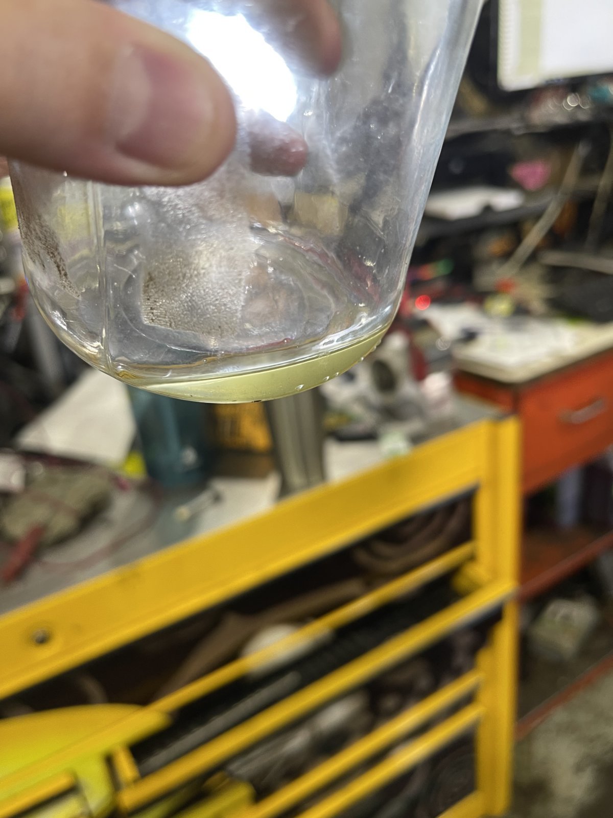

    So I’ve basically the same thing. 17 TRD Pro. 65k miles. Stationed in Alaska. Last year December was the first instance. It’s not uncommon to hit -40/-50 where I’m at. I’ve a block heater, oil pan heater and batt blanket when parked outside at work to offset. I’ll park in my heated garage at night when home. After the first cold snap I started having the extended crank issue. Usually 2 revolutions and it fires over now 6-7-8 turns and it fires over. If I were anywhere outside of town it gets pretty remote and cell service drops. Less than ideal for your vehicle to not start as you’re basically dead. Took it to Toyota. I found the TSB thankfully and they replaced the Fuel pump and Reprogrammed the ECM. Worked great for a year. Winter of 23 into 24 she reared her ugly head again. Hard cold crank. Take it back to Toyota. They “identified” a substance in the fuel tank after it was mostly drained and pointed the blame on it after waiting 2 months on an alcohol density tester and purging the fuel system, cleaning the tank and all lines. They think I had contaminated fuel an oily substance that would not evaporate and was sure it was the culprit. Go to pick it up and came out of pocket $1.4k. Seems all is well. For 24hrs. Extended crank and now the check engine light is on which is new. Haven’t had that with all cold/extended crank issues. Has anyone identified a solid fix? I only used premium. Just bought a new battery. Never used E85 or any other trash. I know there’s a few threads in which some are just resetting the ECM. Has anyone moved away from the OEM Denso crap and found reprieve? Looking for a solid fix. Thanks.
