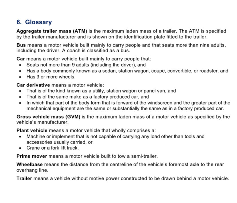

    Criminalize is likely not the correct term as it implies the Criminal Code. We’re talking about traffic laws/statues, regulations. Of course, commercial vehicles are inspected for weight and fines are issued for them being overloaded.
    I don’t see anything in that Lowell kit that implies you can simply increase the GVM by a tonne in Australia just by adding shocks. Google says GVM is 3,500 kgs. Going to 4,000 kgs is a 500 kg increase, or 1,100 lbs. Regardless, I hope you would agree if that is really the case it is an absurd idea. Have a read…
    https://www.drive.com.au/news/polic...crackdown-reveals-90-per-cent-are-overweight/
    https://www.nsw.gov.au/sites/default/files/2021-03/vsi-05.pdf
    When I mention illegally modded vehicle as it pertains to Quebec traffic/road codes, I’m speaking of oversize tires, and lift kits. We are restricted by an increase of only 2” in tire diameter over stk IIRC, and similarly for a lift.
    You imply by being only 200 lbs over is not unsafe. Someone else will say the same about 400 lbs, and someone else will say 500 lbs, and so on. It’s like telling an officer I’m only a little over the limit (alcohol).
    That article is ridiculous. Anyone knows the rating of the two axles is always greater than the GVWR. Again, this is for safety reasons, and is why the GVWR is always less.
    All I can say is if some a$$hat was over their GVWR, caused an accident that killed or injured anyone in my family, I would have my lawyer sue them for every penny for being over their GVWR. I’m sure you would do the same thing.
