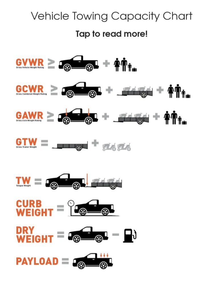

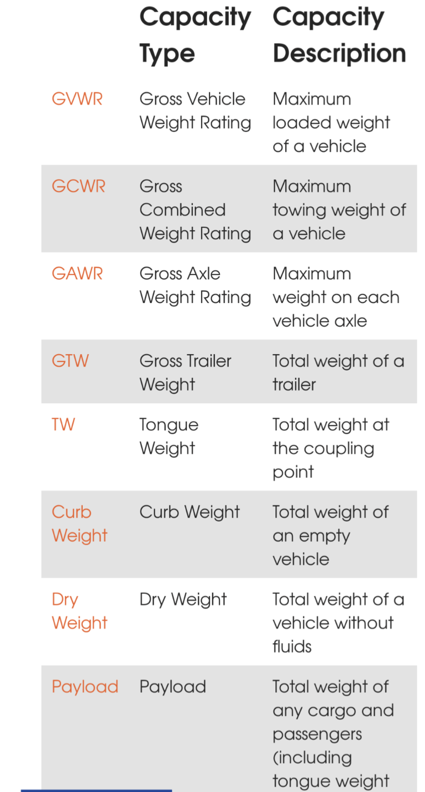

    1 - GCWR, GAWR, TW and PAYLOAD will never change whatever you do or change in your truck.
    2 - DOT and Insurance don't care about your upgrades , they'll go by the sticker!
    My 2 cents:
    17,000 miles towing my travel trailer in 2023
    - Dry 4200, max 6000lbs, 60% of TWR which is recommended rule of thumb for 1/2 ton truck
    - 25ft long, trailer length under 28ft recommended rule of thumb for 1/2 ton truck, those who have experienced strong gusts of wind know what I'm talking about.

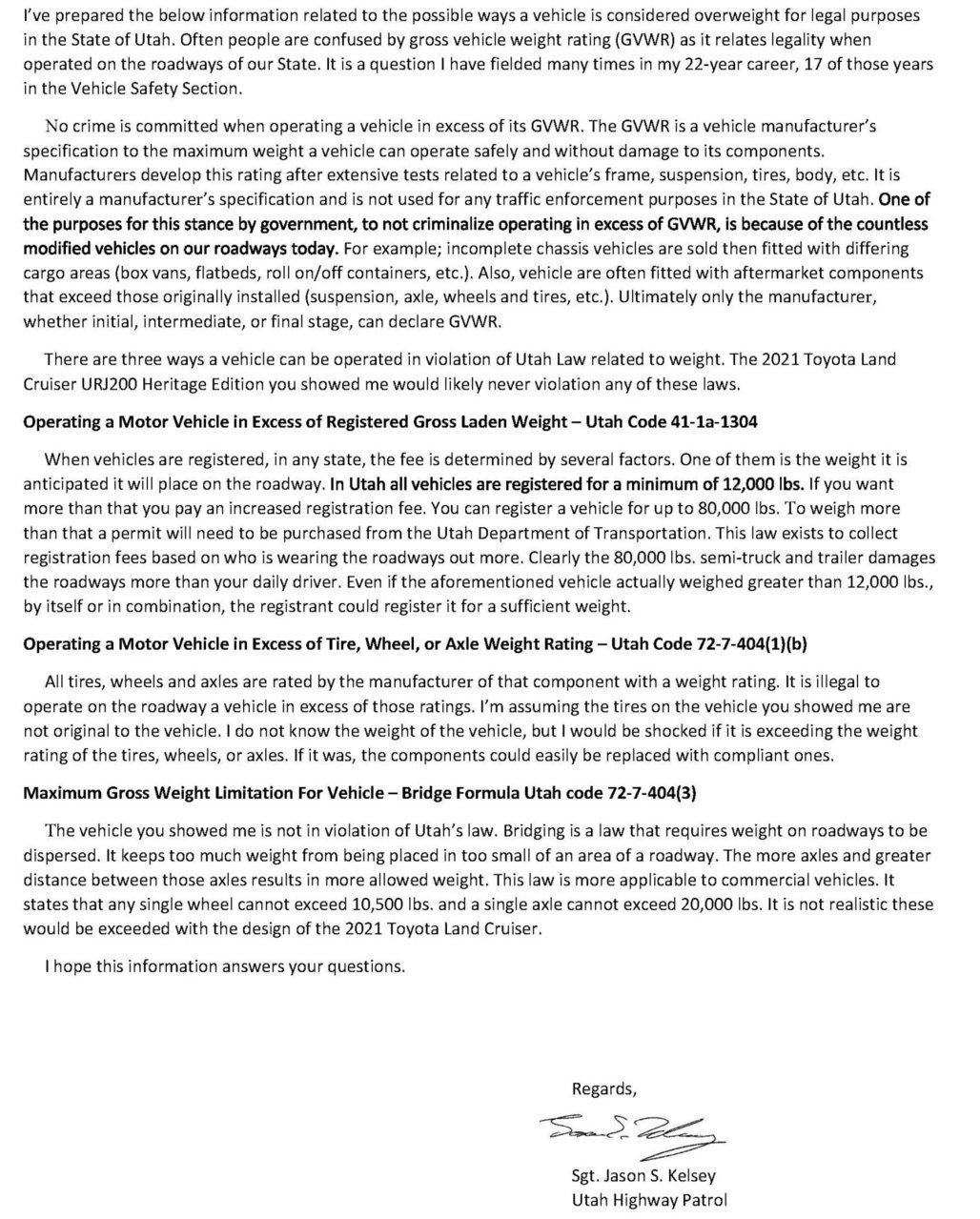

    Here’s a letter from an Utah state trooper with state law cited. Thought it was relevant to this discussion. It would be nice if we could get all 50 states’ regulations in one place.

    I wouldn’t put much faith in that letter from a state trooper about the legalities of exceeding the vehicles’ GVWR. In his opening statement he makes reference to the manufacturer’s GVWR as it relates to the maximum weight a vehicle can operate SAFELY. Lol! All the traffic laws are all about operating a vehicle SAFELY. What a backwards statement.
    As an example, many years ago, a co-worker told a story of how her and her husband were towing a large 5th wheel travel trailer though the desert in the US mid-west. She was driving and passing an 18-wheeler coming down a slight grade. There was a cross-wind, and as soon as her pickup (F250) and the trailer cleared the semi-truck, she felt the trailer get “sucked” in by the air vortex between the semi-truck and trailer. She ultimately lost control and flipped both her F250 and trailer into the median. She and her husband were very lucky, and only sustained minor injuries, and fortunately only their vehicle was involved in the accident. So, due to some unusual but common set of circumstances, we had the tail wagging the dog. Did she break any laws? I do not know the specifics, but they went out and got another pick-up and trailer from the insurance.

    Umm, ok…He’s saying that the state of Utah does not base legality of a load on the manufacturer’s recommended GVWR limits. “No crime is committed when a vehicle is operated in excess of its GVWR.” Rather, when one is in excess of axle, tire, and/or wheel limits—that’s when the state of Utah says there’s a problem. It’s really not that hard to understand, and at no point does he contradict himself.

    We have regulations, laws, etc. to ensure our safety and the safety of others. Vehicle manufacturers establish GVWR with road safety in mind, and identify such on each and every vehicle IAW FMVSS regulations. Saying it is not a crime in the state of Utah to exceed the manufacturers stated GVWR in accordance with FMVSS regulations is an oxymoron. Why then even go to the trouble of identifying the GVWR on each and every vehicle sold on the USA in the first place IAW FMVSS if exceeding it is of no criminal consequence?

    It’s not an oxymoron because the door jamb number is not a legal standard recognized by the state of Utah (or any other state that I’m aware of) such that they would write a law criminalizing the exceeding of it. Is there a federal statute that criminalizes exceeding those numbers? Pretty sure nope. Those numbers appear first and foremost to be a CYA for the manufacturer. Better safe than sorry in our highly litigious society.
    I’m not sure why this is surprising. Maybe you live in a different country, but in the US recreational towing by private vehicles is hardly regulated at all. RV dealers sell people way too much trailer for their truck all the time. Overland outfitters often bolt way too much crap to someone’s overland build that puts their truck overweight before anyone even gets in it. There are builds on this forum that exceed GVWR by 1800lb + with no one in the truck.
    In countries where this world actually is highly regulated like Australia for example, you can put heavier springs and skids on your 200 series Land Cruiser and get a certified GVWR upgrade to 9200+ lb. I’ve looked at the pages where outfitters offer this govt certified upgrade; it doesn’t look like they consult Toyota engineers at all before certifying those rigs for an extra TON of weight.

    We are talking in circles. The GVWR/FMVSS sticker is a federal requirement. No vehicle in the USA/Canada can be sold without the vehicle being certified by FMVSS/CMVSS and having such sticker affixed to the vehicle. It is not a CYA dreamed up by the manufacturer. In one of my previous posts, I linked to several sources indicating liability from being over one’s GVWR.
    What we’re both saying, but in different ways, is that even though Utah state law might not make it a “criminal” offence to load a vehicle beyond it’s FMVSS compliant GVWR, it is nonetheless unsafe to do so, and one could still be held civilly liable for doing so in a court of law.
    Getting into RVs is a whole other matter, as the regulations/laws are lax to say the least, because an entire industry would be wiped out if they “cleaned” up the driver requirements to drive such beasts as well as the shoddy design/manufacturing standards. This is a clear example of $$$ before safety.
    Being a Land Cruiser owner and a fan of Aussie off-roading, I’m somewhat familiar with the regulations down under. First of all, as you suggest, they have very strict laws regarding what can be done to vehicles for off-roading/expedition purposes. Obviously anything done to increase the vehicle manufacturer’s GVWR would automatically void the vehicle’s warranty. As you suggest, they have outfitters who are government/state certified to increase the vehicles GVWR, but only they are legally permitted to alter the vehicle to increase its’ GVWR which often includes stretching the frame to accommodate the “tray” systems they use exclusively there. Actual engineers perform the inspection and certification process. How the government/state determines what modifications are safe, and the method in which they are carried out, I have no idea, but like I posted about my experience with Mercedes and their militarized G-Wagon, one cannot just simply say the vehicle can carry an extra ton of weight with bigger springs and tires. If my G-Wagon example hasn’t convinced you, I don’t know what would.
    Here in NA, or at least in the USA, from what I’ve seen on TV, it seems almost anything goes went it comes to home built/modded vehicles. Does it make it right or safe? Likely not, but here in Quebec where I live, they actually have fairly strict laws for “off-roading” modifications and any other vehicle mods. Do I see lots of vehicles modded in a way that breaks those laws - yes. Do the cops bother them - not for the most part. If you get into an accident with an illegally modded vehicle, will the insurance company void your policy - yes. In fact, it is very difficulty to even get a kit car certified here in Quebec.
    All this is now way way off-topic. The point being is that by exceeding the vehicles various weight and payload ratings your are making it unsafe for yourself and others on the road. Hope you can at least agree on that point.
