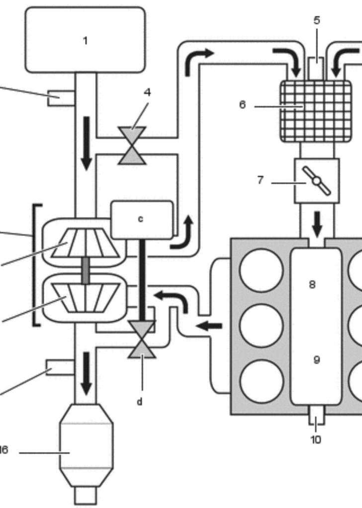

    Only happens when throttle plate closes.
    Otherwise you will have compressor surge.

    Wastegate is in the exhaust, this is on the charge pipe, pressure section.
    Two different things. Wastegate controls boost with reference to MAP and MAF sensors, along with throttle position and load calculations.
    Recirc/diverter valve, dumps metered pressurized air back into the charge pipe system to keep from screwing up fuel trims.

  7. Apr 16, 2025 at 9:39 AM
    #97
    PNW Tundra Mike
    PNW Tundra Mike Tired and ReTired
    May 29, 2023
    #97791
    1,261
    Back in So Cal
    2023 Tundra Limited TRD-OR CMax 5.5’
    MX4 Tonneau, Talon's Trans/Cat Shield, Vantrue Cam
    As you can see here, when 4 and d Open they allow exhaust (d) to bypass the turbo straight to the Cat and on the compressor side (4) to go back around to the intake.
