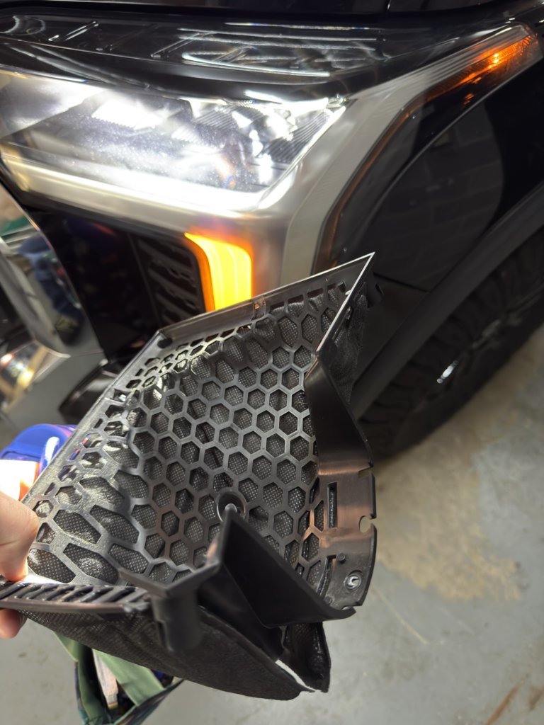

    Reviving this from the dead.
    I pulled the "sock liners" out of the intake boxes, coupled with the TRD factory intake panels, it has dramatically increased the sounds you get in cabin.
    This is correct. Your MAF (Mass airflow) sensor has accounted for the volume of air that has been ingested by the engine, and it goes into an equation with MAP (manifold absolute pressure) as well as a few other parameters that dictate how much fuel volume to be injected into the combustion chamber.
    My GTI had a MAF, and running a VTA unit would dramatically screw your fuel trims up and cause a rough stumble when you would get back onto the gas after venting boost pressure.
    TL: DR, if you have a MAF, keep it recirculated.
    Alternatively, if you MUST replace your diverter/recirc valve, these are my suggestion and go to. Had one on the VW, and it held 26psi of boost with zero issues.

    The TRD airboxes have a liner inside?

    Stock airbox, TRD panel filters.
    I'll grab a pic when i get home.

    These things. Just pull them out

    They simply pull out or do you have to snip off some plastic rivets first?

    I just yanked it out. It will break the small plastic rivets holding them in.....not too concerned about it.
    Again back to my VW days, we had something similar called a Snow grate. I imagine this is similar...cut down on noise, and let water drain if it ingested it. BUT, seeing as I do not plan on fording a river where the water level is at or above the intake ducts, i am confident in zero issues arising from this.

    Do these prefilter for the filters?

    nope.
