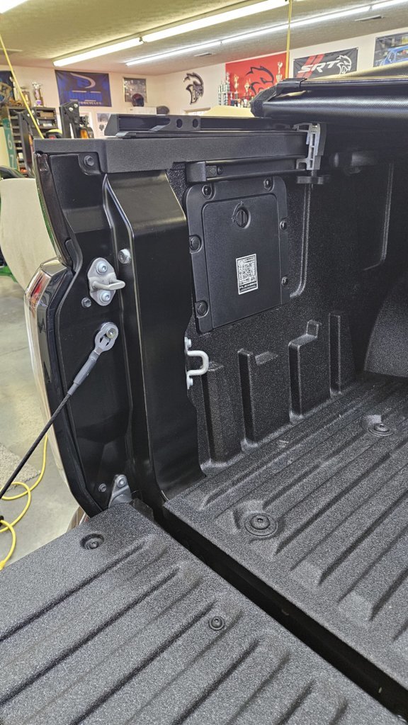

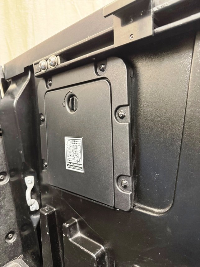

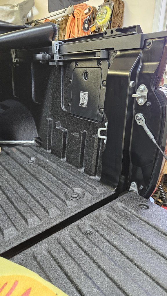

    You shouldn't cut into rib, it won't fit if you did. There's plenty of room if you use the measurements I posted above. (Post# 24) I just finished the passenger side, took about 30 min. Both sides done! Thanks again to @Sodamo for starting this. And next time I'm in Hawaii, ill buy you a beer or 3! 20250201_131533.jpg 20250201_131542.jpg

    Another nice job, Raven

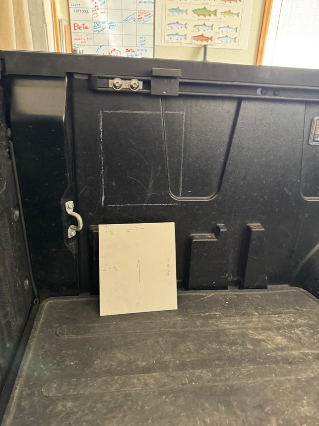

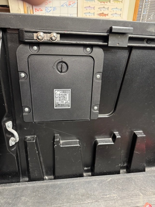

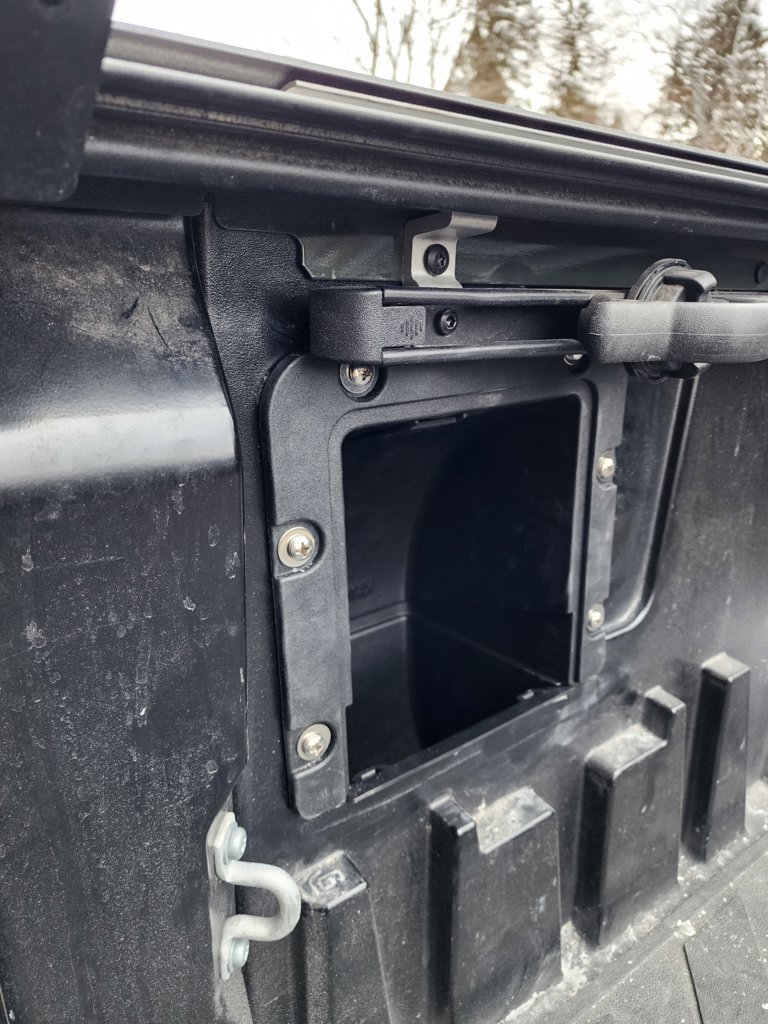

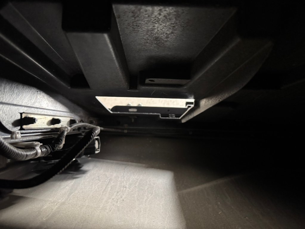

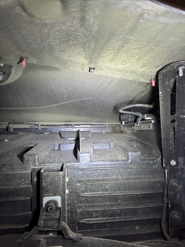

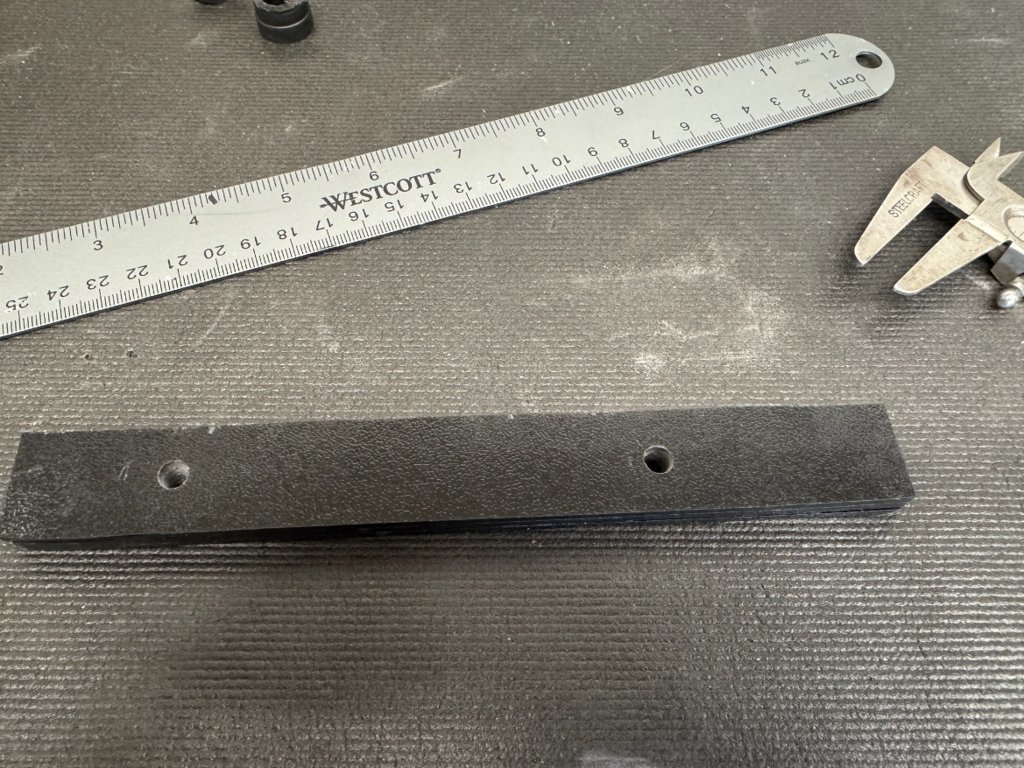

    I just wanted to thank Raven & Sodamo for all the help on this project. I finished mine today and now an official member of the Inbed Storage gang.
    I was going to use riv-nuts but after seeing that one rib was going to make it very difficult make it work I went with #14 1 1/2 inch panhead screws with washer. I used the cutout piece to make the spacers and I made it long enough to fill the entire gap. I made 3 1 inch strips and glued them together, drilled holes to match the storage lip. Sanded the edges and hit it with a little black paint. Quite happy with the results. Once again thank for the all the help.

    Glad to hear of another successful install
