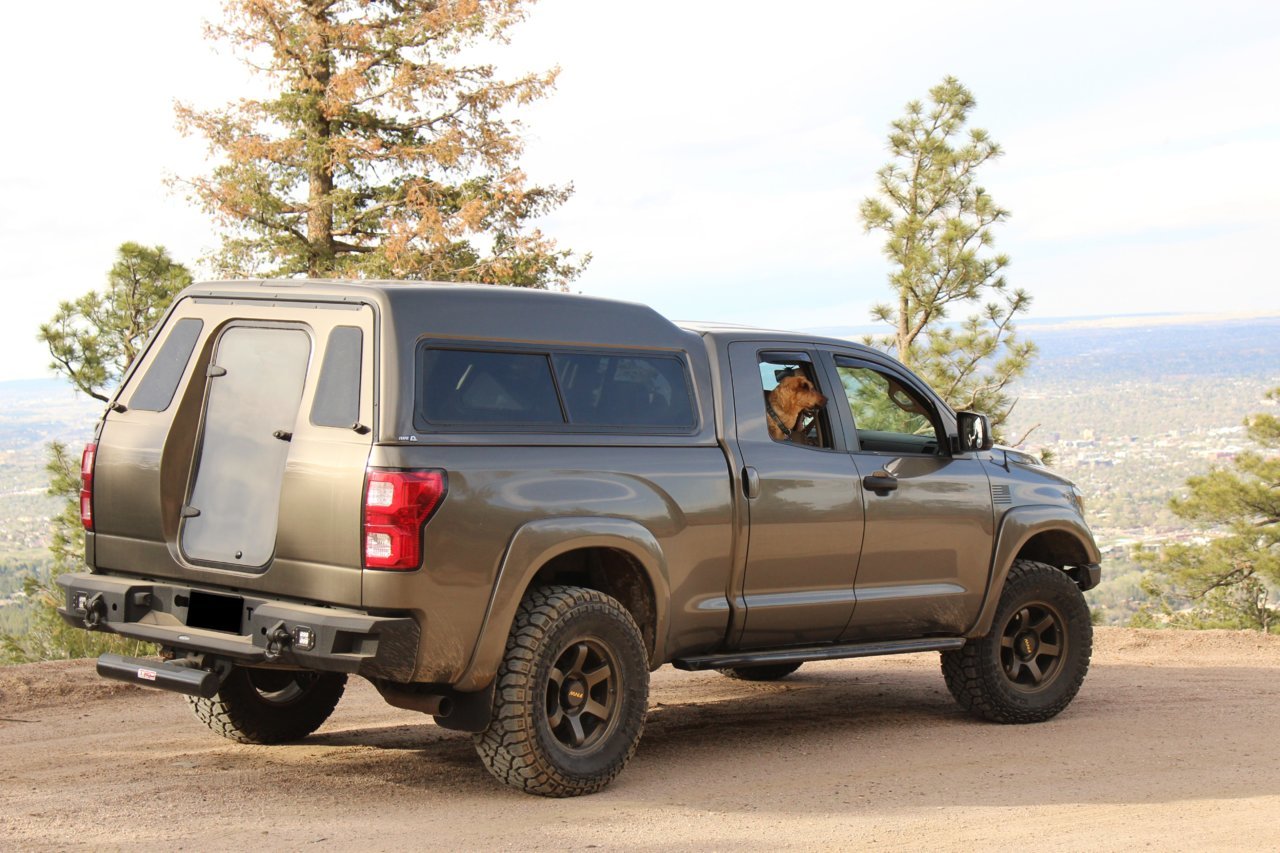

    I've got one, thankfully haven't been rear ended so can't advise on how it would hold up. I purchased for two reasons: I needed a step for my girlfriend getting into the camper w/ the rear access door, and secondly to hopefully reduce/prevent whiplash in a rear end situation.

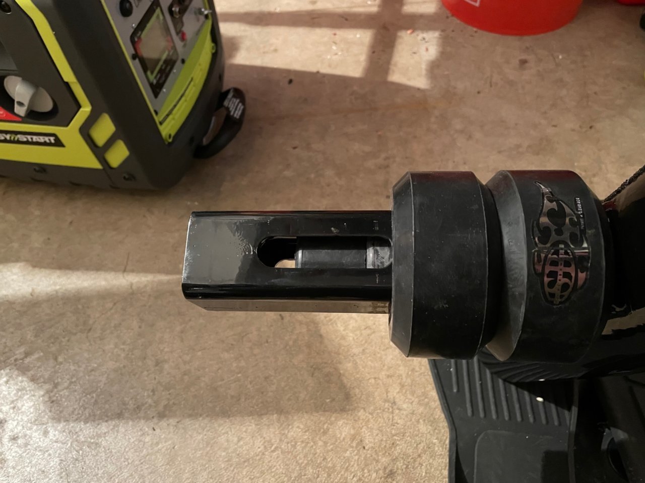

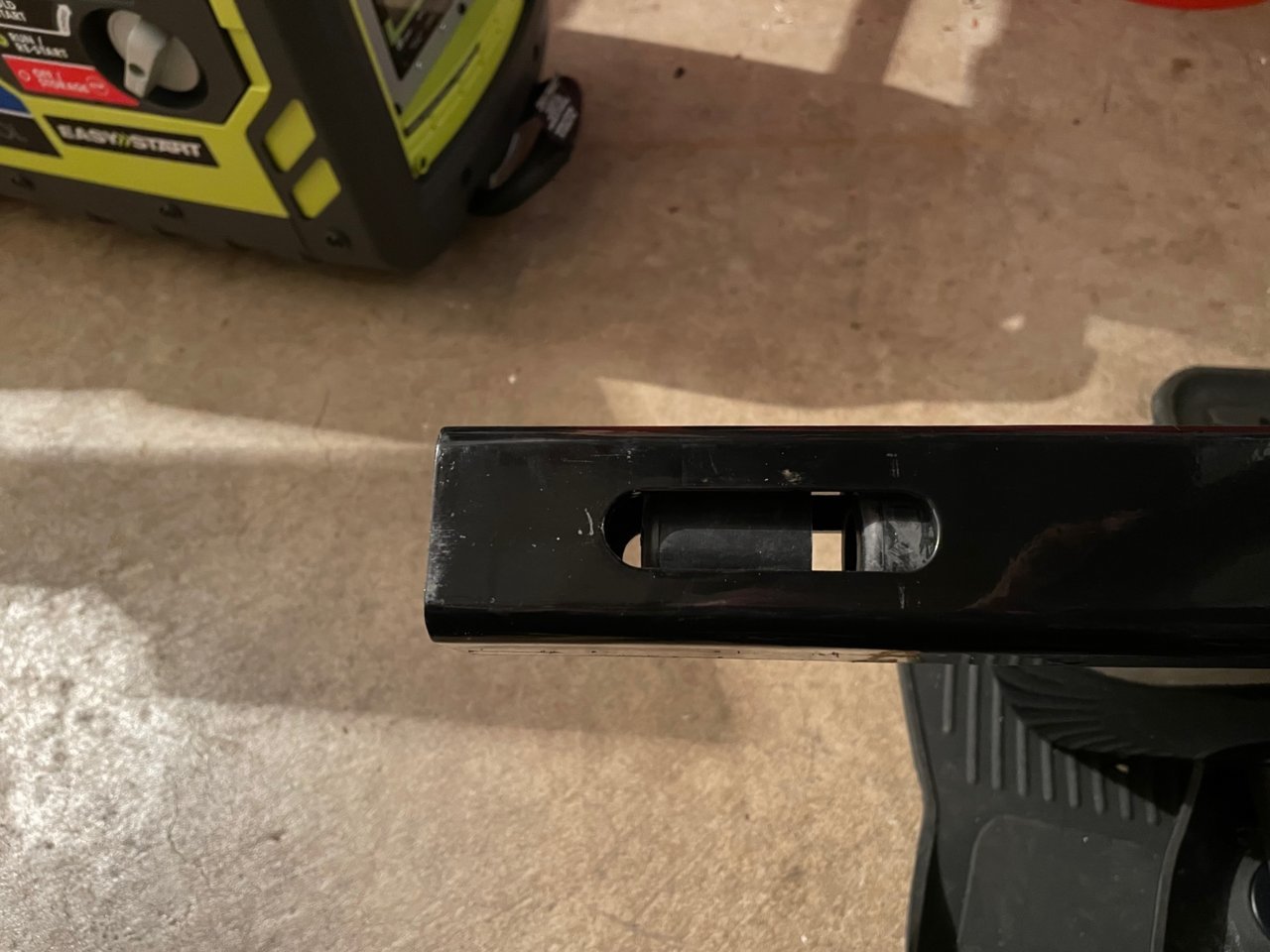

    The SB has a machined slot for the retaining pin and to compensate for any pin hole not at 2 1/2". Inside the SB there are rubber spacers to take up the slack and tighten the fit. There are two rubber compression springs and additional spacers for the outside, again, to take up the slack and ensure a tight fit. The instructions suggest adding a spacer and ratcheting the SB down so that when you add the pin and release tension, the pin will be secured by the pressure and prevent theft.
