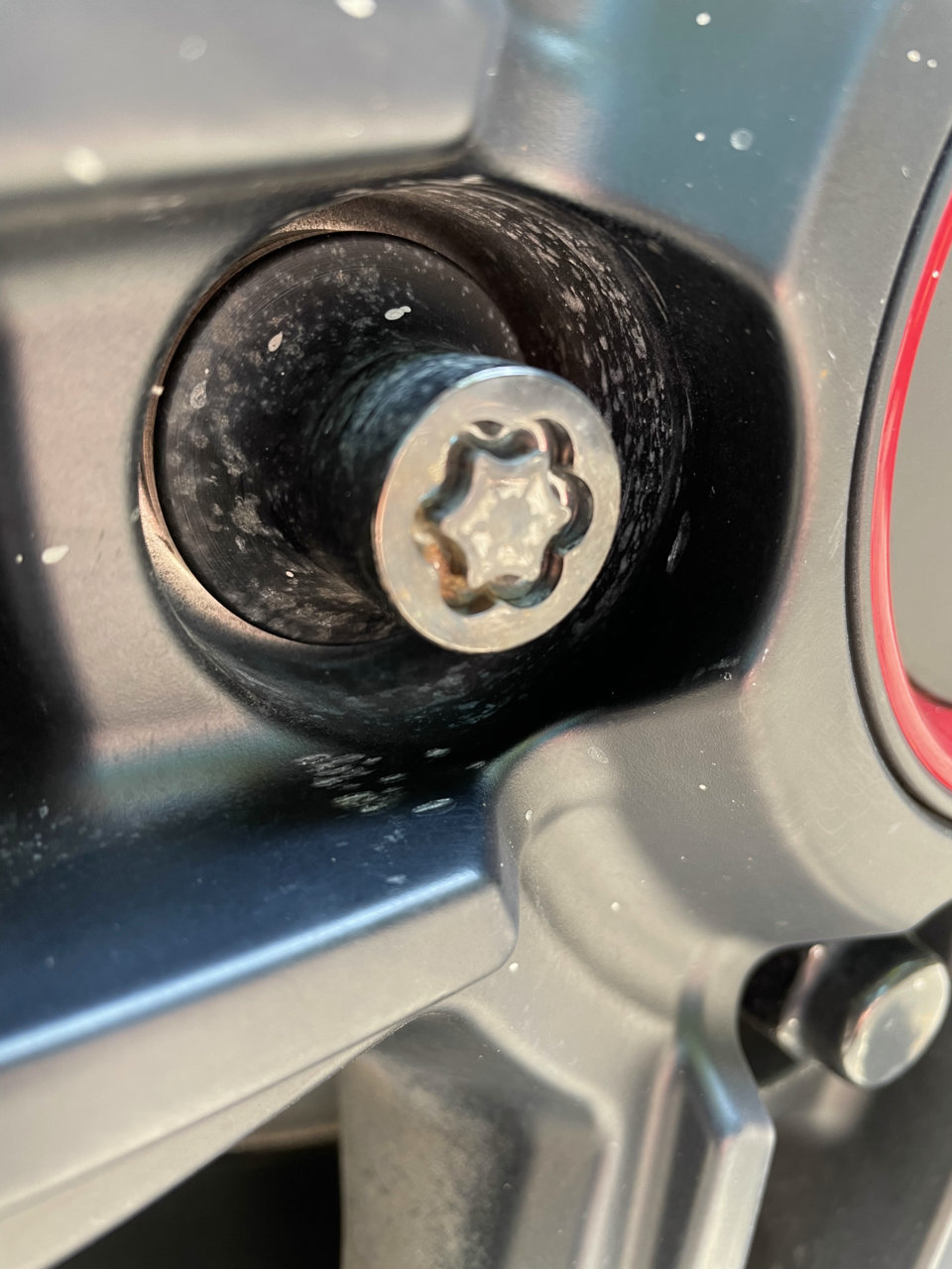

    Some word of advice on the wheel mounting. Never let any tire shop or dealership take the factory Toyota wheel locks off. If they use a rattle gun, good chance the key or lug nut splines will be damaged.
    This only sucks if you get a flat and then try and remove the wheel locks only to find out it no longer works.
    I would also find out what key it is and write that number down someplace. I have mine written under the hood of my Lexus.

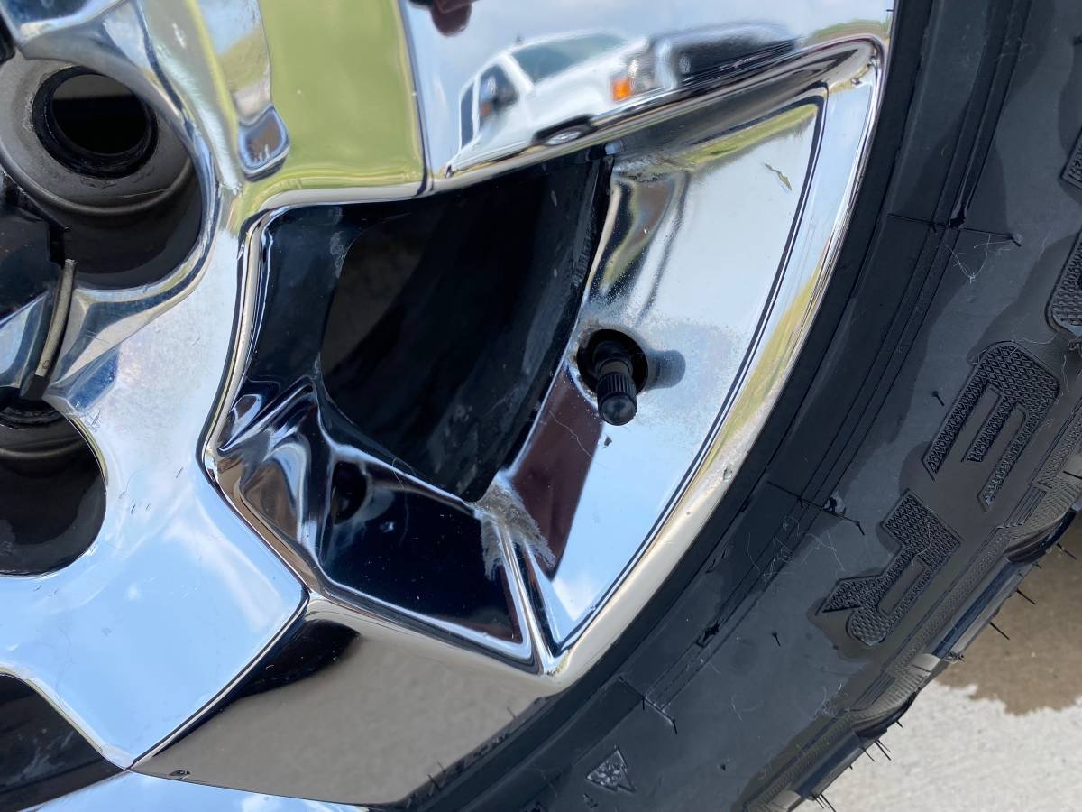

    I will not have any tire shop do my rotations or tire repair from my truck again. The wheels on my truck (2016 GMC 3500HD) were 2018 take offs and just replaced them with 2020 factory take offs. The condition of my wheels due to air gun sockets was horrible. I can't believe someone paid me 475.00 for them and worn out Coopers. So in less than three full years these wheels look pretty bad. Notice around the lug mounting area. The magnesium/chloride salt mixture in CO is hard on wheels. I spent 4 hours polishing up 4 wheels with power tools.
    With that much torque, studs get stretched and fatigued. Hell, my gooseneck trailer with 9/16 studs are 175 ft # of torque, and that is one big stud/lug nut.
