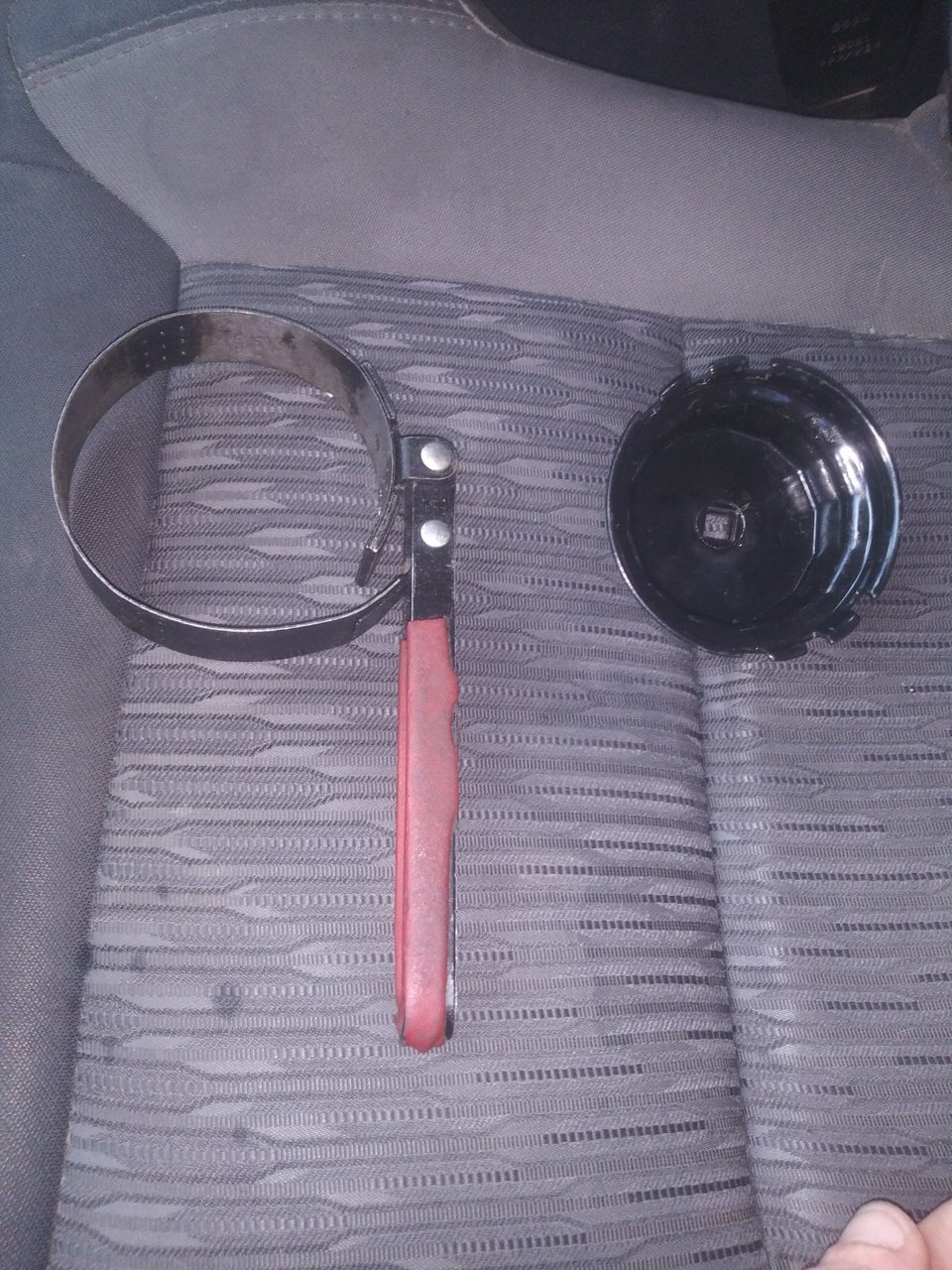

    Tried the strap wrench along with these. That socket style is the culprit and that conventional filter tool is too large

    I refered to a rubber strap wrench which is fully adjustable...
    Anyway, it looks like the regular metal removal tool should still work? If oly engaging the flats and not the ears..?
    Fairly beefy impact driver as well?

    You were right about the space. Gonna need to get it in the air. I used that cap style, it broke the ears and made the hole. The metal strap was too large

    So the removal wrench is rounding the flats on the filter housing?
    Got a picture of it?
    Maybe a more precise removal tool could have better fit?

    I cant figure which removal tool I got, but it is a simple, black painted, cast aluminum piece, with a 3/8s drive.
    If a beefy enough impact is not available, maybe a breaker bar with (light) pressure from a jack to keep your wrench seated.
    You'll get the damn thing removed and replaced with and aluminum. You'll have a beer, and laugh about the whole thing...hopefully

    When you get the replacement, be sure to swap over the perforated tube (unless yours comes with the correct size). There are a couple of tabs to bend up or down (dont remember) and then just twist out. Mine came with a little baby riser for some other engine.

    So did this dorman. Think its lexus 3.5 pickup tube.
