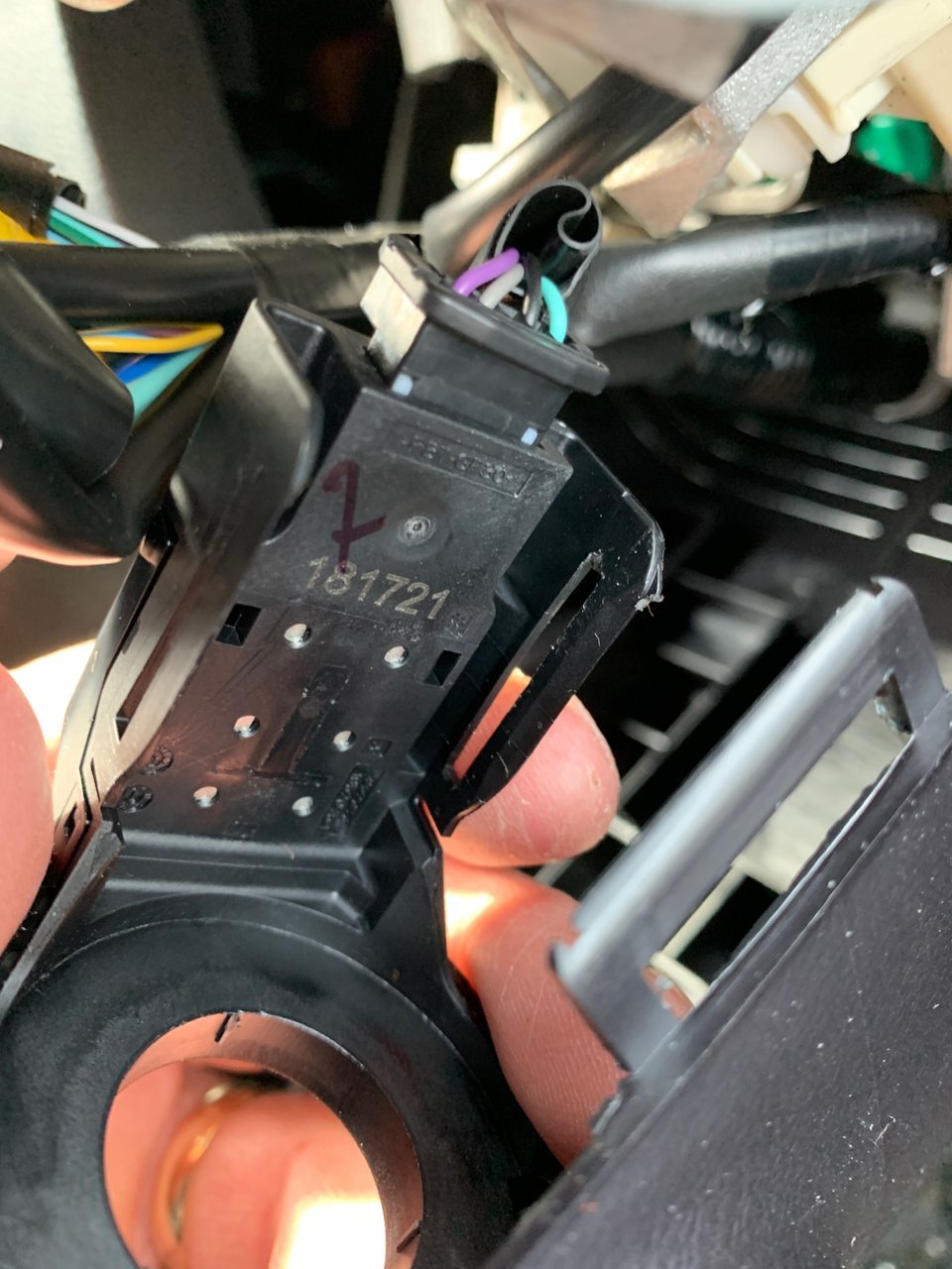

    Here's what I learned today. This applies to my 2011 and I assume it will be very similar for 2007-20017.
    The connector on the back side of the ring has seven spaces with wires in 1,4,5, and 7. The photo is upside-down, I haven't had this issue posting photos until last month. :rolleyes:
    I'm not positive, but I think that my truck has an immobilizer from the factory. I'm not sure because I have an aftermarket remote start which does, and that's what I use (I purchased the vehicle this way). None of these wires power the LED. When I apply V to the various pins of the ring/amplifier, locations 2 and 6 light up the LED. I will have to run my own wires to make this work for my truck, drag, but I've done it before. I'm just going to have to wait until I have the free time.
    So, for owners of 07-17 rides, to determine if this is likely (one-word disclaimer) to be PnP for your truck, pop off the lower cover of the steering column to check to see if there are already wires in positions 2 and 6.
    *Edit: I'm currently studying a Wiring Diagram that labels the positions of the two inboard wires as positions 4 and 5 (also with correct wire colors) rather than 3 and 4 as I had them, so I changed them to be consistent with the diagrams.

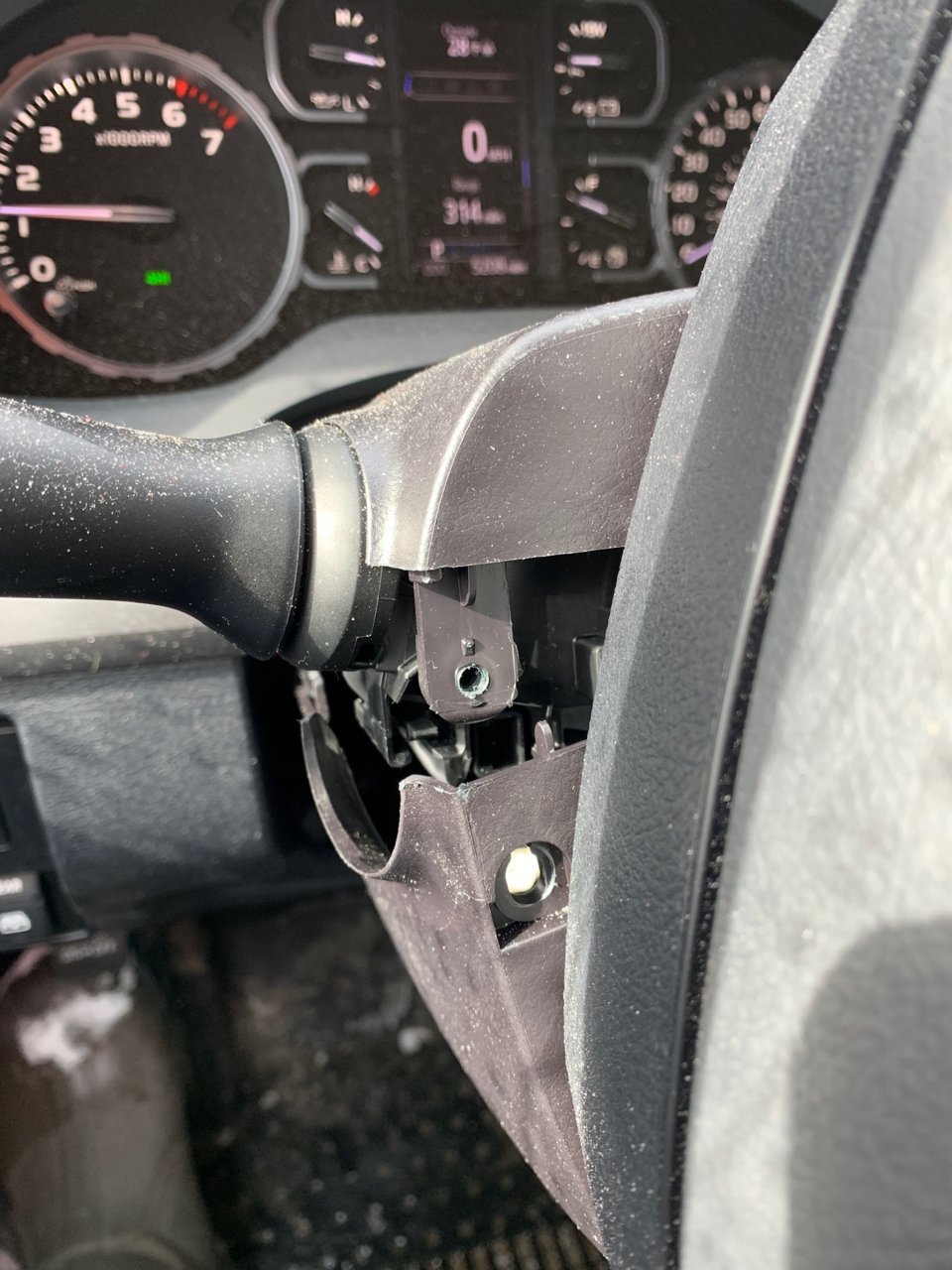

    Just installed mine- super easy and fast. Took some pics as I did it.
    Tools used:
    Remove screws from both sides of steering wheel:E1B20085-D677-423A-8372-48027FBD2319.jpg03C3AF4F-5284-4340-9DC7-C39FFD0DBA34.jpg
    Pry steering shroud apart with plastic edge or small screw driver by separating seam on both sides. Bottom drops awayA2AEA995-EF8A-43FC-913D-B4043466B1CC.jpg
    Pry around black ring gently with small screw driver until it pops off:2AE13524-5481-4771-BB6E-7C7C0C3AACA2.jpg9B6921AA-0317-4E0C-8FA2-D1794307A6A0.jpg
    Lift up on edge where wire harness snaps into ring to release 2 tiny snap locks, pull harness out.0FDFDE56-CA42-44F2-95CA-13BC59D14839.jpg
    Snap wire harness into new illuminated ringB9256898-0EEA-4AE9-B857-1F21690AE4FA.jpg
    Align and seat illuminated ring back around ignition:E7A3BF1F-B448-47FB-829C-E6AFC6E6E96B.jpg
    Test light by opening truck door:8402A3C1-C17A-457C-8C8F-E928D9825737.jpg
    Snap lower steering shroud back together with upper shroud.
    Put screws back in on each side of steering wheel.4BEFEF1E-D5CF-4B61-9BCD-0EC48CF4B6F6.jpg
