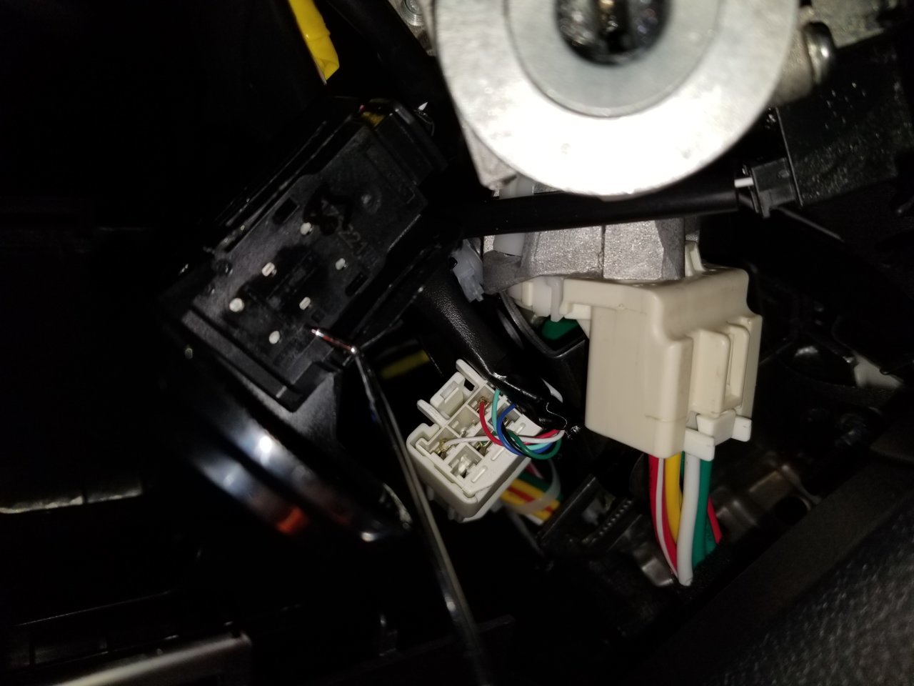

    @Jim LE 1301 Do you know how many wires are in the connector that goes to the ignition ring? I installed it on my 2018 SR5 this morning and the ring did not light up.
    ***01/29/19 EDIT
    I was wrong, there are 4 wires.

    Interesting. Mine has 2 wires (purple and green) as well but does not light up.

    Tried both the driver and passenger doors. The footwell lights up when the doors are opened but the ring does not appear to light up. Also tried it with the cabin light switch in all 3 positions but no bueno.

    Might be time to test for continuity on the device and voltage on the incoming wires.

    So here's the wierd thing. the 4 pin connector has 2 wires on pins 1 and 4. I took a 9 volt and put it on 1 and 4 but it did not light up. Reversed the polarity in case i had it incorrect but it did not light up either. Then by mistake, the probe slipped and i saw it light briefly. Applied the 9v on pins 2 and 3 and it lit up.
    So unless I'm mistaken, it looks like pins 1 and 4 power the ignition amplifier but 2 and 3 power the LED but my connector only has 2 wires. However, Jim LE 1301 said his has 2 wires and his lights up so i'm stumped.:notsure:

    I will double check tomorrow. If I get a chance I will pull it apart.
