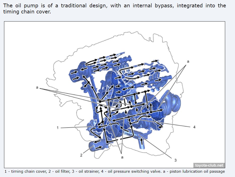

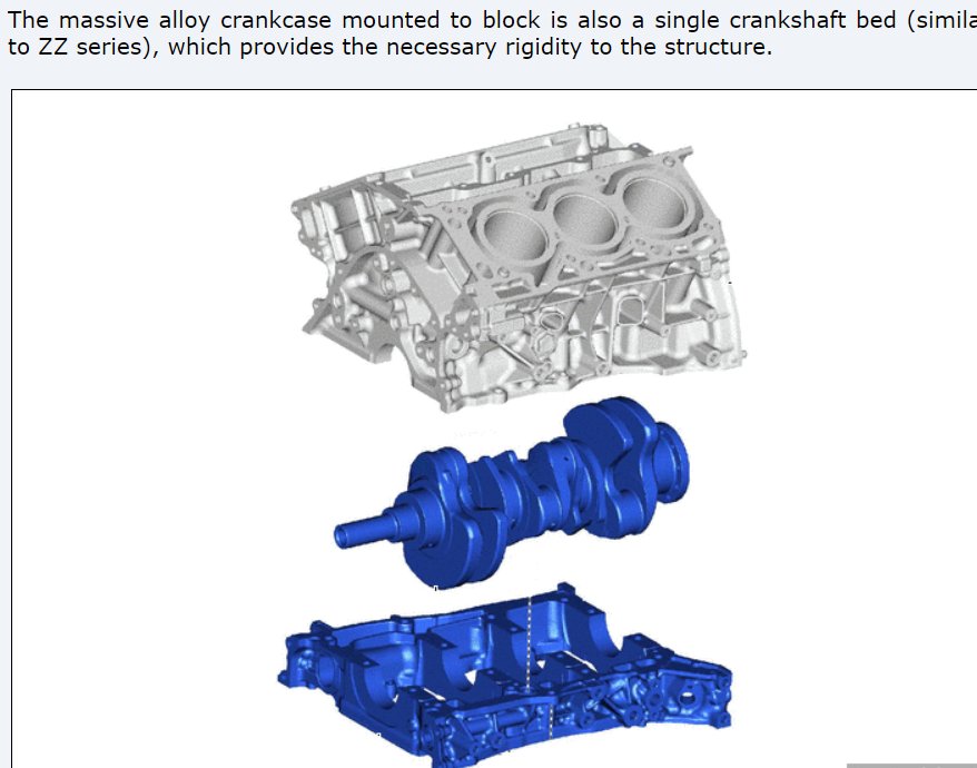

    The crank is plausible. I like that one. I still think machine debris upstream is possible too. Either debris would easily consume a bearing. My first consideration is that the crank could be an easier fix because perhaps the cranks could be isolated and perhaps the debris contained to a single place as opposed to who knows where the hell it is in motor now. Lots of perhaps but the crank seems like a good theory. Back in the day service could do bearing work at the dealer level. Due to the cost structures, I find it unlikely labor at that level would be used now. Interesting theory though.

    Don't forget the crankshaft bed. I've have no experience in this engine design, looking at diagrams, if there are oil passages it's potential also. Question is, are the crankshafts and or crankshaft beds single sourced?

    I’m starting my SWAG with the simplest answer.
    1.) What part could it originate from that is probably not made by Toyota in house? Because they will have checked over all their own stuff first because they have unfettered access.
    2.) What part is the first source of oil flow upstream from a main bearing that has oiling passages machined or drilled in it?
    3.) What is materially a possible source of hardened metal debris that can and will embed in a bearing shell?
    My first answer that most probably meets those criteria and is dirt simple is the crankshaft. At least that’s the first place I would look.

    I like this guy. He actually understands how a combustion engine works and how complicated the lubrication system is. If this #1 bearing failure is due to debris in the engine its originating from upstream of the #1 bearing, which is being exposed to the majority of the debris first. The crankshaft shaft passages is a likely bet. Combustion engines have gotten more complicated, but the basic principles still apply.
