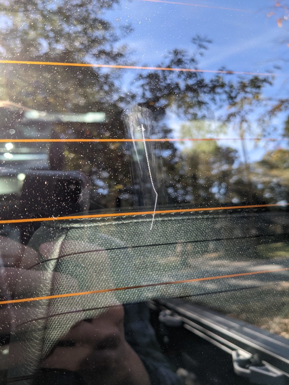

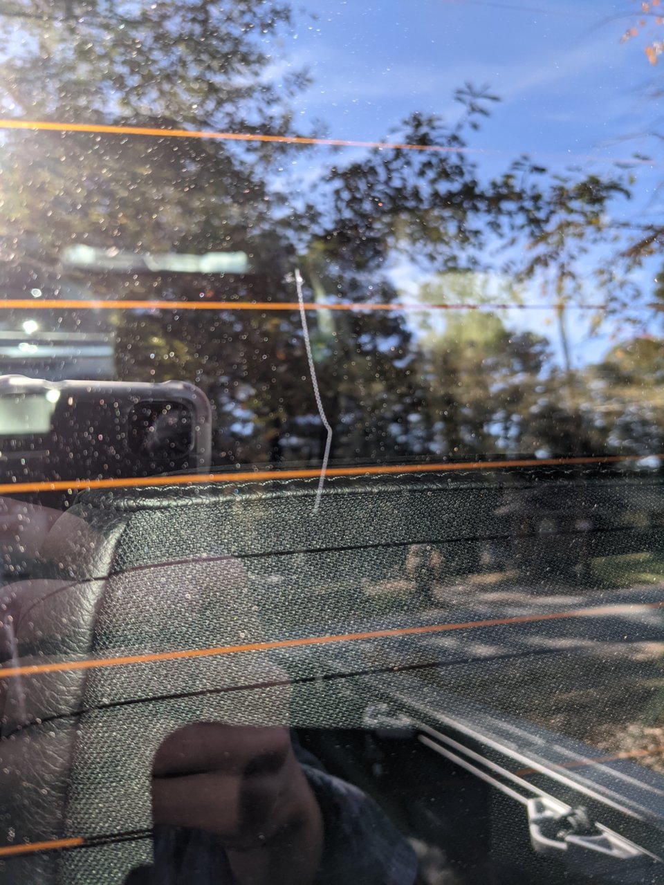

    I re-examined it and it catches my fingernail, but barely. Should I still use a glass repair compound or just try polishing it out?
