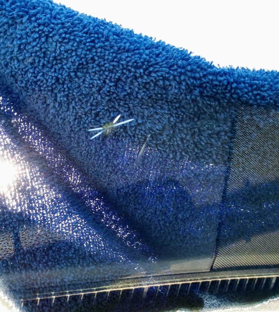

    @dessodo79 sorry to be a pest but you got any opinions on my situation? I want to try and tackle it before they spread into something bigger that I'll have to replace the whole windshield for. Post #60, last one on page 2.

    Do u have a pic of them ?

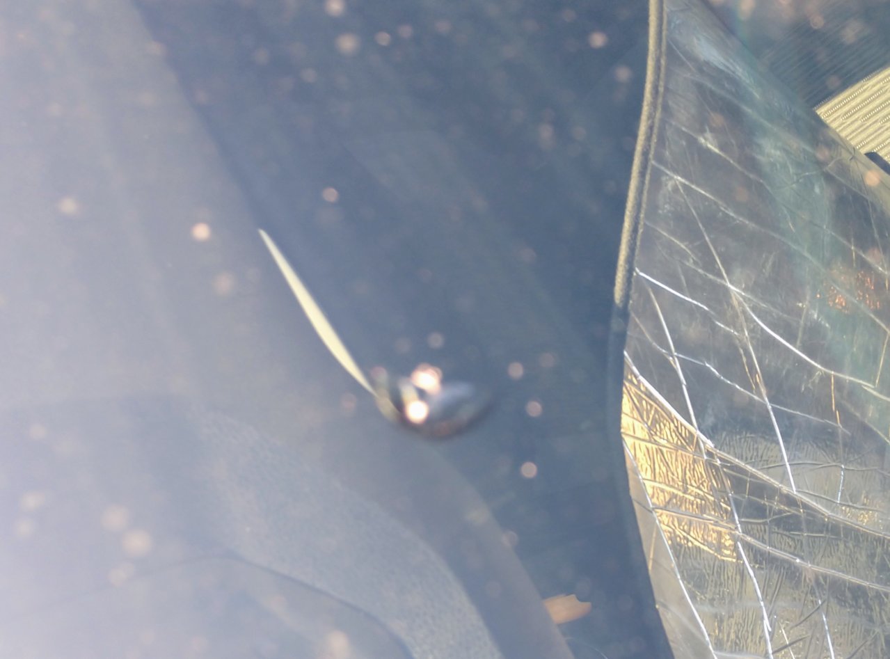

    I'll try again tomorrow with some better lighting conditions but here are some pics. Looking at them closer I realized my initial comment of their proximity was way off, they are closer to 15 inches apart not 10 sorry. 1 is shaped like a star the other like a half moon.
