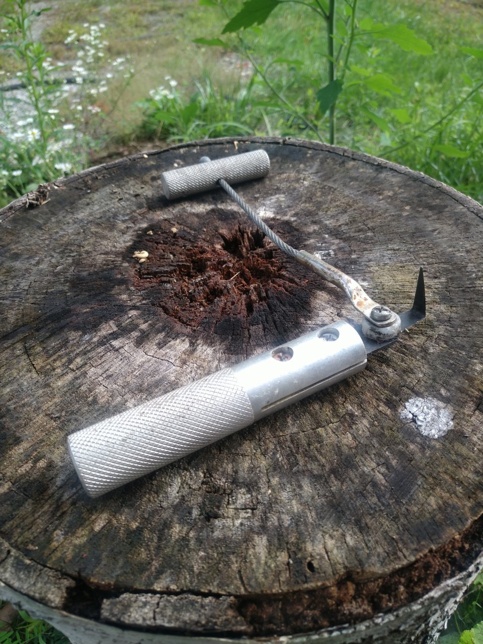

    When I used to run demo derby cars we always used this to remove the windshields. But, then again, we weren't too concerned with ever reinstalling them. Haha

    Thanks for the tip. The car is completely gutted. If it breaks, not big loss as I'm chopping the whole car up and hauling it away one way or another. But I would like to try salvaging the windshield since its so new.

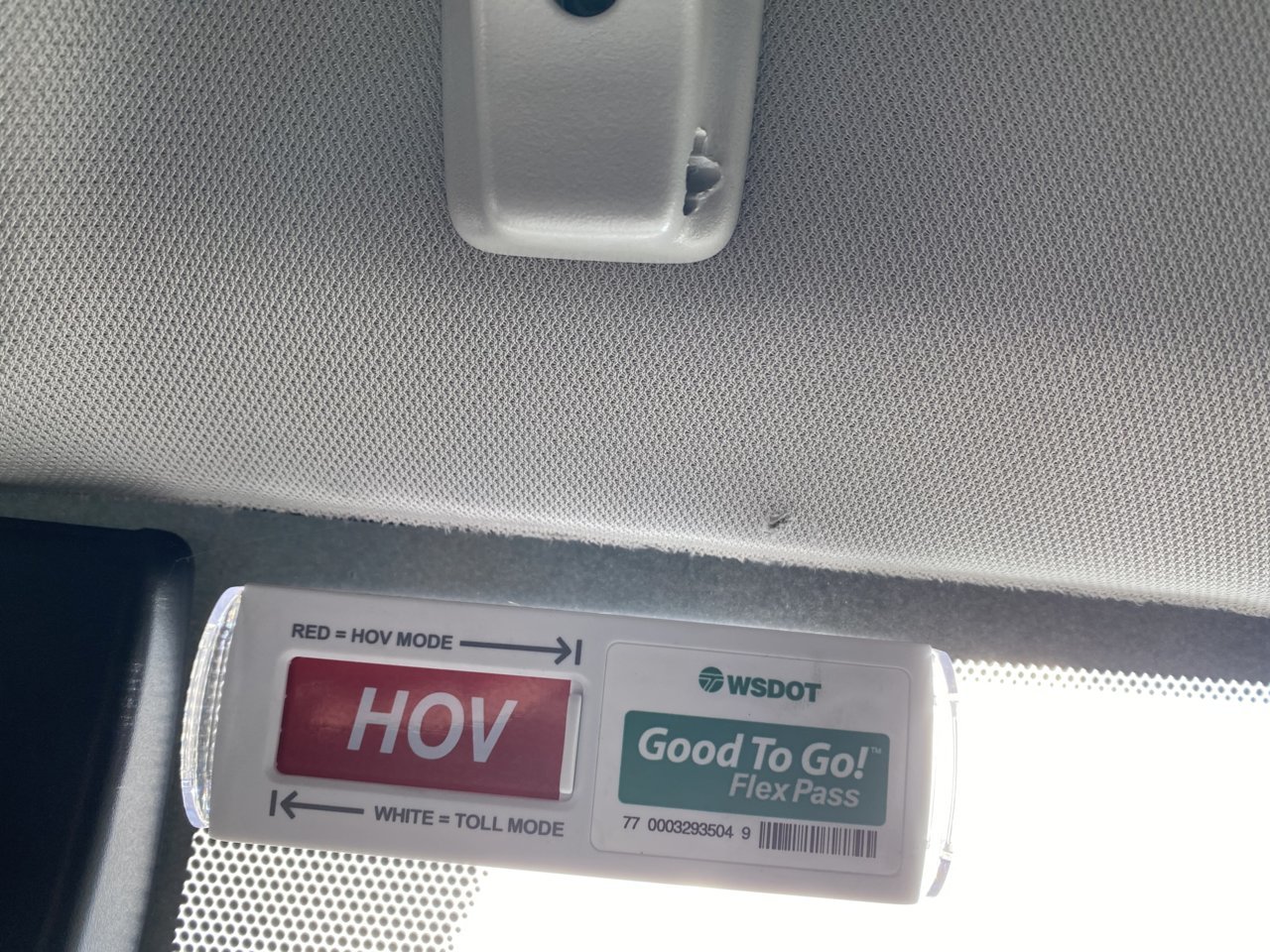

    So I had my windshield replaced by S#*£ite yesterday and they damaged my headliner, small tear near the glass. They denied it and said it was previously there. Fortunately, I was wise enough to take before photos of the inside and outside, before I left their shop when I dropped the truck off in the morning. After showing them the photos they have agreed to have an upholstery shop fix it. The options seem to be, reline the existing headliner (not too found of this) or replacing with a new headliner. It seems like a lot of work for a small tear, and I’m worried about subsequent damage due to all the disassembly and reassembly required to replace the headliner. I’m really considering just glueing it so it doesn’t get worse. What do you all think?BBED3021-C406-4250-B9D9-53E26228AE84.jpg

    Glue and see if there's some other compensatory option. I understand that headliners can be really tricky. Or ask about the shop that they want to use, talk with them and make your decision on how comfortable you are with their impression.
