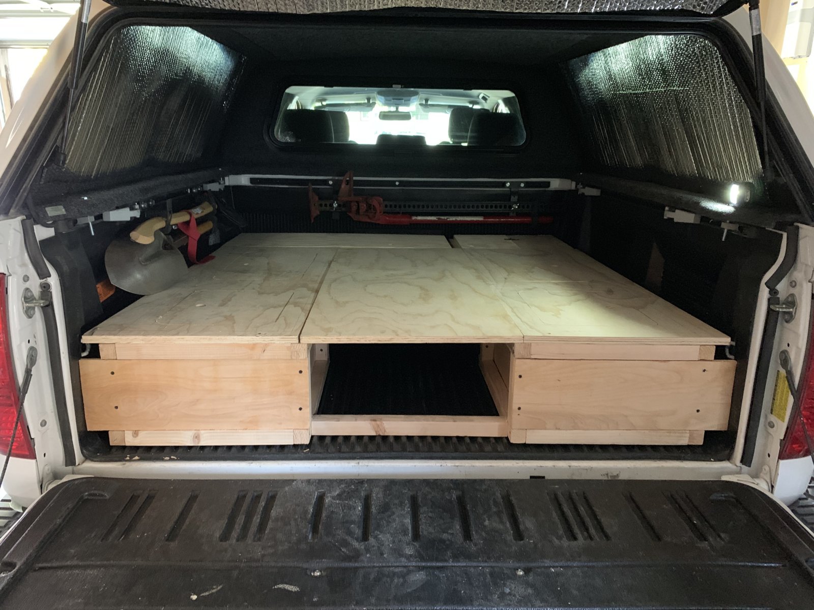

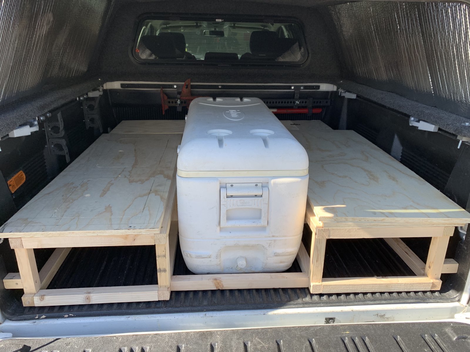

    kevine0001
    kevine0001 New Member
    Jun 17, 2019
    #32042
    740
    Kevin
    So I ended up making my own out of wood. It's a cubby system, accessed from the top. It's a horseshoe shape with the center channel covered with a piece of plywood when I need the full deck to sleep in or whatever. I remove that board and it perfectly fits my largest ice chest for fishing/hunting, without having to strap it down. Not as pretty as a Decked and not lockable but I garage my truck and it's pretty much only used for camping, hunting and fishing. Plus, I think this was under $100 total material costs (five yrs ago). Probably be about $130 for materials? 2x2 framing, one plywood sheet and some screws/nails for nail gun. The reason I mention is because that wood frame and board comes out very easily. Takes about 10 mins to take all my stuff out, and a minute to lift out the wood frame and stand it up in my garage if I ever need the bed depth. I have a shell/cap so that's also an issue, but removal is fairly easy. Been using it for about five years now, no issues.

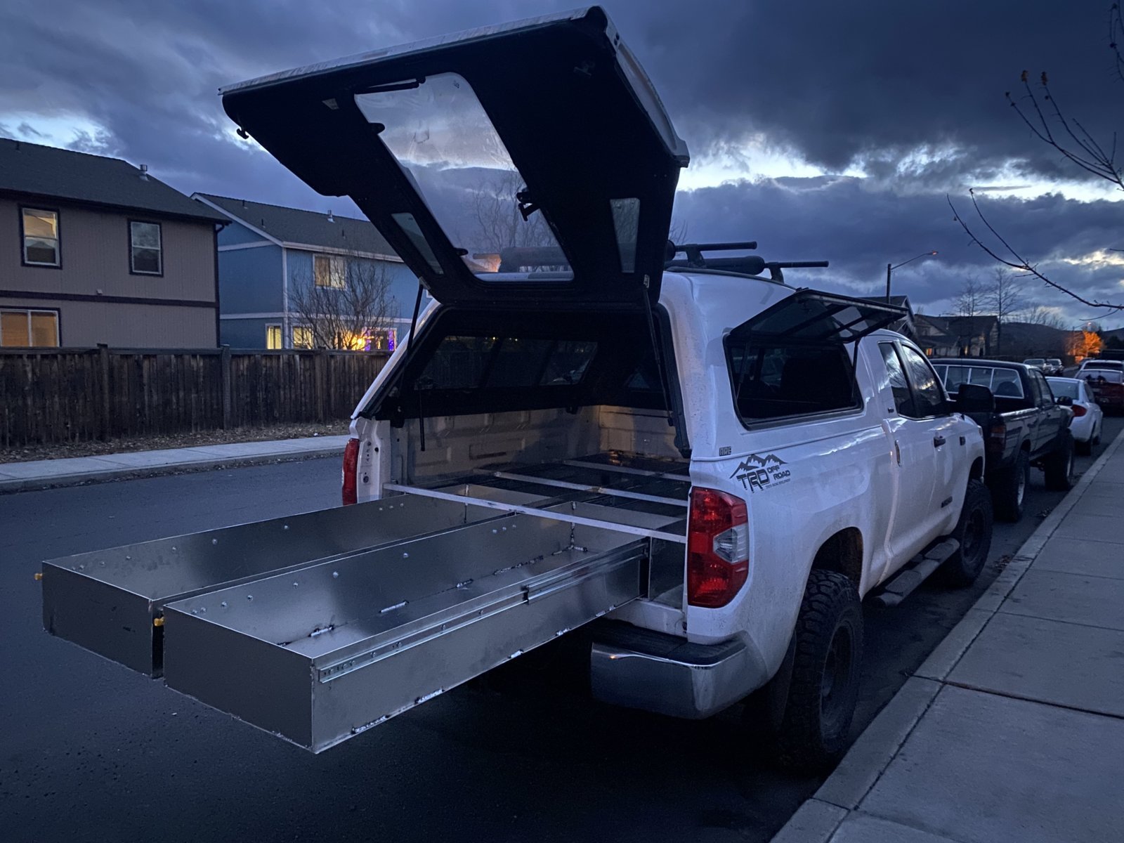

    Spaceman spiff
    Spaceman spiff New Member
    Dec 15, 2022
    #88584
    18
    2014 white DC tundra
    Built these from aluminum using 500lb drawer slides. Actually going a different route so if anyone in Oregon wants to buy em let me know
