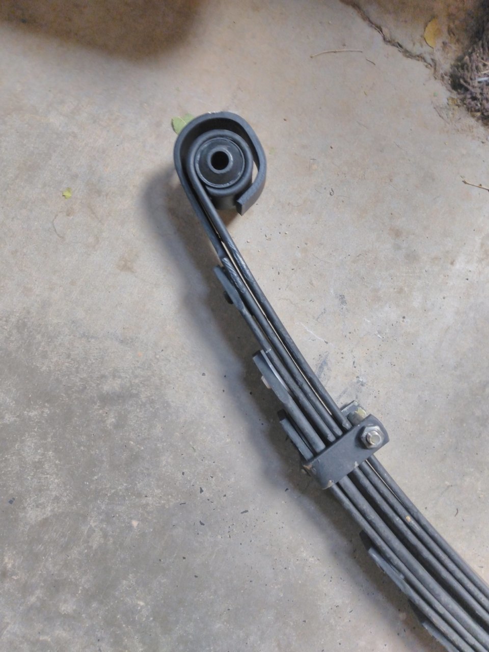

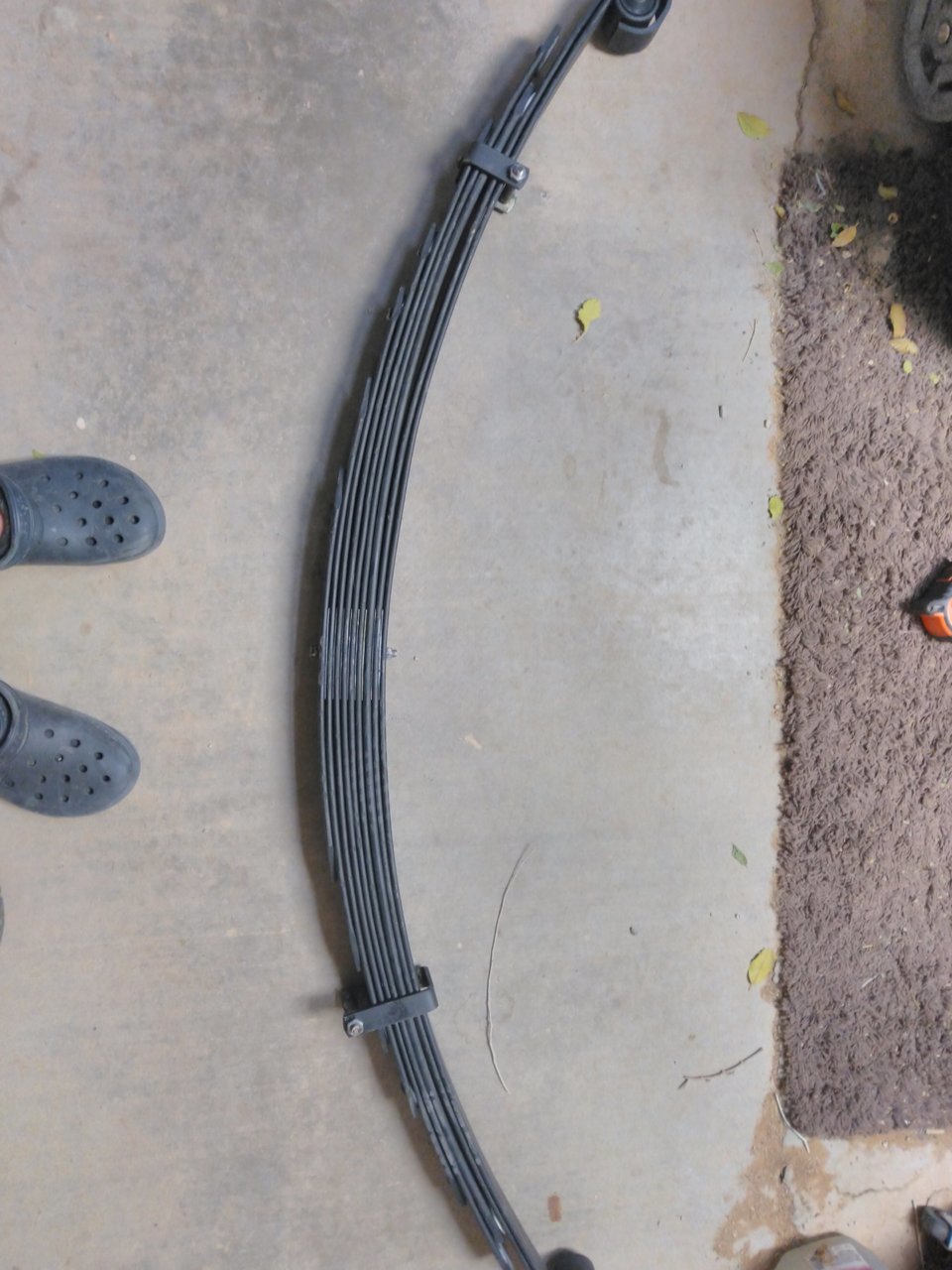

    Guys/gals running the RXT pack in option 3, does this look right?
    Icon states, add leaf between #2&#3 leafs counting down.
    Fits great between leafs #3&#4 but doesn't appear to arch the pack enough.
    :monocle:
    Edit this is what I'm going with, between#3/#4

    This is leaf #1
    What you have as between #3 and #4 is actually between #2 and #3, which is correct.
    Less of arch as that add a leaf is much thicker.
    B.Ross[QUOTED] likes this.
