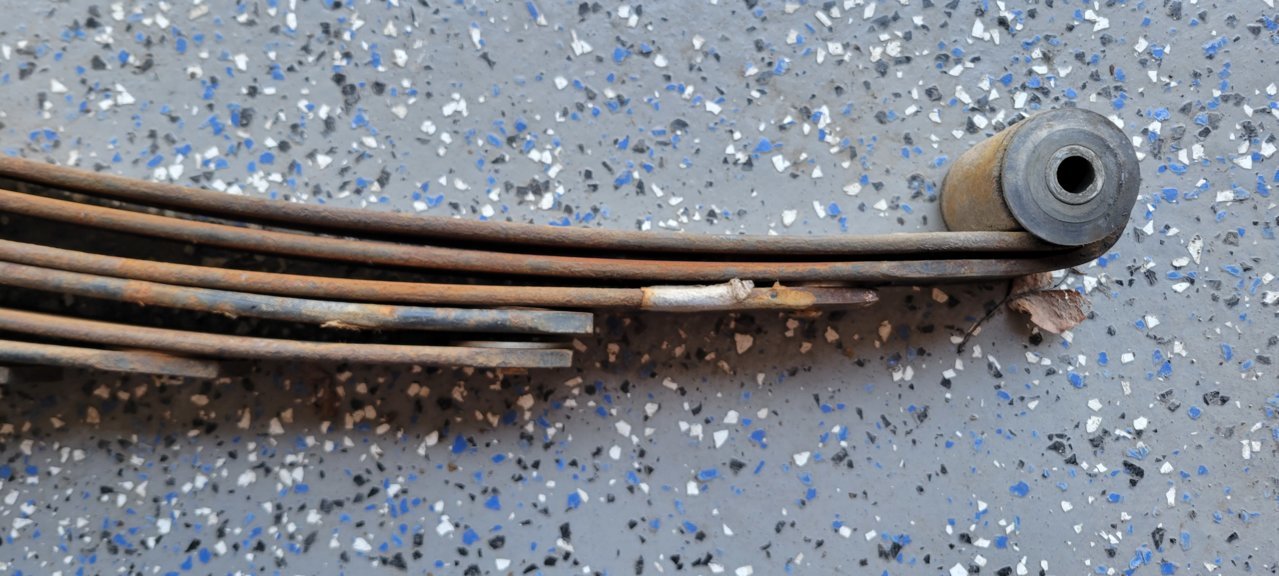

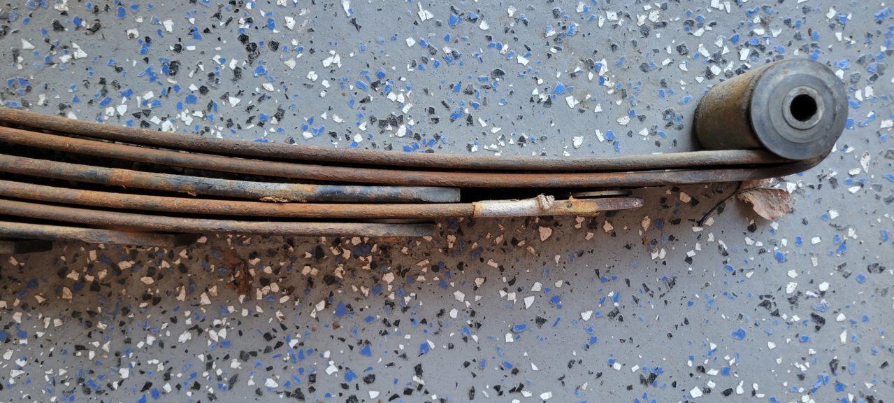

    Now that I’ve looked at the pack in my garage, your right about option 3. Placing the add a leaf in between 2 & 3 does have disproportionate leaf length top to bottom.
    Any word from Icon? How has your ride been placing the leafs in the order in which you felt was correct?
    @SAGE63 or @Weavin Pro Could either of you guys maybe post a pick of your option 3 leaf set ups?

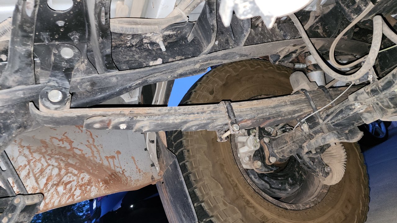

    Here is mine. pretty dirty from T2S
