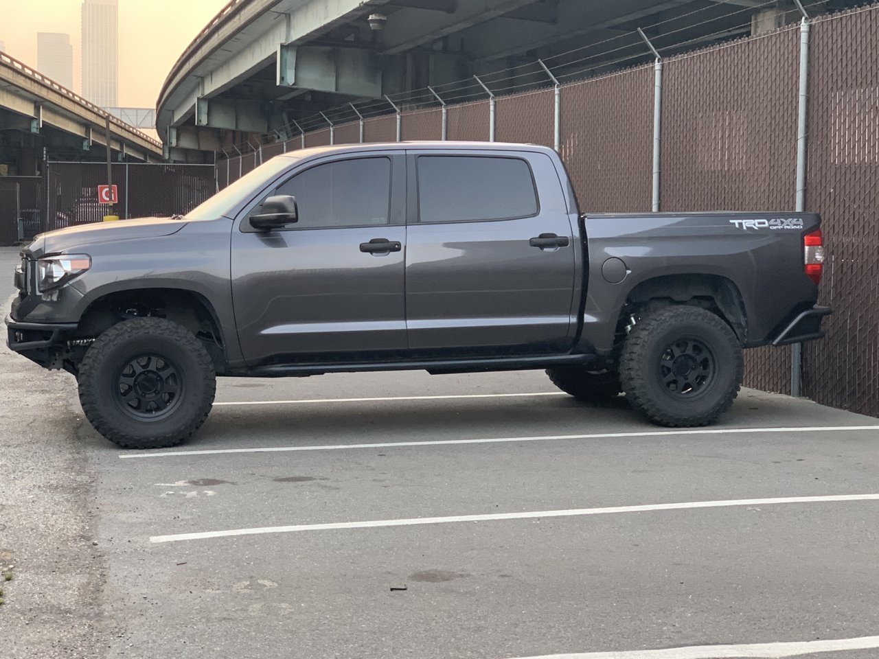

  3. Dec 8, 2020 at 7:47 PM
    #33

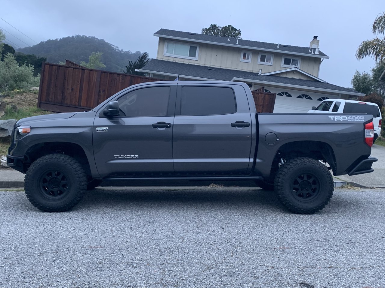

    8FF48217-250A-45ED-9837-8CFE6AC02DF0.jpg Option 2 after about a year and half. I constantly max my payload with work and they haven’t sagged too much. Usually have 2-40lbs in it. They don’t squeak too bad and yes you can drive through speed bumps not over them lol.

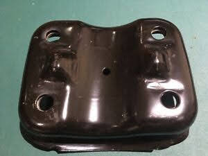

    I am in the process of getting these installed and have a question. Is there a certain way the u-bolt spring seats go? I know one is left and right, but where the axle sits, there is a slight angle on the seat. I should have marked them, but of course I didn't. Anyone got a photo or mind taking a photo of theirs?
    *EDIT* I think I figured it out, where LH and RH are stamped on the bottom of the seats, the stamps should be on the outside.

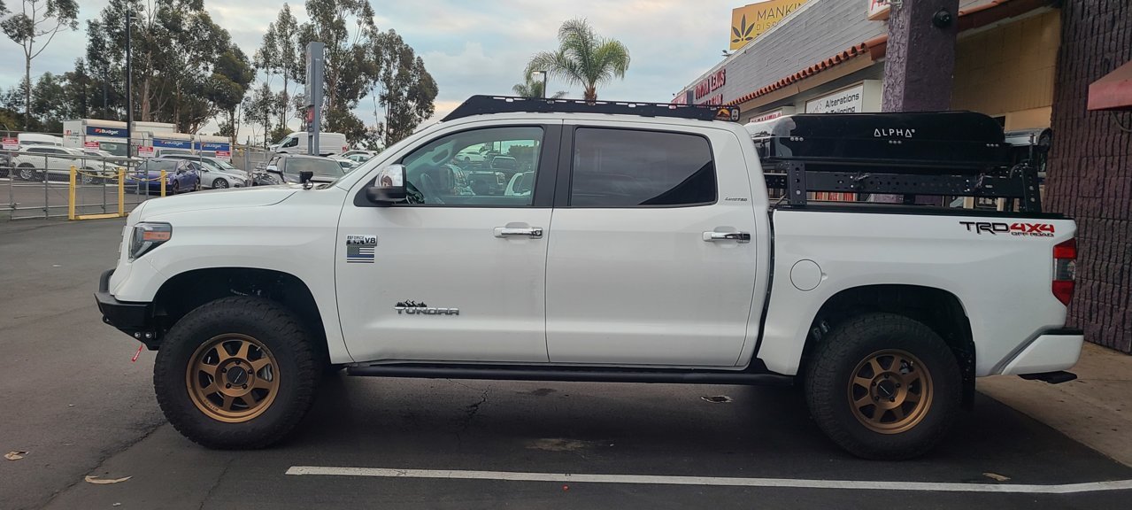

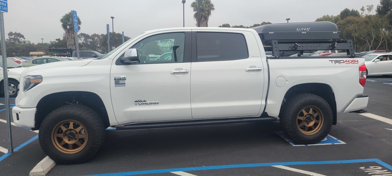

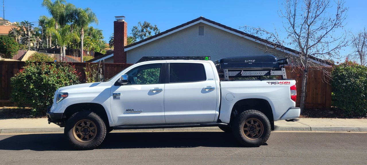

    Ok here is the before and after ICON RXT leafs at option 3 with +3 coachbuilder shackles vs stock springs with +3 coachbuilder shackles. There is appx 500lbs in load weight in both views
    Before
    After
  29. Feb 2, 2022 at 1:32 PM

    I do not have before measurements with the C4 bumper, Winch or the roof rack. Will get current measurements tomorrow if I remember to...
    tires are Toyo Open Country AT II 295/70/r18 wheel offset is +25 appx 20k miles on the tires
    before bumper/roofrack and ICON measure was 25.5 all around before stock leafs began to sag.20210726_145413.jpg
