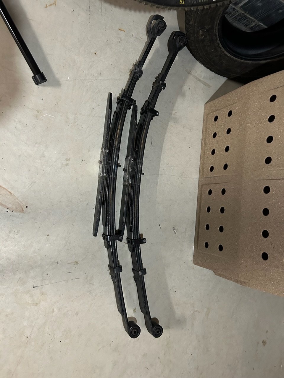

    Yup I couldn’t take it anymore after so many tries to fix it. I just purchased a Toytec mini pack by deaver. We’ll see….

    Just tried the inner tube fix, soaked each piece of tube with a silicone spray and put them in. So far no squeaks. Hopefully it lasts...

    Well that was short lived. Squeaking is back. Last just a few days using the inner tube method….bummer.

    While assembling my RXT leaf pack for option #3, I shot lithium grease between all the leafs/ brass anti squeak plates.
    Been squeak free ever since.

    I think the brass shims are they key. Had I caught wind of all these squeak issues, I would have disassembled my dobinsons and installed shims in the centers and pads on the end of all leaves.

    The plates were there from the factory( Icon)

    I used to spray mine with motorcycle chain oil. Wouldn’t squeak until I got dirt on them offroad. Hose them down with water and the squeak would go away.

    Okay, so my latest on this. I went under the truck and took a look at everything. Shackles did not look over torqued at all but I still re-torqued. I then went to the frame mount for the leaf spring towards the front of the truck and they seemed much tighter than the rear. I looked up the torque specs and found 77ft lbs for both the front and rear? So I torqued the front to that, loaded it up with silicon spray all round the outside of the bushing and no more squeak. Like it’s eerily quiet. I think I’ve gotten so used to that sound it almost seems foreign. Regardless though I vaguely remember icon directions saying to torque the front much more than 77. So far so good though.
