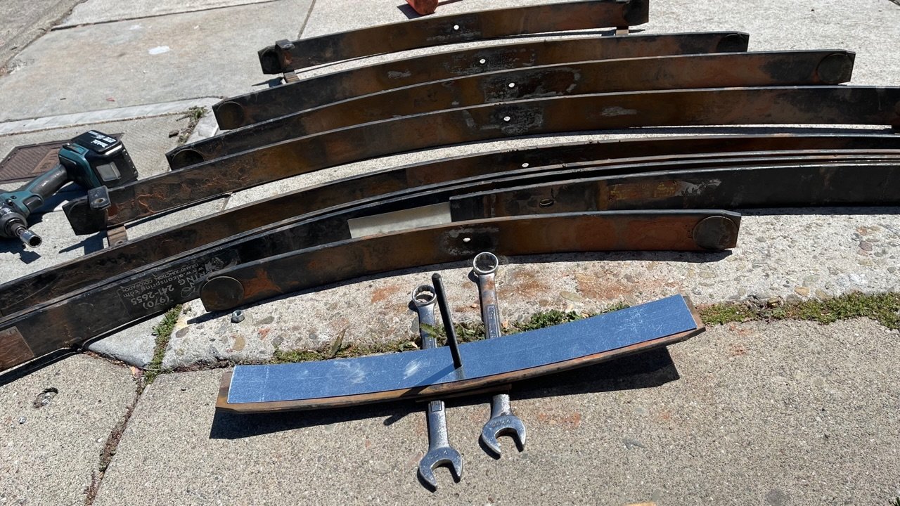

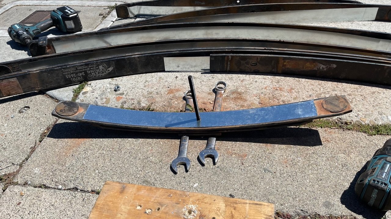

    Here are 2” wide sheet metal strips that I layered in between each leaf.

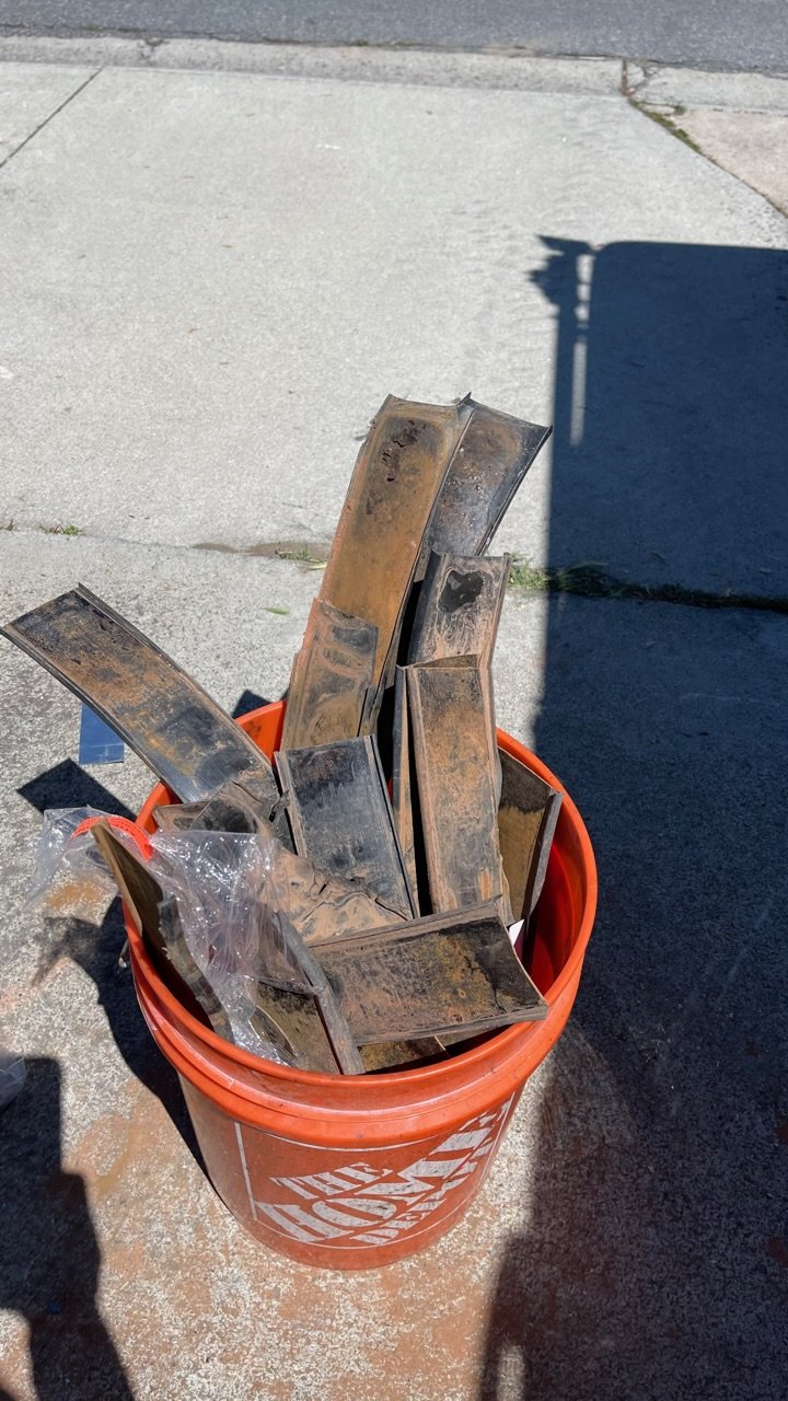

    And here’s the rubber strips I threw away

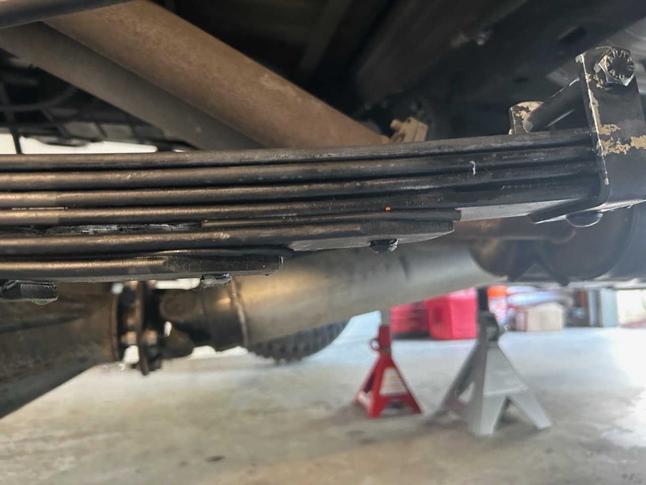

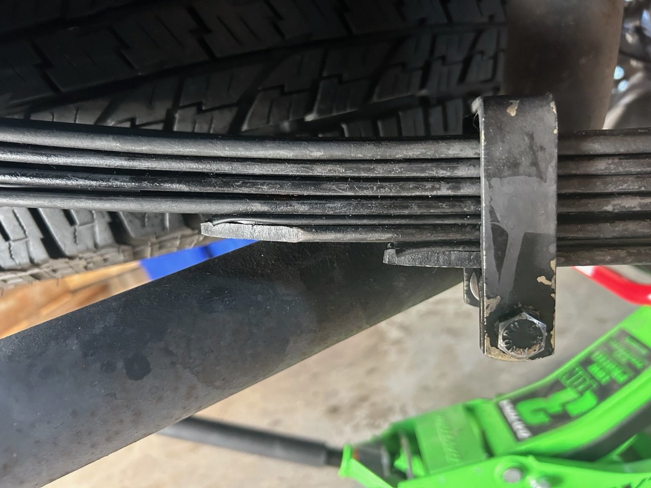

    My RXTs had shorter "leaf shims" about 6" long between most of the leaves but not all for some reason (used unknown history) I added galvanized sheet metal shims between every leaf and it helped immensely. If you research leaf shims they're supposed to be brass. Plus some plastic plugs at each leaf tip to quiet them down. If I were to do it again I'd do brass shims and the inner tube tips and just service the tips as needed.

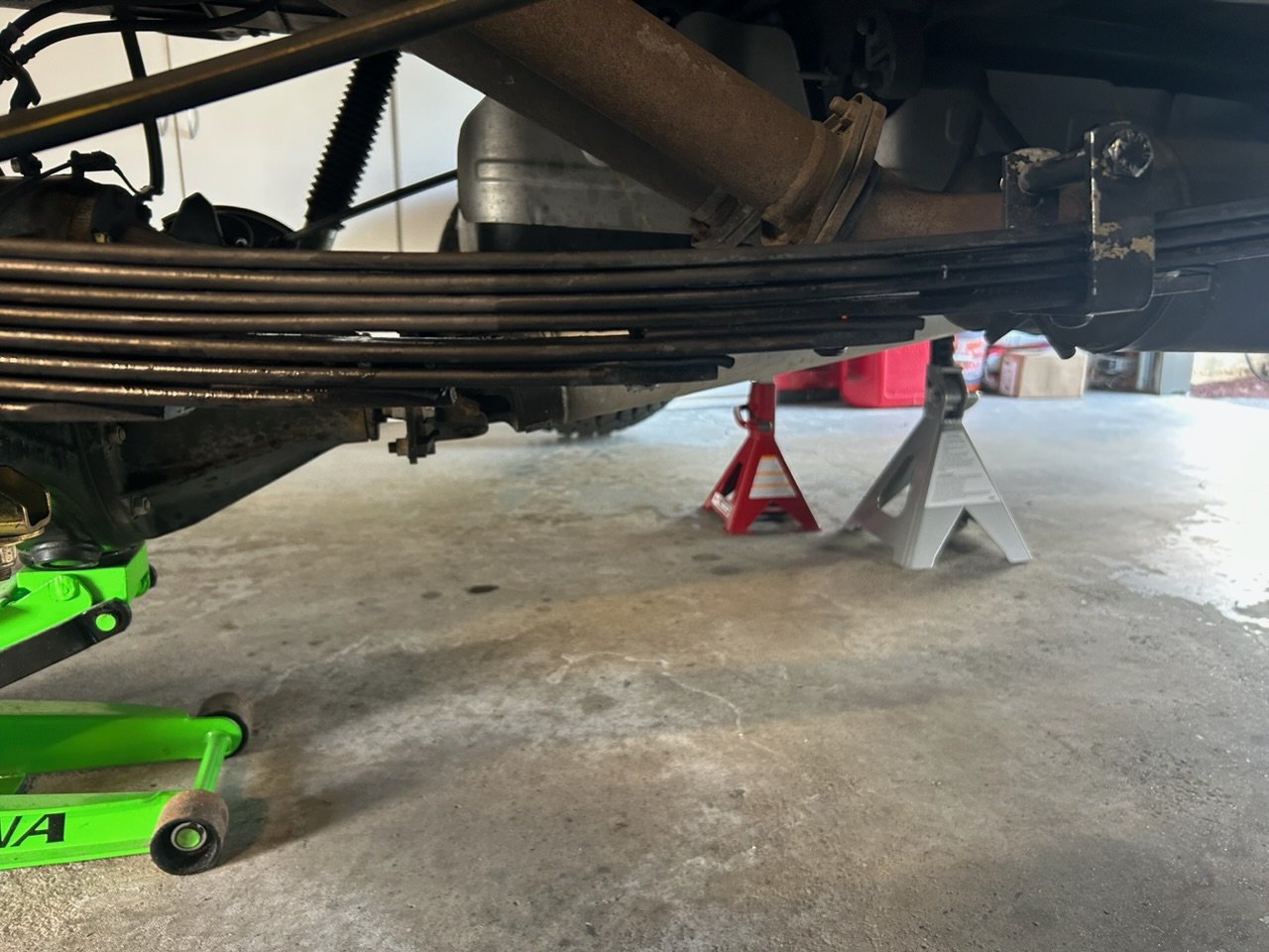

    @memario1214 inner tube fix works a champ. Now, I have low droop springs and they spread a bunch, so after a hard day run, My inner tubes are all over the place - still sounds good, lol. I'm gonna unbolt shocks and limit straps run full droop and clean the shit out of the leafs. and once I have them all super nice, I'm putting inner tube back in there.
