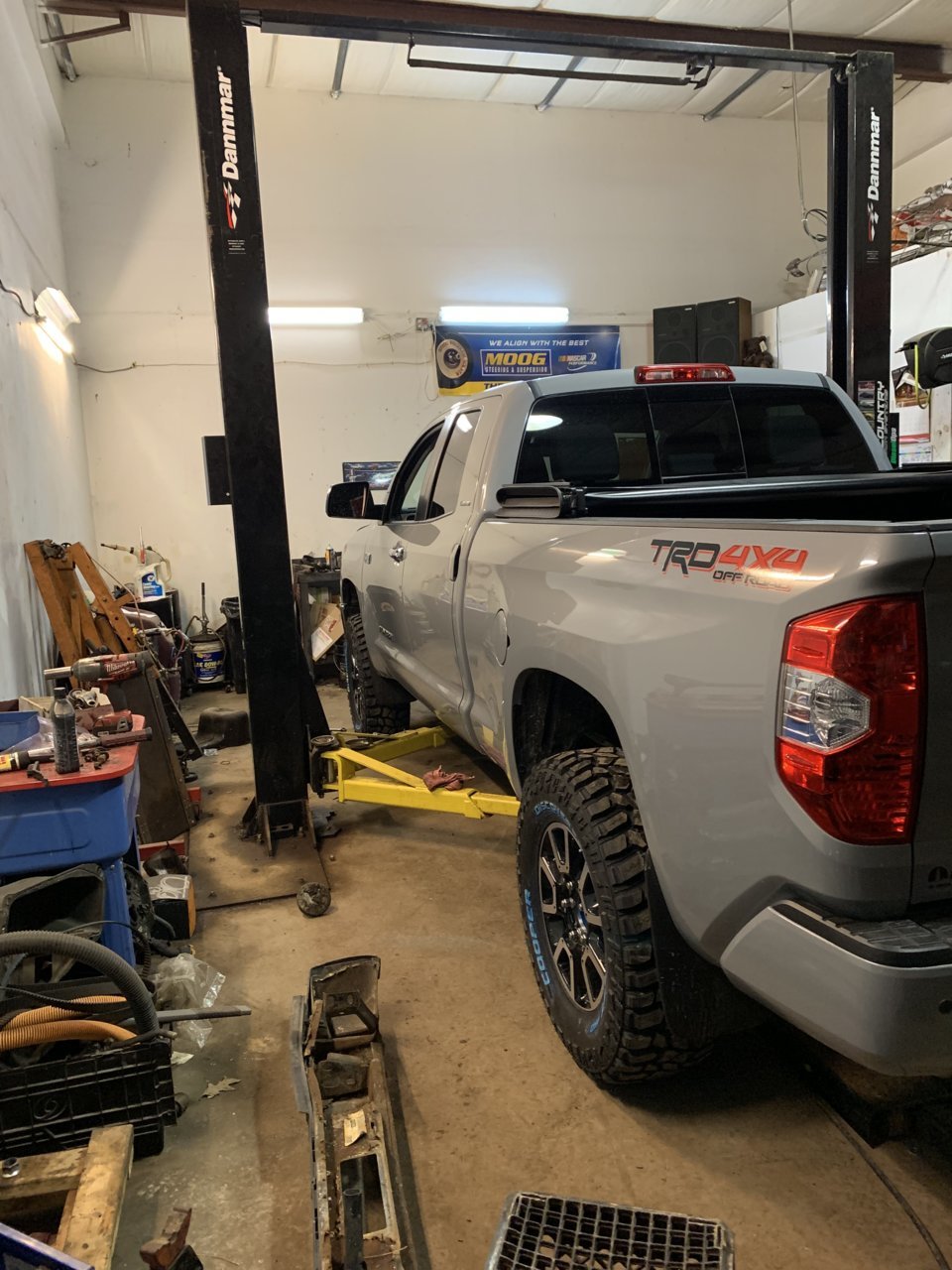

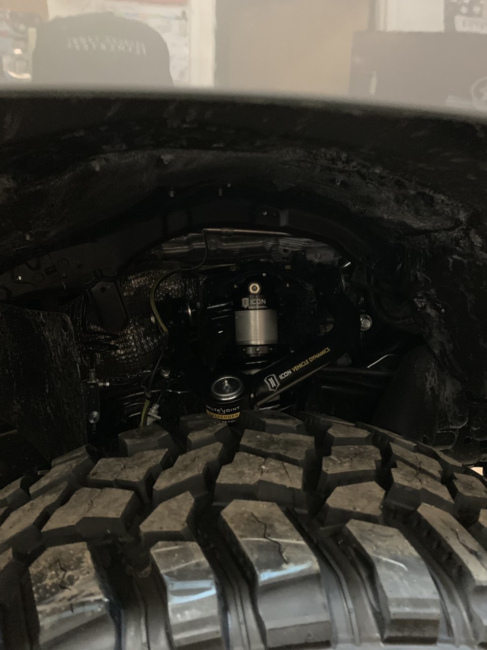

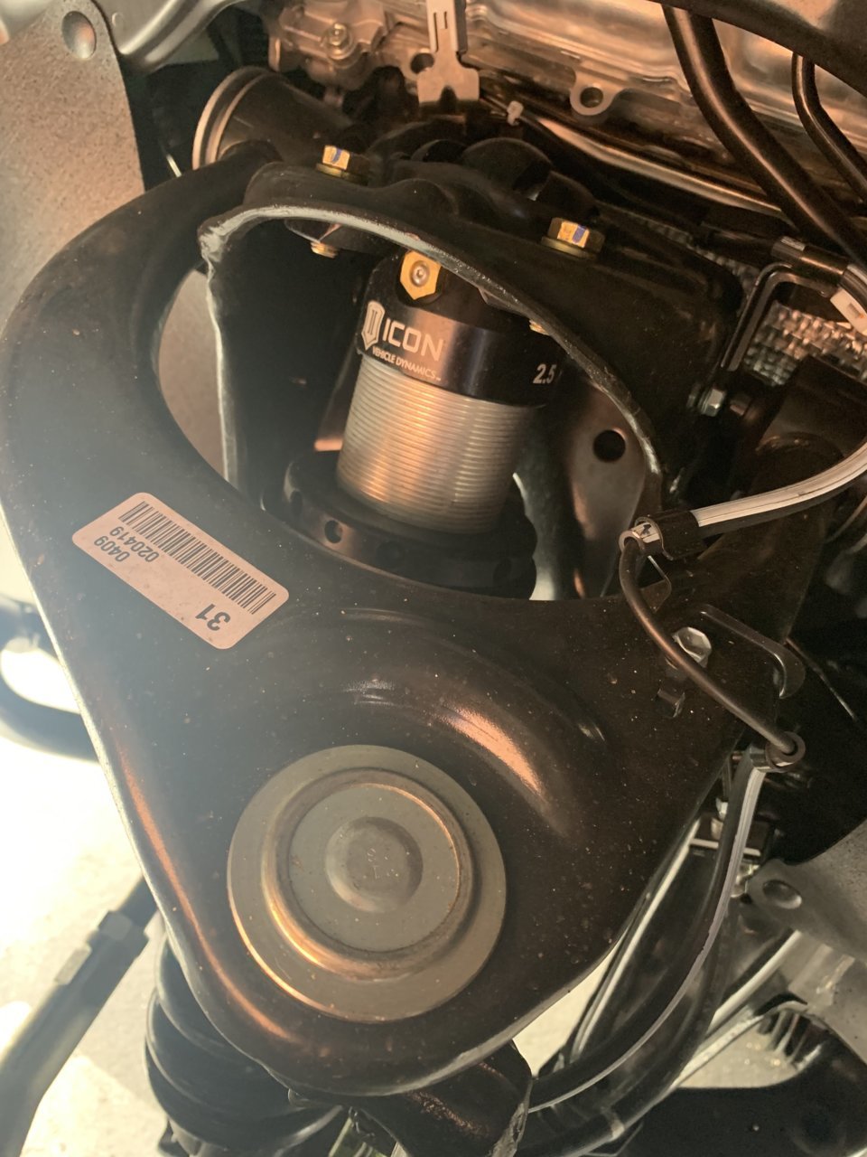

    hey there! Just installed some 2.5’s. I read somewhere that I should give the coilovers 4 full turns prior to install. She’s sitting a little high up front. Anyone with experience with icon care to chime in. It was my understanding these give you 2.5” in height out of the box (I know they’re also a 2.5” body) and 1/4” of thread= 1/2” of lift. Does this hold true? 1.5” icon aal in rear.
    Zoom on second you can see how much I moved the collar.
    Thanks again tundras.com community for such a great resource

    Max preload is 2” of thread space. Measure from start of threads to collar. Anything past that voids their warranty. They are supposed to be 2.5” out of the box.

    I have a 700lb spring on mine. The 2” of thread space got me 4.25” of lift.

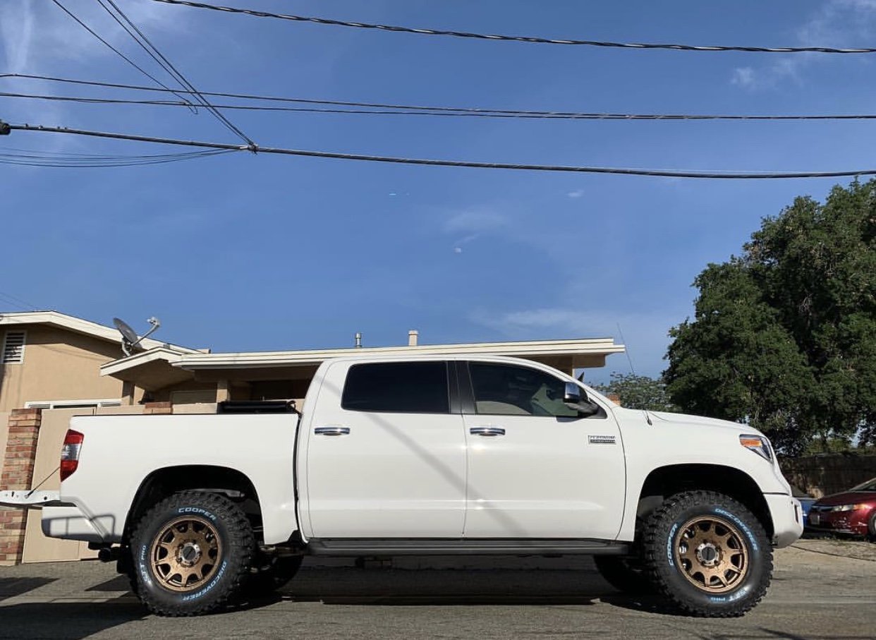

    Do you have a pic? I've just ordered the 2.5 coilovers with cdcv and RR, and stated that gives up to 3.5 inches lift? I have no weight on the front end - all stock. I like the sound of 4.25 inches of lift up front.but if I get just above 3 I will be happy

    Technically you are only supposed to have 1” of thread with the 700lb springs instead of 2” with the 600’s. Shop originally set it up like the 600lb instructions said. So yes you will get over 4” of lift but you risk the coils binding.
