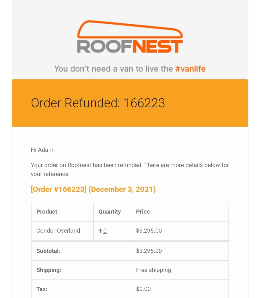

    Got an email and notification that they issued a refund.
    Email did say 1-3 business days to hit my account. I'll be pestering my CC company now.

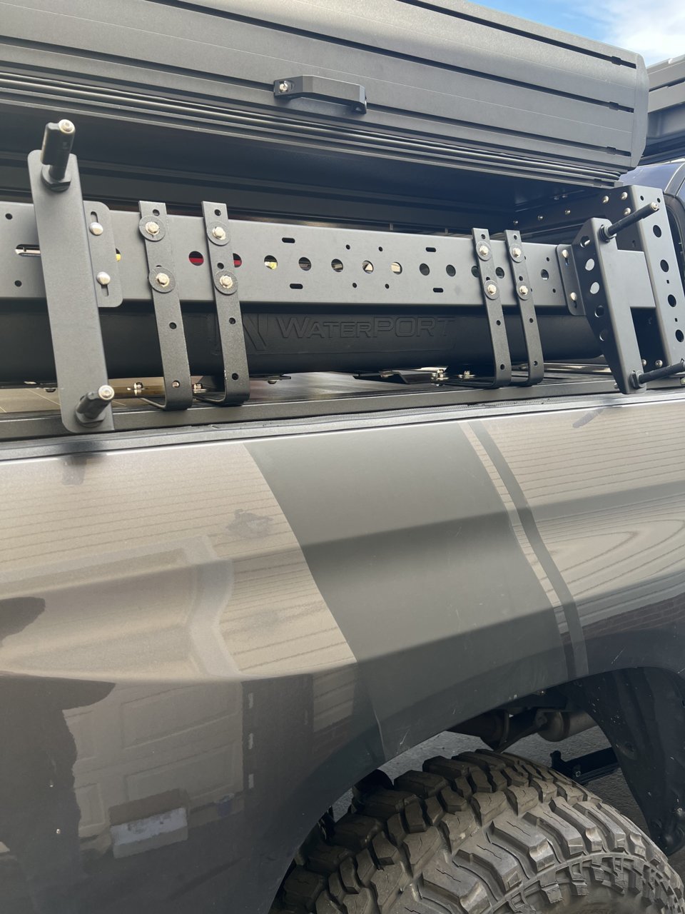

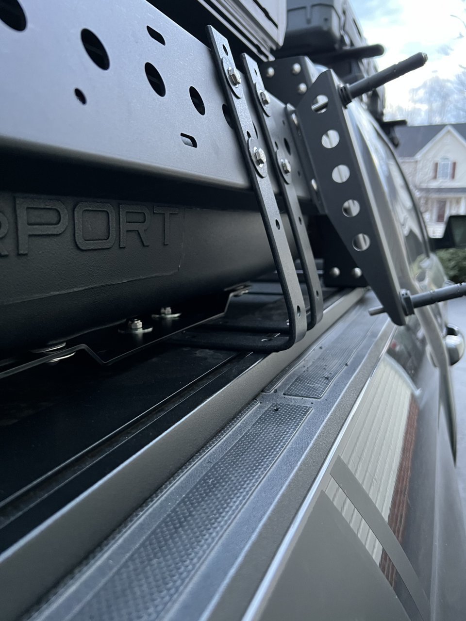

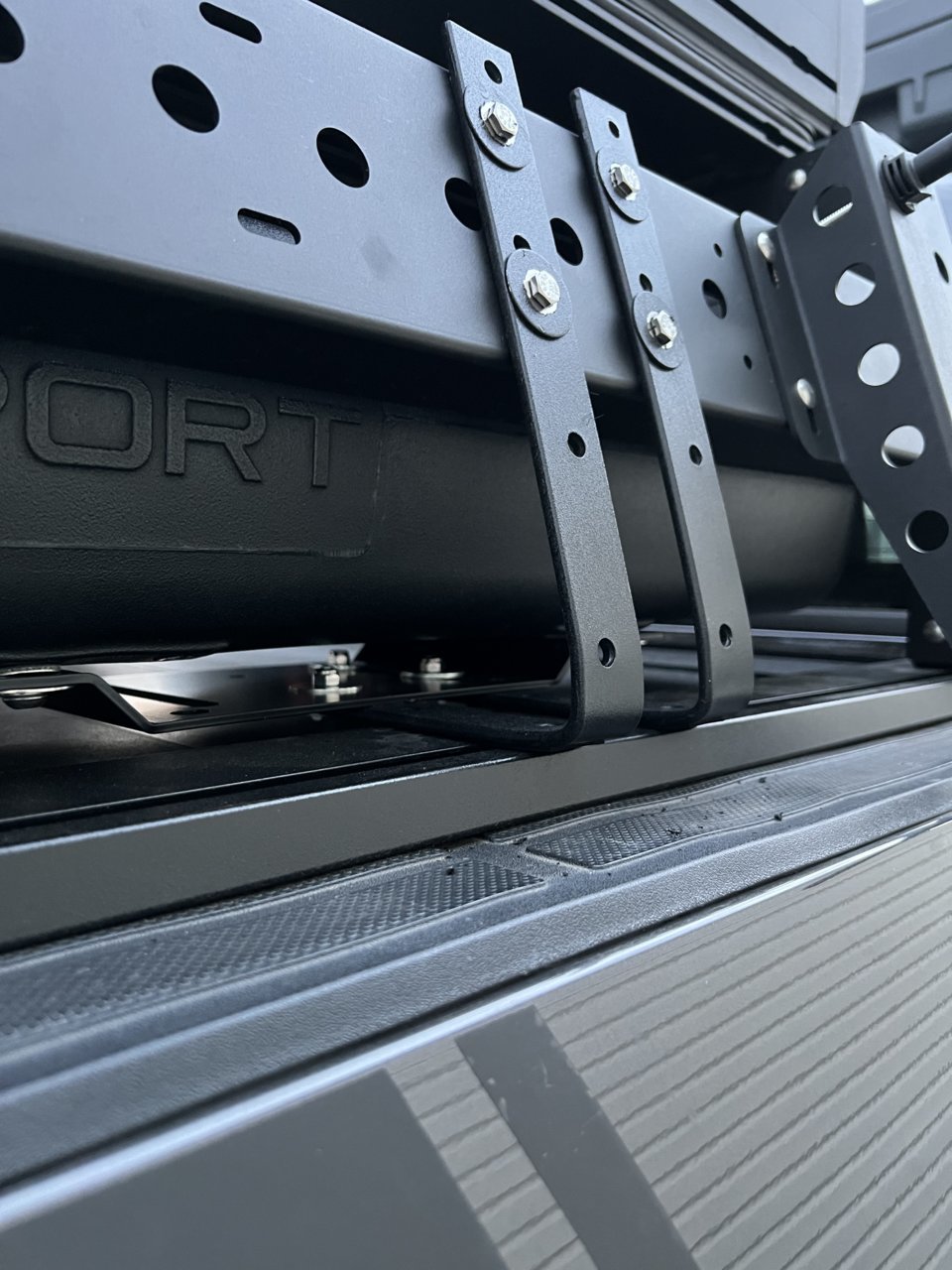

    I know I mentioned earlier that I was going to put the large Waterport inside the bed, but after I attached the water hookup valve, it ended up being too long to fit inside the bed. So, I ended up fabricating some “V” brackets and attached it inside the bed rack right above the tonneau cover. Worked out quite well.

    I have the same rack and would like to see how you made the "V" brackets what is the orientation to the maxtraxs brackets

    Actually quite simple. I bought 4 elbow brackets (10”) from Lowes and bent each one to the correct “V” angle.
    https://www.lowes.com/pd/ReliaBilt-RB-10-IN-ZINC-CORNER-BRACE/5001634759
    Then used 1/4” x 3/4” bolts and flat washers to attach to the outside of the bed rack side plate. The bed cap, or the top of the Retrax tonneau side rail in my case, provides the underlying support.
