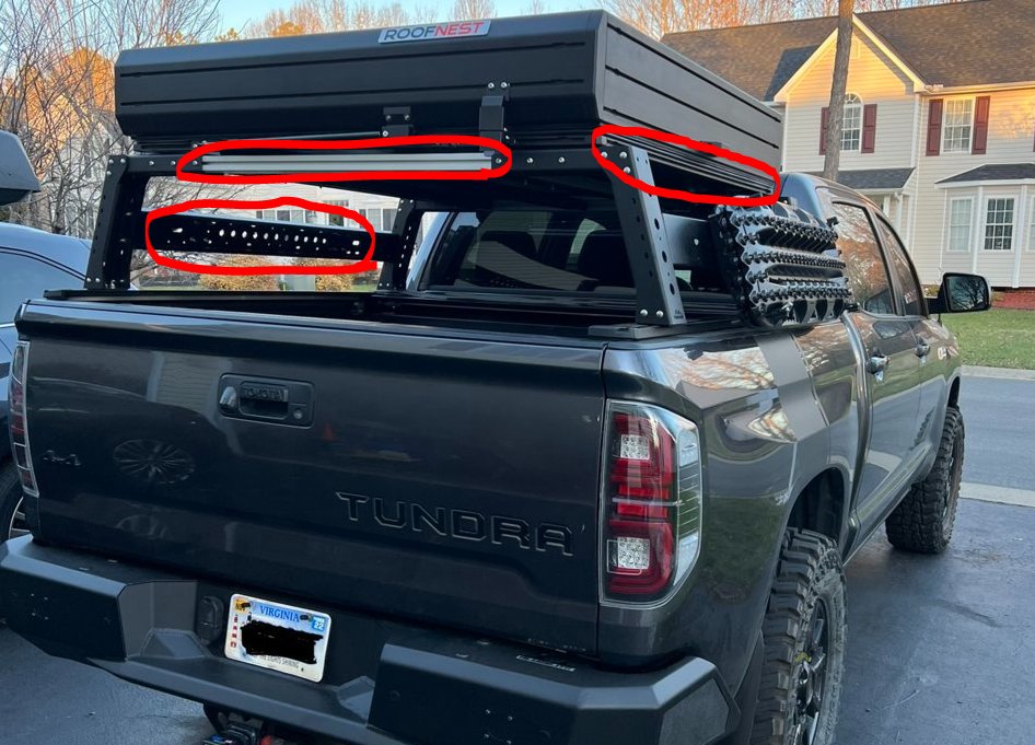

    On the note of current set up solutions, do you have any fab skills, or know any fabricators that could possibly make you a bracket? The reason I ask is because I see a couple possible options for the waterport/box mounts.
    The circled channel to on the bottom of the tent runs on all 4 sides of the lower tent frame. Front and rear have the gas struts mounted to them, and the passenger side is fairly inaccessible when the tent is folded out, BUT the driver side only has the tent hinges on it. If you had a set of brackets fabricated to go on either side of the tent hinges in that track you could possibly mount your waterport there. You'd have to have the brackets hang down a bit to clear the tent where it opens, but it might be possible. You might even be able to use the middle or upper track on the driver side of the tent to mount the waterport so long as it could rotate with the lid without impeding the full opening of the tent. It wouldn't be putting as much strain on anything being that close to the hinge point.
    Next, let's talk about the lowest oval in the picture. That side rail might be able to be used to mount something on the inside if you put a block or bracket between the outside and inside edge for support. You could possibly mount the waterport or one of the gear boxes under the rack in the bed like this, and being behind the driver side toward the front you could have a minimal impact on visibility.
    Finally, the silver track in your bed rack. (Pardon the rhyme.) Again, with a bit of a drop down bracket to keep from interfering with the strut and latch above, you could hang the waterport there. The downside would be loss of rearview mirror visibility, but plenty of drivers do fine with only side mirrors.
    Another thought that I didn't plan for in the pic, if you don't mind a bit of set up/tear down time you could possibly put some kind of mount in any of the tent rails with a quick detach mount of some kind. Mount it up, drive to camp, pop it off, deploy the tent, enjoy camp for days, pack up the tent, pop stuff back on the tent and secure it, and then motor on home. Just thoughts here.
    Wallygator likes this.

    Theae are all good suggestions. Can’t tell from the pic but the driver side of the bed rack is where my Rotopax tanks are mounted. I have 2 water packs (serious coffee drinker), 2 diesel packs (heater) and 2 gas packs. While I don't really need the gas packs for east of the Mississippi River for gas stations are plenty but could use them when I head out to the mid-west for just in case scenarios.
    Continuing on you suggestions. I could fab a couple of “V” brackets and potentially mount the Waterport on the inside of the driver side rack above the tonneau. It would then be positioned behind the driver side head rests and not block rear view mirror vision. It’s important that I don’t block rear view mirror because my Son and/or daughter will be accompanying me and they are younger drivers with not a lot of experience driving my mega size truck. So when they give me a break in driving, it will be easier for them to see out the back window.
    I’m glad I’m discussing this back and forth with everyone because it’s allowing me to see beyond any tunnel vision caused by the “I want” syndrome. While I really like the Spider roof rack, I just realized that the crossbars are 54” on the spider and the width of the Red Rail is 56”. So the Red Tail tent would overhang the side rails of the Spider rack which is not a good thing. The more I think about it, this Red Tail is massive on top of having to use the kids inheritance to pay for it:rofl:
    So if I can get the Waterport under the rack, this leaves the 2 Roam boxes. I see my options as:
    • Mount the Thule crossbars on the cab for the 2 Roam boxes. Easy solution and the cross bars do not require drilling or epoxy and can easily be removed in seconds with not truck alteration.
    • Mount a Spider no drill roof rack for the current setup and ditch the idea of the Red Tail RTT. This would lock me into a shorter RTT for the future but provides plenty of storage space.
