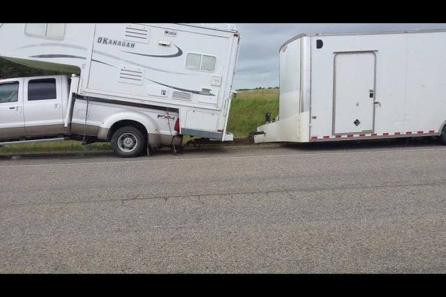

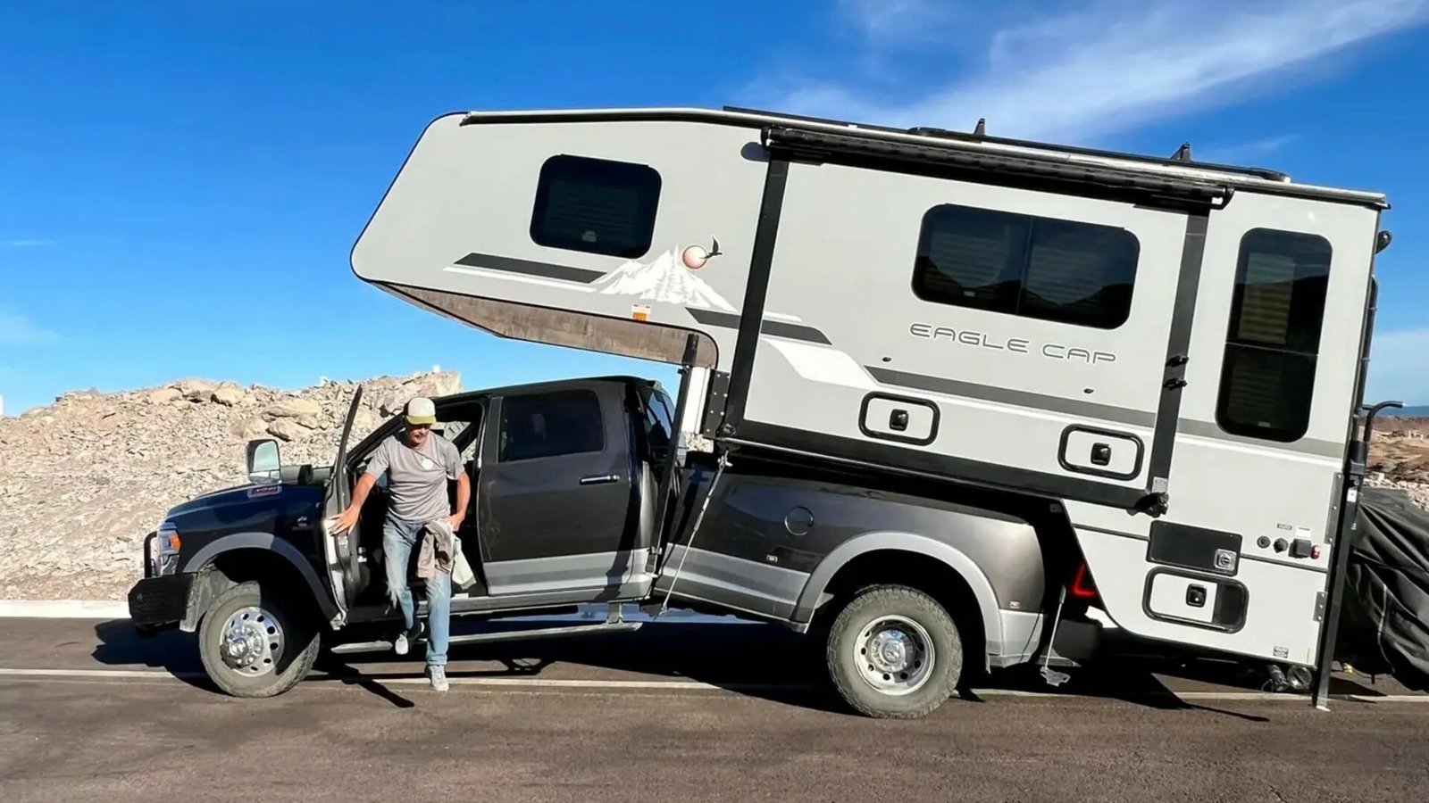

    Here is what can happen when you exceed the Truck's limits.

    I love these shots!
    Are we looking at poor welding skills or someone loading their HD dually with too much stuff? I can't imagine the payload of these beasts would be surpassed by a camper??
    I guess the actual weight of the campers wont be available.

    Some of those campers’ mass is hanging well off the back of the truck behind the rear axle. Cantilever’d out there, if you will. Not good, even if the total weight of the camper is within payload.
