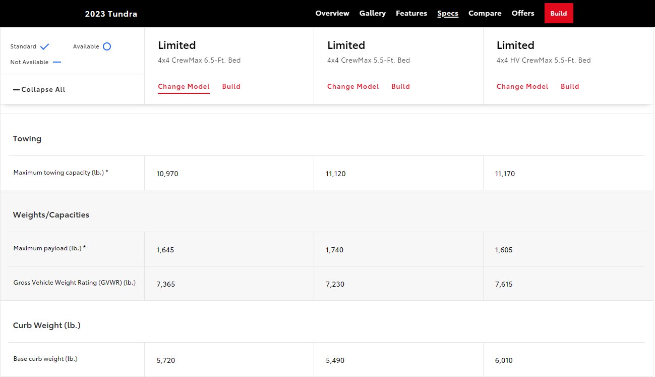

    Actually, I wouldn't go by the web site. It has been shown that those numbers for payload are bogus. Instead, go by the ratings in the manual, which have been shown to match the actual labels on the trucks. if you do then the HV is typically better in both compared to its gas only counterpart but depends on the model. I took the liberty of summarizing in chart form based on the 2023 manual.
    Payload capacity of all 2023 Tundra combinations
    Since the HV is only available in CrewMax and only down to Limited trim we can narrow the chart
    Similarly for towing. Here are all of them.
    Narrowed down
    In tabular form comparing the common specs directly we get:
    You can see that the majority of HV models have better tow ratings and a little less than half of the HV have better payload compared to their gasoline only twins. Based on this I think it is safe to say that the HV system gives no penalty in performance. To the contrary it is an improvement.
    Among the other aspects already stated, related to power and towing I would also say the added weight of the HV models helps towing as well. The heavier the tow vehicle relative to the item being towed the better and more stable the ride. So as others have said, I think for towing the HV makes sense and would be an advantage. Otherwise it is more subjective and dependent on what you want and what you intend to use it for.
    For me I have found the gas mileage to be fantastic. Of course I don't have a non HV to compare to directly but so far after 10,000 km (6,000 miles) I am averaging 12.3 L/100km (19.1 mpg) and this is based on the display, which I have found to be off. My direct calculation based on km driven and gasoline pumped I am actually at 11.8 L/100km (20 mpg). Compared to my 2020 5.7 this is more than a 50% improvement! Perhaps I would get similar with just the gas only model but I got the HV for towing.

    Thats because Toyota artificially limits the GVWR of the non-hybrid trucks by a good amount. If they just gave them all the same GVWR then we would see non-hybrids with 600 lbs more payload. It seems kind of silly to me that they do it that way.
