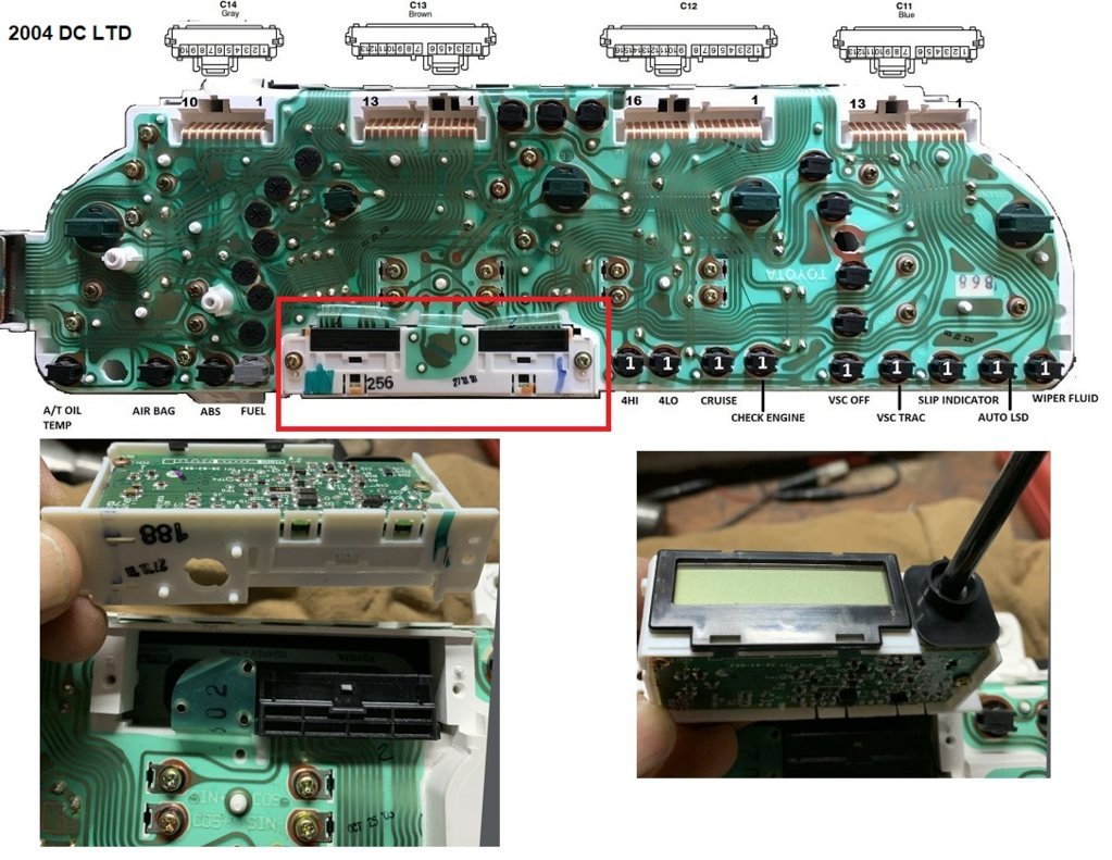

    Isn’t it the ECU that actually records the mileage? The odometer is just a display.

    Whats the ratio on that LSD, and how many miles??

    '06 AC Limited V8/4WD
    incorrect.

    Weight reduction, mostly rust.
    Wouldn't that give the correct reading on the cluster then?
    Which would make changing the cluster still read the correct mileage?
    Sorry, I meant incorrect, fixed. Brain is on another planet. Mileage is stored in the cluster. It's just a glorified logging machine.

    02 Tundra AC SR5 V8 4x4
    That’s seems to be what it would imply. If it’s stored in both places that would create a discrepancy.

    South Carolina
    2018 SR-5 CM 5.7, 2000 SR-5 AC 4.7L
    Mileage is stored in an EPROM on cluster. Changing the mileage is easy with a few basic electronics tools.

    North of Boston
    I most likely have them at work. Doesn’t it cause some kind of error since it doesn’t match what’s stored in the ECU or does it overwrite it? It doesn’t sound like a well thought out anti-tampering feature.

    KY
    01 Tundra V8 4X4 AC SR5 TRD
    Do our trucks even store the info in the ECU? It may just be whatever the cluster reads.

    North of Boston
    Some vehicles do. I have no idea if ours does that.

    04 DC LTD 4X4 4.7 V8
    T150 Lover
    As @bfunke mentioned, the actual mileage is stored in the combination meter(gauge cluster). Veh speed signal is inputed into the cluster.
    00-04 Tundras use the transmission analog speed signal(VSS).
    05-06 (vvti and 5 speed trans) Tundras use avg of wheel speed sent to ABS module which is translated into a digital signal for input to cluster.
    The 8 prong eeprom is contained on the CCA module below....from my 04 DC LTD.
