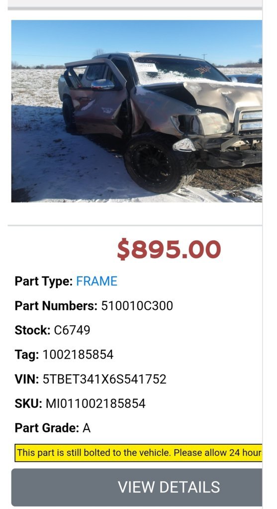

  5. Jan 24, 2025 at 6:50 AM
    29,526

    Go to https://www.car-part.com/, enter your year, truck, trim and drivetrain, pick a southern or southwestern zip code and cast a big net. I.e., don't limit yourself to a certain distance. I pulled up a few, but I am not sure what you mean by "crew cab" in your description. We use Regular Cab RC - seats 3 and has 2 doors; Access Cab AC - seats 5 or 6 with a tiny azz back seat and has 2 real and 2 suicide doors; Double Cab or DC - seats 5 or 6 with a real back seat and 4 real doors.
    NOTE: Car-part uses other nomenclature for the search, BUT individual junkyards will usually use the correct RC/AC/DC terms.

    29,526
    Did you check my link? It's not to far from you.
    Here is their main link, not the frame.
    https://www.cooksautoparts.com/
