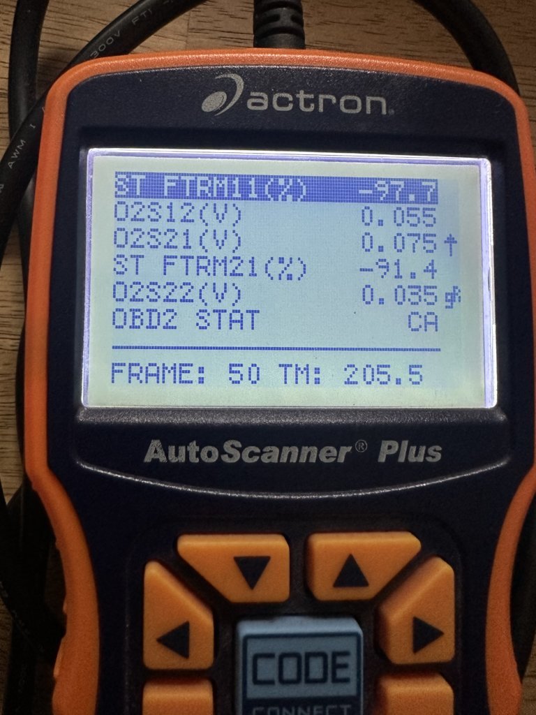

    My mileage is pretty crappy but I’ll be putting in my new O2 sensors tomorrow.
    Here’s an example of my short term fuel trim numbers which if I’m not mistaken should be between -10 to +10%. Instead, I’m seeing -98% to +30%. (I hope my injectors aren’t F’d up)
    I’ll post a graph of them all with the O2 voltages once I get this uploaded to Windows XP and the new ones installed.

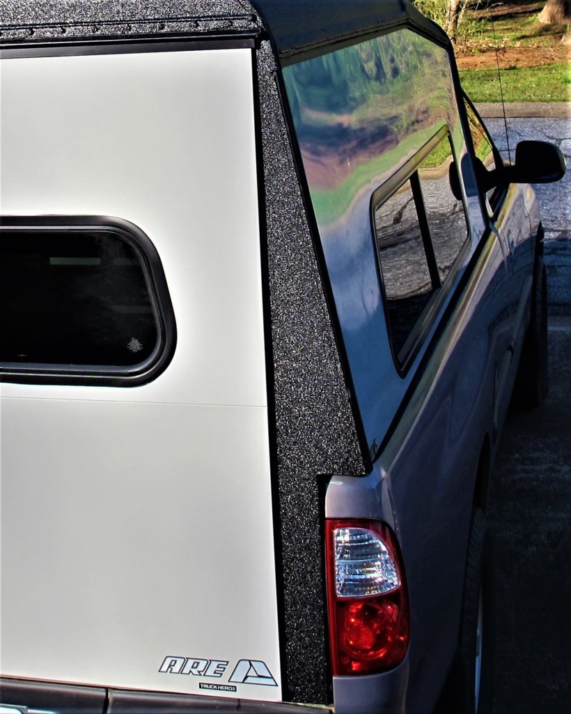

    Sweet camper, did you build that? :popcorn:

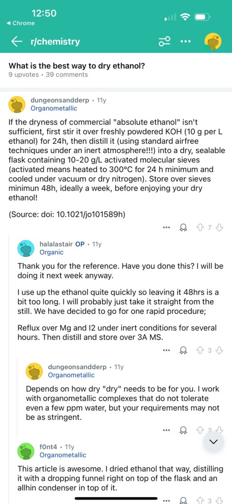

    i’ve been thinking about wash the ethanol out of gasoline 30 gallons at a time. Seems cheaper than buying the ethanol free. I’ll have to do the math when i get home.
    drying the ethanol enough to use for a rowdy minibike engine seems like a PITA though.

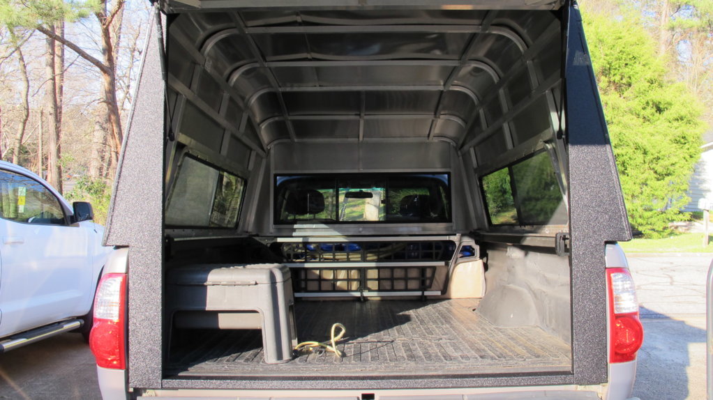

    I had A.R.E. build it for me.
    It's the tallest commercial DCU high wedge they make.

    Dang that's big boy
