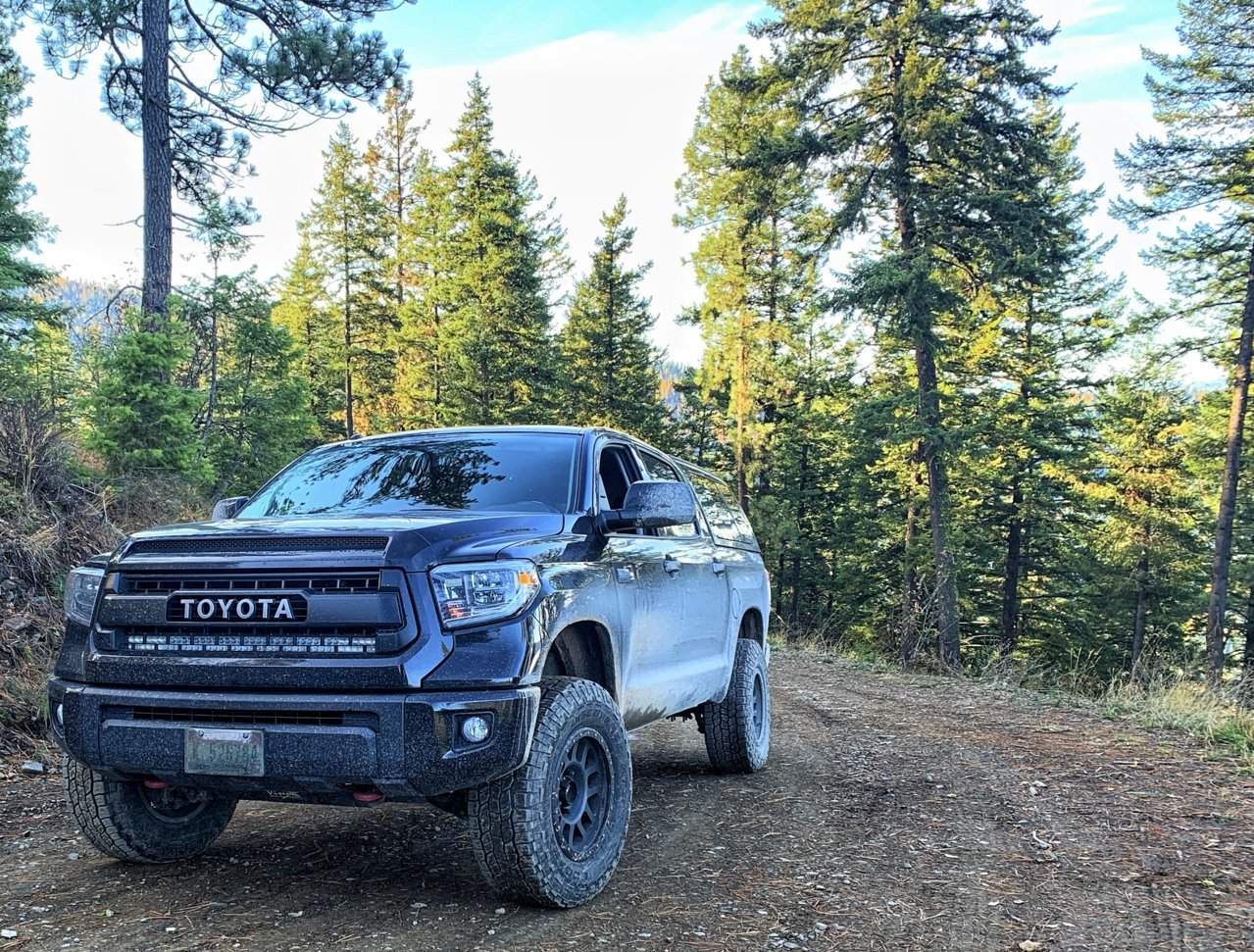

  21. Jan 27, 2020 at 7:35 AM
    xtyfighterx
    xtyfighterx New Member
    Aug 28, 2016
    #4360
    2,355
    Ty
    North Idaho
    2015 Black Crewmax Mid Travel
    Mid travel fox 2.5 coilovers 2.0 real shocks shims 295 70 18 trail grapplers pro accessories 32in light bar blacked out bed cover sway bar Moto metal 970 18x9
    295s and 0 offset
