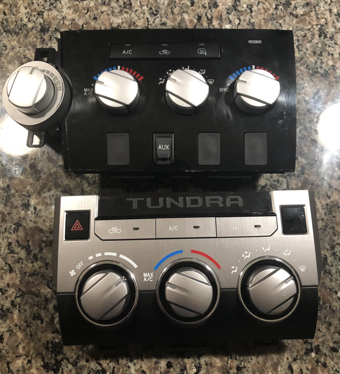

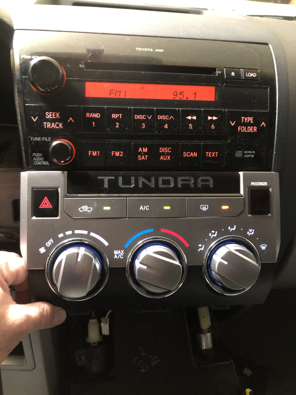

    Just finished wiring in the A/C controls. Everything works no problem, just need to move the wire to activate the hazard lights down from by the info buttons to the new AC controls. The 2014+ have the hazard button on the AC panel
    All lights, AC control knobs, buttons, airbag warnings work just like they should.
    The 2007-2013 Tundras have a 16 pin connector, while the 2014+ use an 8 pin connector to control the AC panel. I did the same crossover method, move the pins from the 16 pin connector to the 8 pin via an inline harness.
    EDIT: After playing it for a while I realized the temp adjustment knob was not actually working. When viewed in Techstream on the laptop I could see a temp adjustment setting for both Driver and Pass. The 2007 is dual zone with two temp adjustment knobs. HOWEVER, the 2014 is not dual zone and only has one center temp adjustment. As I turned the 2014 temp adjustment knob I realized nothing was registering in Techstream. Long story short I finally realized the solution was to swap out the AC amp. I had the one from my 2017 front clip laying in my garage. I plugged it in and boom fixed. Techsteam sees the new AC amp and now it only shows one temp adjustment(Driver, the Pass is no longer displayed) which full registers as I move the new knob.
    If you are going to do this swap you need to buy a new AC Amplifier as well or else you will not be able to adjust the air temp. To bad Toyota did away with dual zone AC in 2014+
    I will post the Part #s of the AC amps Old and New

    Not yet but to me the two biggest hurdles are cleared, the insturment cluster and AC both work. From here is just the radio ( might just go aftermarket), the steering wheel, and all the buttons/switches. All the buttons and switches seems to be the same except the new ones light up blue instead of orange.
    Working on buying a full 2014+ dash panel and center console. With that installed the interior swap will be over halfway completed

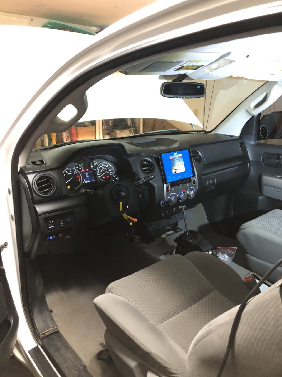

    So the cluster and AC controls are mounted. Also this is a teaser photo of what is coming.
