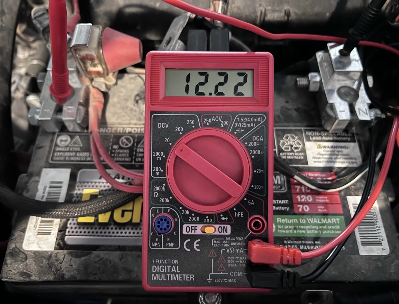

    Checked this morning, has not been driven or started since last time I checked it.
    Draw -
    Battery voltage - 2 weeks since last charge(charge every 2 weeks), starts fine though.

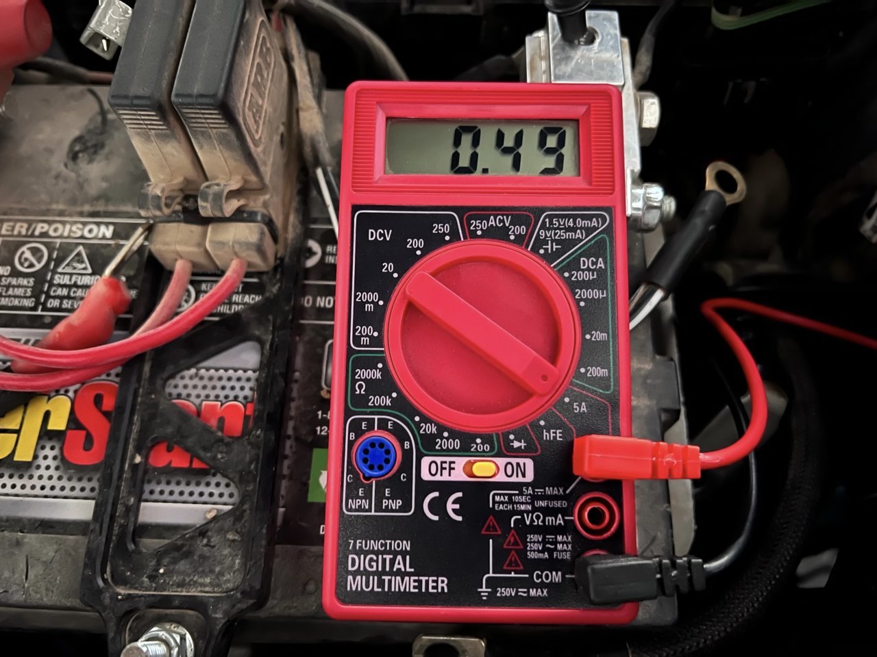

    Thanks guys! You and the site diagrams have been a tremendous help! I can not believe it took this long! I had my daughter reading my amp meter the first time i ram thru the exercise 3 days ago!
    It is the ECU-DDC-2 that's drawing the .5 amp. (normal current draw! Crazy amount of power!
    If one removes either the - under the hood fuse box Short, or removes the under the hood "20 am ECU, or removes the inside fuse labeled ECU-DDC 2 this drops all of the parasitic current .5 amps.

    I checked my neighbors 2017. Only .1 amp AFTER the door is closed and the dome light times out. Door open? .5 amps
    Taking it into the Toyota shop tomorrow in Prescott. Hopefully they can connect to the ECU-DDC and see the device on the unit that is drawing the excess current.

    No, why would I test with dome light on? Didn’t bother setting the hood latch though. Battery disconnected and hood open for the 3 days between tests, nothing on other than hood open, same .5v draw every time checked.
    As previously mentioned, there are many changes to the 2018 vs. 2017, enough so that comparing is likely pointless.
