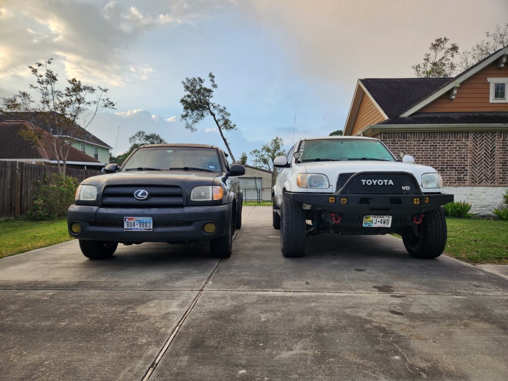

    Nah my 4x4 has an e-locker. It's great for that truck's needs.
    But my 2wd street queen had the OEM LSD and now has the TrueTrac. I just should've bought the right LSD for me. I thought I did tons of research, but somehow missed the fact the TT will never lock both wheels and that's just not what I wanted.
