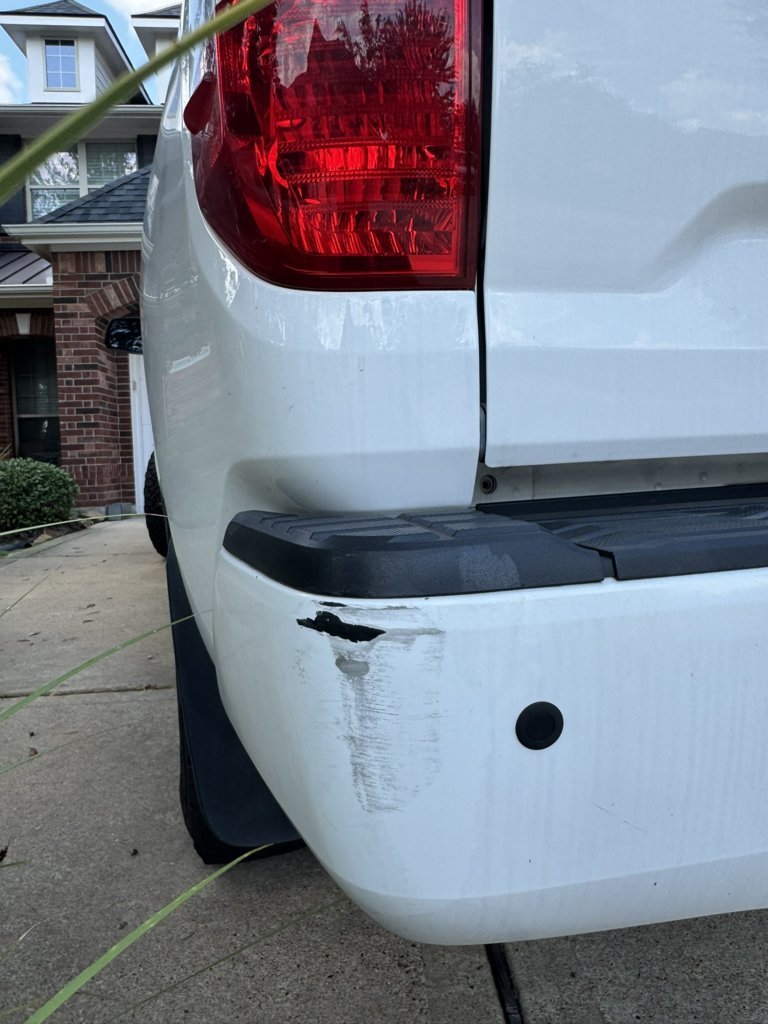

    I always mind my own business and I always park the FOCK away from everyone and I still get hit in the parking lot. Unfocking believable and of course nobody left a note or anything.
    Can this rear corner be replaced with the right color match part or do I need to repaint it? What part number will this be ?

    You should be able to replace it. I think it’s called bumper cap or bumper shell. Not sure.

    Yes you can replace the just the left rear corner.

    a quick wipe with a rag saturated with lacquer thinner will quickly remove all that paint transfer.

    Yeah but his situation looks more in depth than that

    Ugh! Bums! Color number 040. Super White. I'd try painting it first, If you don't like the results, you're not out much money. Also not real sure you can find it prepainted. Most parts are bare plastic in a gray color or black and need primer and paint.
    Part #52159-0C904

    It’s a bumper end. You can fix it your self and paint with a can of the matching spray paint from any of several sources. Don’t sweat the small shit…

    I think is just a one piece cover? Looks like one piece? The paint is wiped so it needs to repainted or replaced.

    It is one piece if I remember correctly. Sand, prep, tape off, aerosol can the paint match, then do a coat of clear. Might cost you 125.00.

    In any case, I'd just fill it, sand it, paint it.

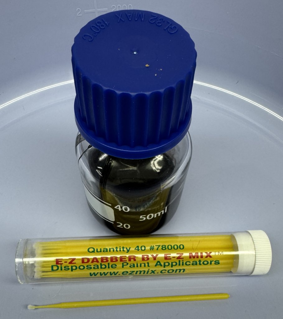

    I'm with ColoradoTJ, go to a paint shop and have them make a can of spray paint that has BOTH the paint color and clear coat in it (instead of 1 can for paint and 1 of clear coat). You'll be very surprised how well it will come out. And to top it off you'll have a little left over from the paint can that you can use as touch up paint. Pour the remainder into a 50mL Reagent Glass Media Chemical Bottle to use at a later time. Pick up some disposable paint applicators while you're there as those are 10X better than using a Toyota touch up paint bottle/brush.

    I measured both sides and the bumper wasn’t pushed. Is plastic, just got badly shaved.
