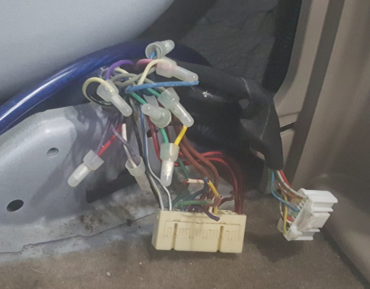

    You are correct. Hack job everywhere. I was already planning on bypassing the amp, but they already did. My original plan was to update the head unit and add a small sub. But after seeing the quality of what's been done, I'm ripping everything out and rewiring a whole new stereo.

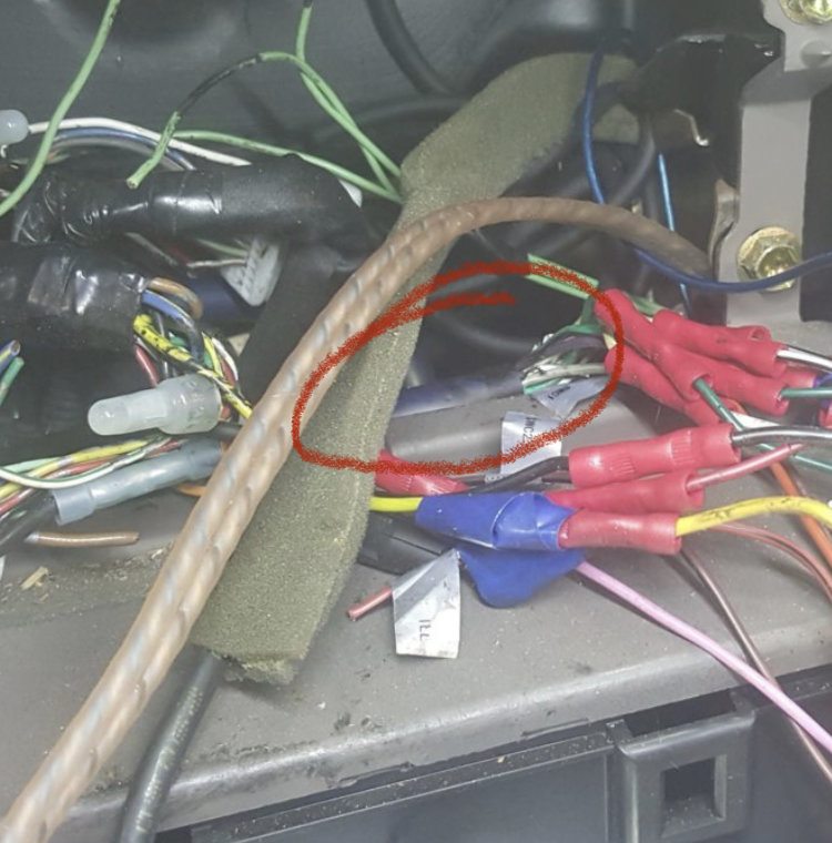

    Ah...this just looks like a shitty job done by a stereo shop, the reason I’m saying that is because they used a 9 wire to bypass the amp and not a lot of amateur stereo enthusiasts know what it is. They didn’t use the proper bypass harness because not all stereo shops have it in stock and when customer wants something same day, you improvise.
    what you want to do is leave the harness in the 2nd picture alone where it’s connected to that wide yellowish plug. From what I can tell in your photos, they tapped on to the right wires. What you want to do is tap onto what I have circled in the photo color for color. Those are speaker wires that are ran past the factory amp and tied into factory wiring (at that wide yellow plug) so the installed didn’t have to run new wires through door boots to each speaker. That will leave you with constant power (yellow) switched power (red) and ground (black) from your new stereo to be able to tap onto how the previous person did it. Most likely you’ll have a couple of extra wires coming from the new stereo depending on features. It looks like there was a screen there since I see lime green wire which is usually the parking brake.
