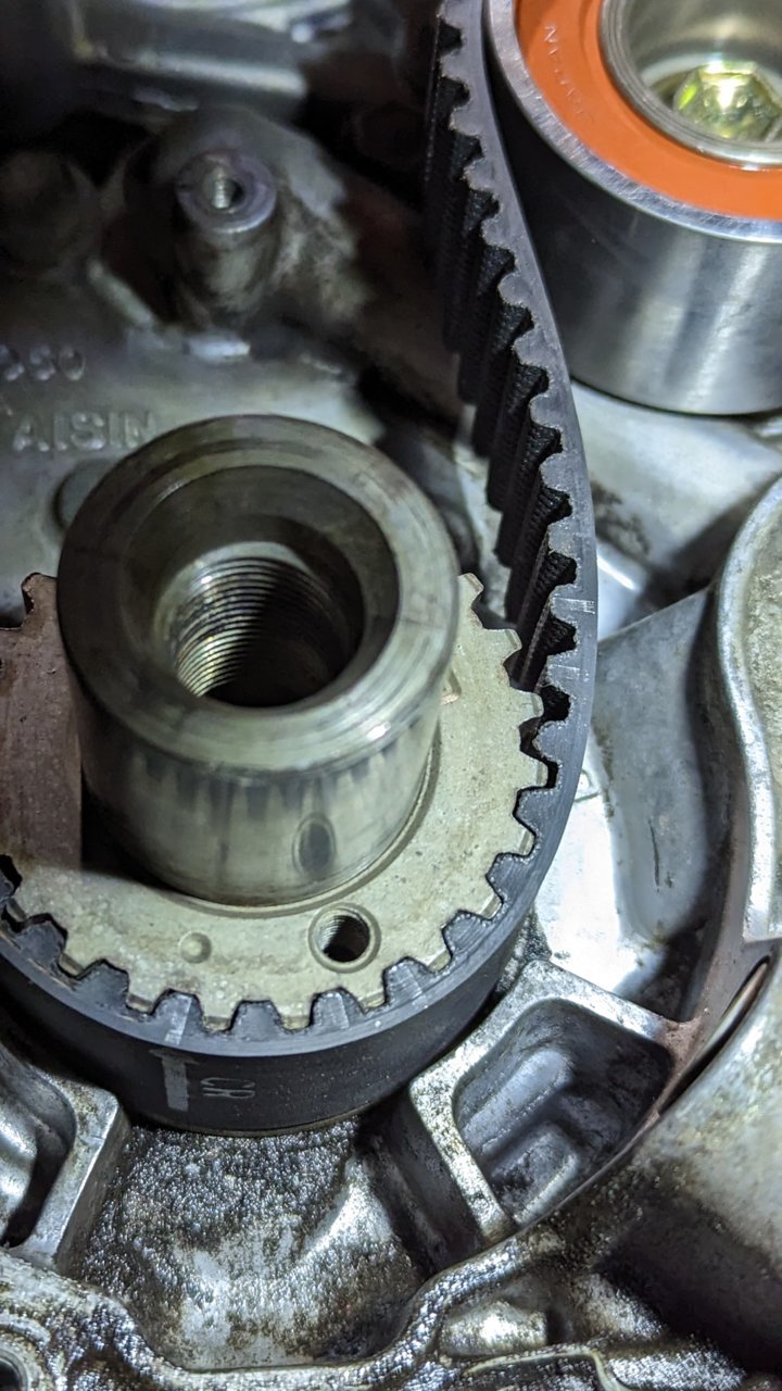

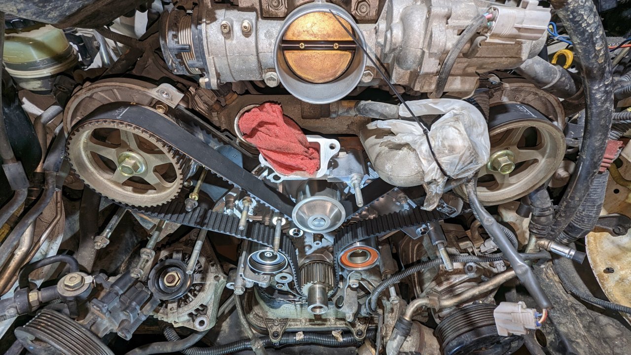

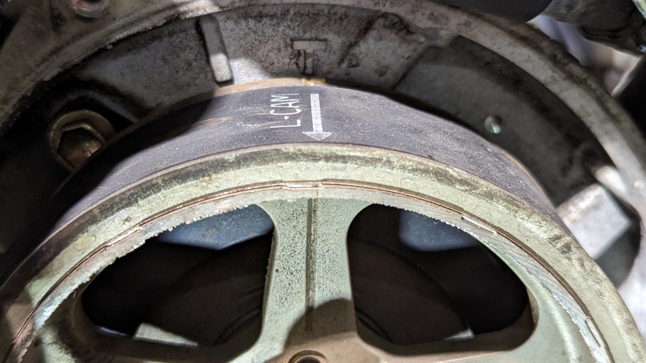

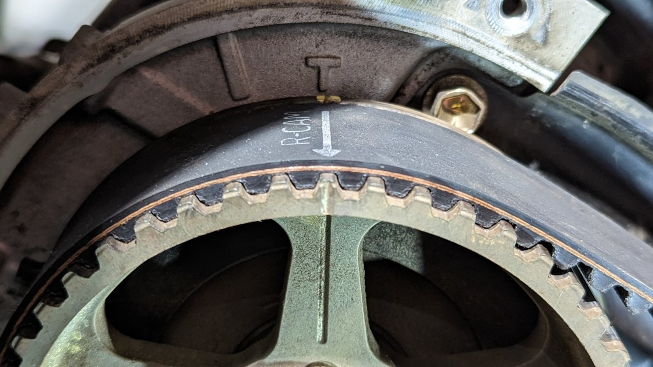

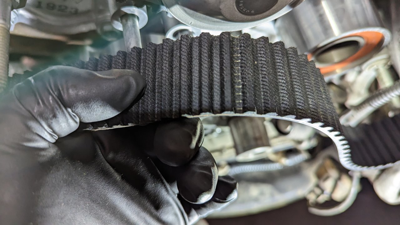

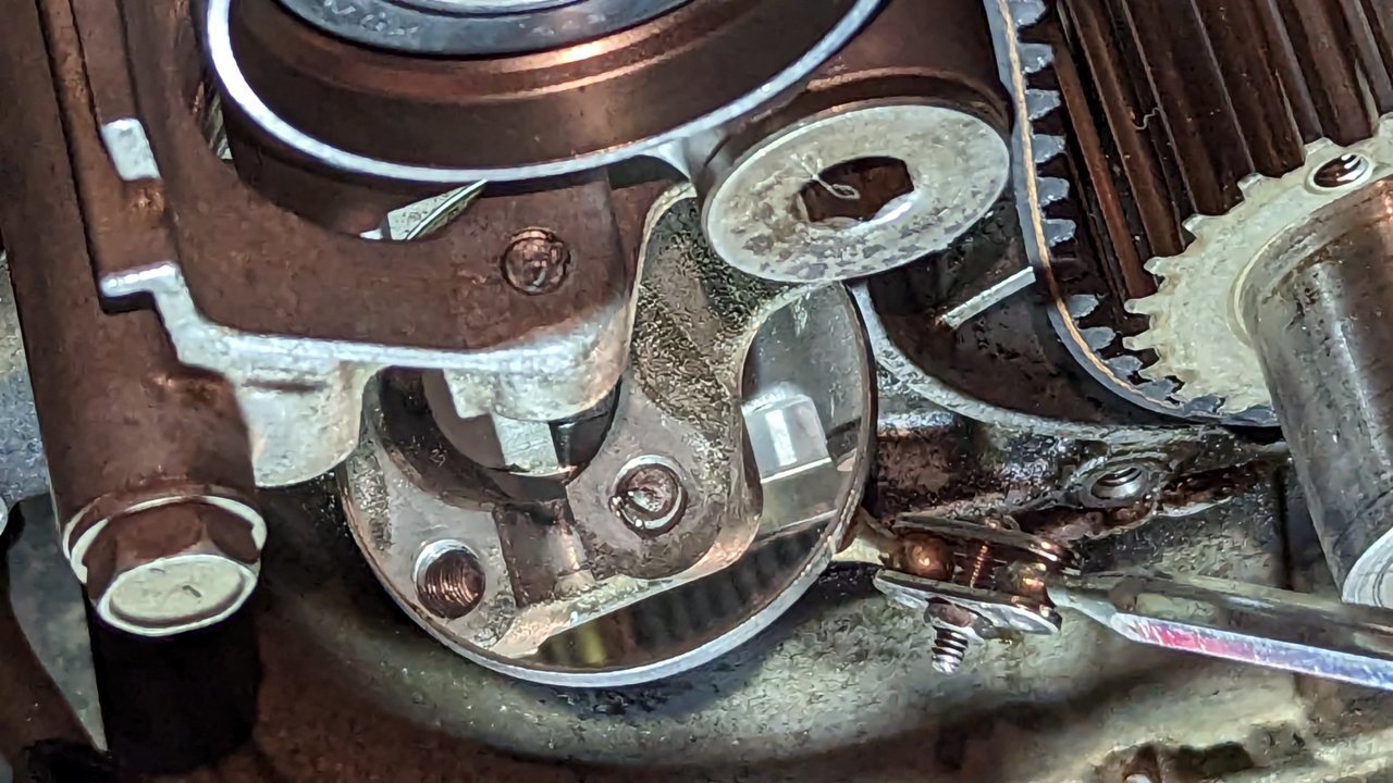

    Okay making some progress. Sadly I screwed up the torque specs for the timing belt tensioner belt and a snapped a bolt in the through hole side. I also discovered that there was only one bolt in my tensioner bracket instead of 2. Found one slightly shorter than the original that seems to work. The bolt in snapped was the original I do have another. Being 4 threads shorter than the original think would cause an issue?
    Aside from that I'm posting some photos of the position of my belt.
    I did notice one odd part of the new belt where the metal wires in it are exposed in 1 valley between the teeth. The belt is the Aisin kit Mitsuboshi belt.
    • First photo is with an inspection mirror of bottom and top of the broken bolt.
    • Second picture is the exposed metal threads of the new belt. Is this normal? Or is this something I should be concerned about?
    • Third photo is the routing path of the timing belt. Does this look right?
    • Forth is the belt position on the crank pulley. I believe this is the correct marking.
    • Fifth photo is position on the passenger side cam pulley. Does this look correct?
    • Sixth photo is position on driver side came pulley. Does this look right?
    Figured I'd post here before setting up and pulling the tension pin (after I figure out how to remove the broken bolt). Any input is appreciated.

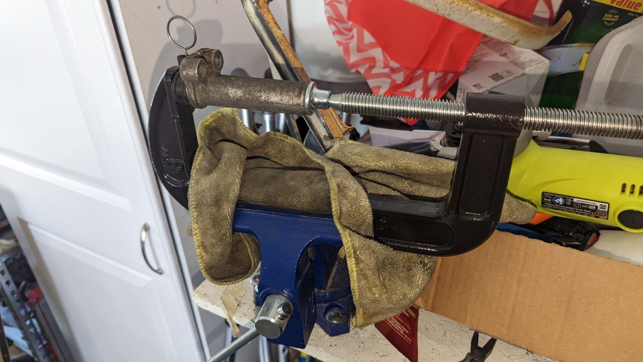

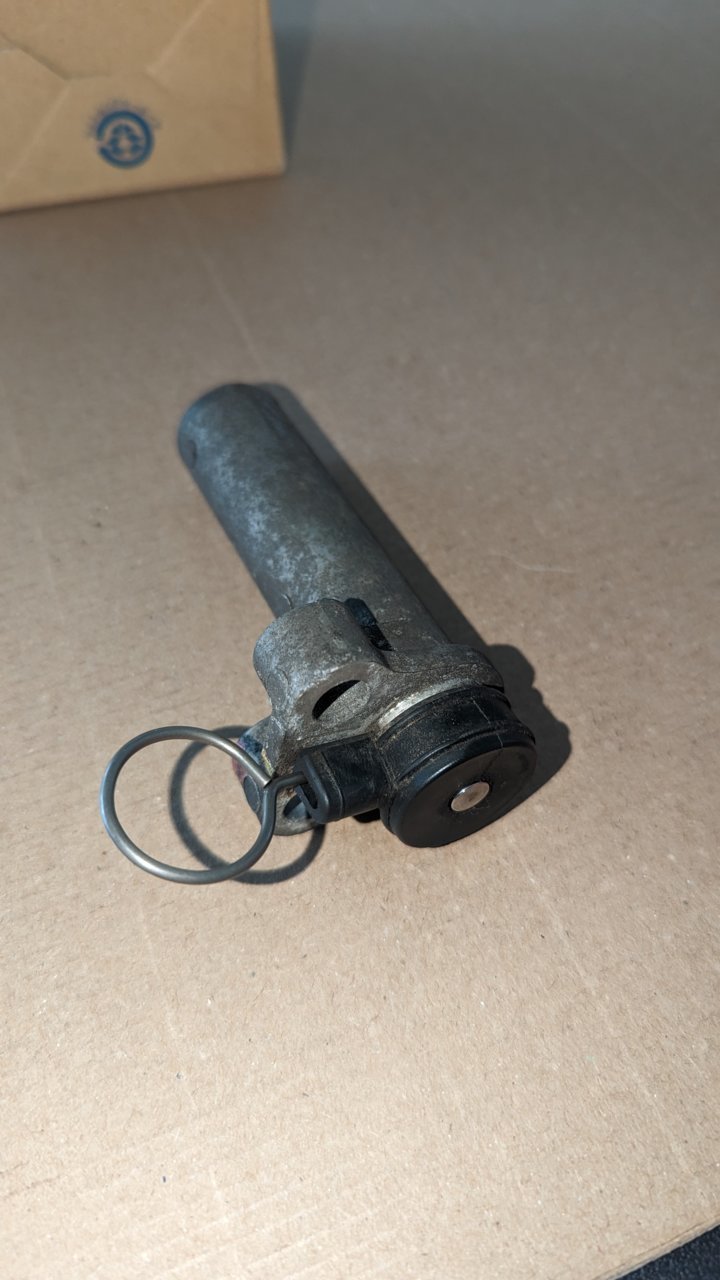

    Truck is coming along almost have her back together... Throwing this out here for those who may need to reuse their timing belt tensioner. I replaced mine as new came with the kit however old one seemed to work fine.
    My vice jaw doesn't open enough however I did have this larger c clamp I once used to break the bead of my motorcycle tire. I put it in the vice but that part is not necessary. Large enough c clamps works like a charm.
    P.S. I did get the broken bolt out pretty easily Luckily.

    She's alive... After replacing the belt the truck fired up first try! It wasnt on for long because I haven't reinstalled the fan yet and no coolant. During the short time the car was on I did not hear any weird noise from the engine. No knocking or anything odd. Obd2 didn't detect any fault codes.
    Tomorrow will be coolant and fan and she should be good to go in hoping. Following that I'll replace the spark plugs and oil.
    In short broken belt while ideling or crawling along in parking lot (I wasn't driving) and so far seems as though no damage to the interference engine in my 2001 tundra.
